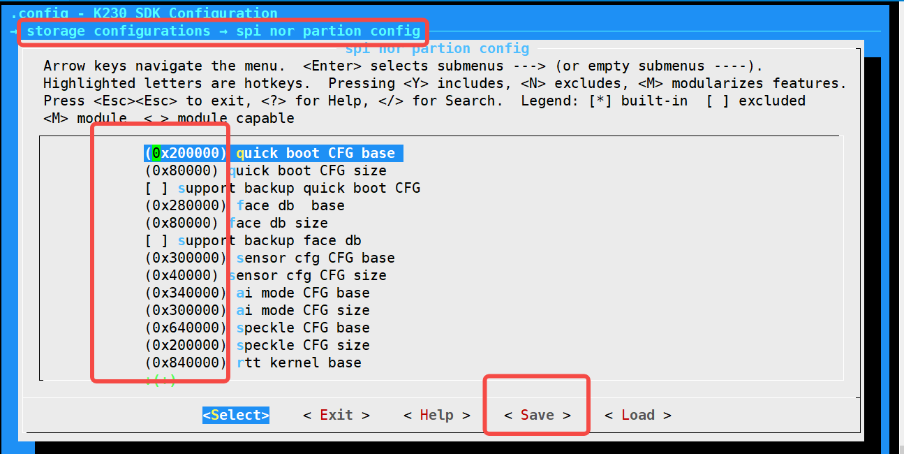

In the SDK main directory, execute make menuconfig —> storage configurations —> spi nor partition config to modify the partition (interface shown below). After modification, execute make build-image.
Detailed implementation of partition modification through menuconfig:
After configuring with make menuconfig, a .config file is generated (partial content shown below):
The tools/menuconfig_to_code.sh script will dynamically modify the Linux device tree and board/common/gen_image_cfg/genimage-spinor.cfg file based on these definitions (key script shown below):

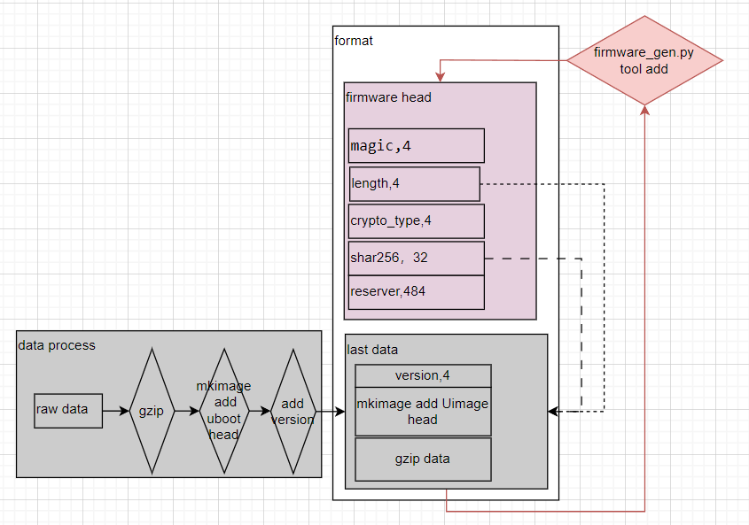

Partition Data Format and Generation Process#
Currently, the data in parameter partitions such as quick boot parameters, facial features, calibration parameters, AI models, speckle, RTT, and RTApp are not encrypted. The format and generation process are as follows:
The main generation script is as follows:
# For more detailed generation details, please read the gen_cfg_part_bin function in the board/common/gen_image_script/gen_image_comm_func.sh script
${k230_gzip} -f -k ${filename} # gzip
sed -i -e "1s/\x08/\x09/" ${filename}.gz
# add uboot head
${mkimage} -A riscv -O linux -T firmware -C gzip -a ${add} -e ${add} -n ${name} -d ${filename}.gz ${filename}.gzu;
python3 ${firmware_gen} -i ${filename}.gzu -o fh_${filename} ${arg}; # add k230 firmware head
The corresponding execution process prints as follows:
## Image Name: speckle
## Created: Wed Jul 5 15:37:49 2023
## Image Type: RISC-V Linux Firmware (gzip compressed)
## Data Size: 45 Bytes = 0.04 KiB = 0.00 MiB
## Load Address: 14040000
## Entry Point: 14040000
## the magic is: b'K230'
## the encryption type: 0
## mesg_hash: b'3543e2038aedad88a29f8ee98983064367cc79f6e709ed7571df9b391884b8b1'
When U-Boot starts, it will parse and verify the parameter partitions (quick boot parameters, facial features, calibration parameters, AI models, speckle, RTT, RTApp) data and load the parsed raw data into the correct memory locations.

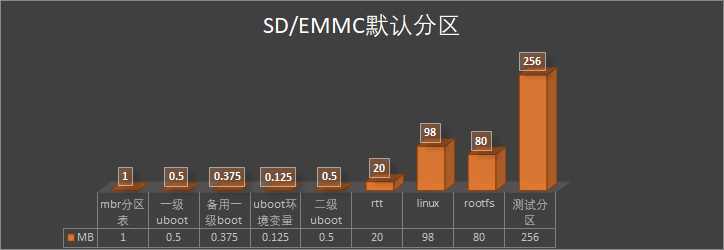

Default SD and eMMC Partitions#
SD/eMMC Default Partitions |
Content |
Start Addr |
Size |
Size MB |
Size |
MBR Partition Table |
0x0 |
0x100000 |
1 |
1MB |
Primary U-Boot |
0x100000 |
0x80000 |
0.5 |
512KB |
Backup Primary Boot |
0x180000 |
0x60000 |
0.375 |
384KB |
U-Boot Environment Vars |
0x1e0000 |
0x20000 |
0.125 |
128KB |
Secondary U-Boot |
0x200000 |
0x800000 |
0.5 |
8MB |
RTT |
0xa00000 |
0x1400000 |
20 |
20MB |
Linux |
0x1e00000 |
0x6200000 |
98 |
98MB |
Rootfs |
0x8000000 |
0x5000000 |
80 |
80MB |
Test Partition |
0xd000000 |
0x10000000 |
256 |
256MB |

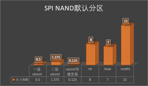

Default SPI NAND Partitions#
SPI NAND Partitions |
Content |
Start Addr |
Size |
Start Addr |
Size MB |
Size |
Primary U-Boot |
0x0 |
512KB |
0x0 |
0.5 |
512KB |
Secondary U-Boot |
0x80000 |
0x160000 |
0x80000 |
1.375 |
1.375MB |
0x1e0000 |
128KB |
0x1e0000 |
0.125 |
128KB |
RTT |
0x200000 |
0x800000 |
0x200000 |
8 |
8MB |
Linux |
0xa00000 |
0x700000 |
0xa00000 |
7 |
7MB |
Rootfs |
0x1100000 |
0xf00000 |
0x1100000 |
15 |
15MB |

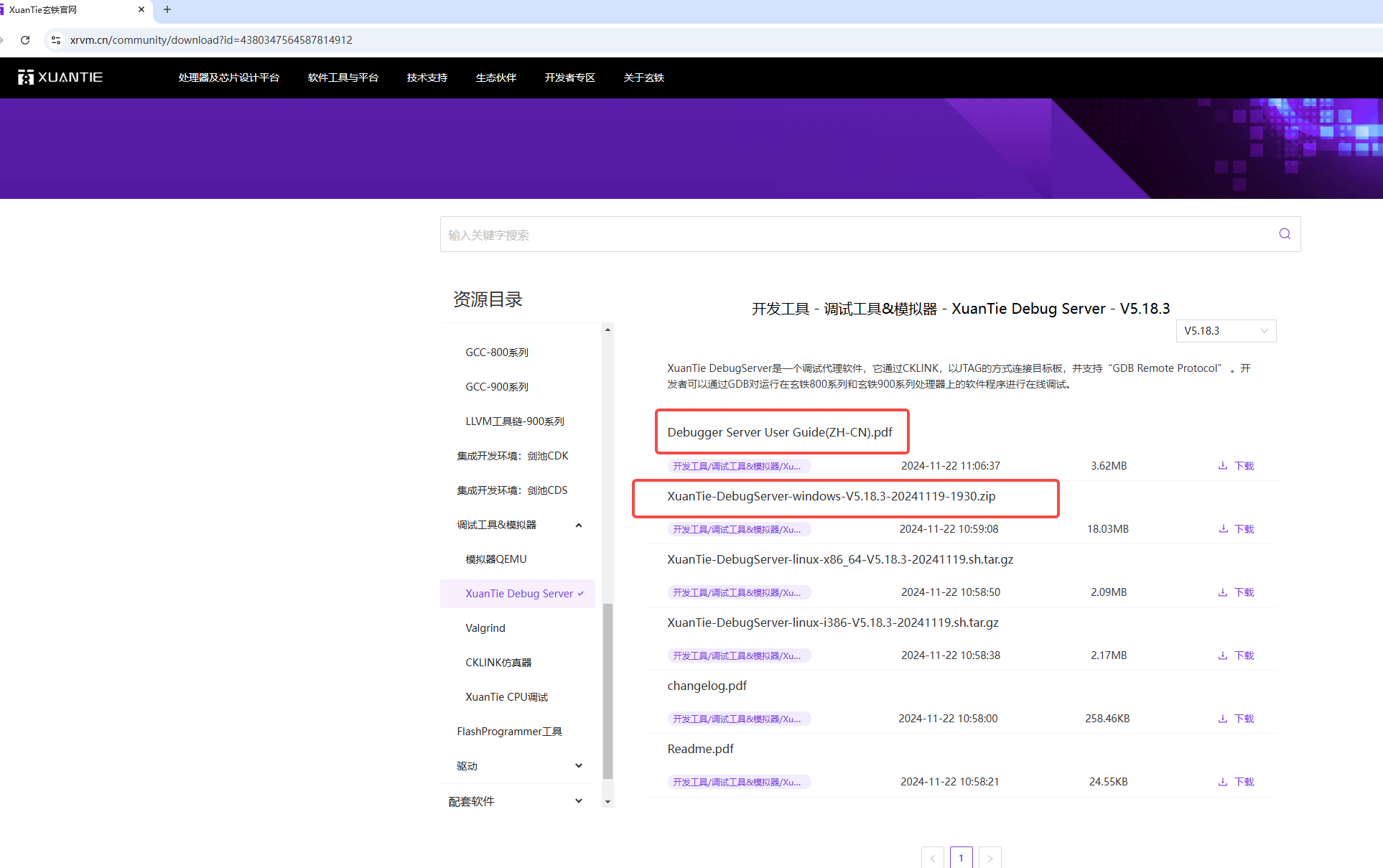

Download the
T-Head-DebugServersoftware and the “DebugServer User Guide v5.6” from T-Head’s OCC platformhttps://occ.t-head.cn/community/download, and install theT-Head-DebugServersoftware on your PC following the “DebugServer User Guide v5.6”.
