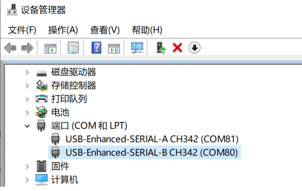

The CanMV-K230 comes with a CH342 USB to serial chip. The driver download address is https://www.wch.cn/downloads/CH343SER_EXE.html.
View the serial port number
Two serial ports are displayed here: COM80 for the small core Linux debug serial port, and COM81 for the large core rt-smart debug serial port.

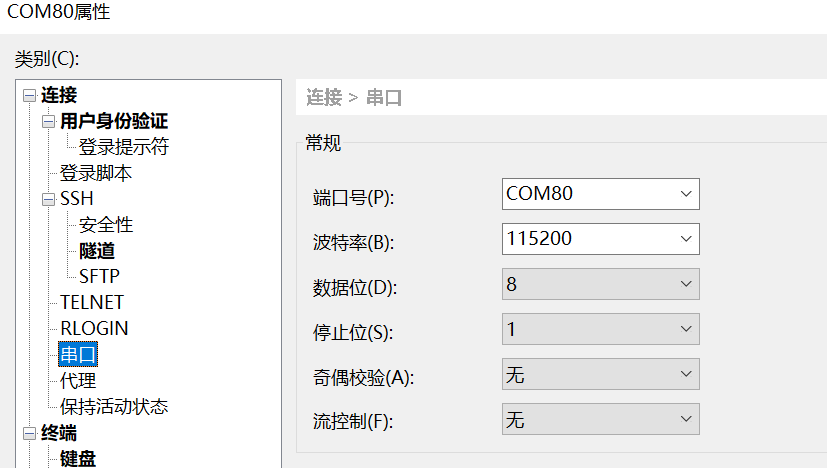

Configure serial port information
Open the Xshell tool (or other serial port tools).
Select the port number displayed in the Device Manager
Baud rate: 115200
Data bits: 8
Stop bits: 1
Parity: None
Flow control: None
