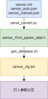

The production flowchart is as follows:
Figure 2-1 Parameter Partition Production Flowchart
The production steps are as follows:

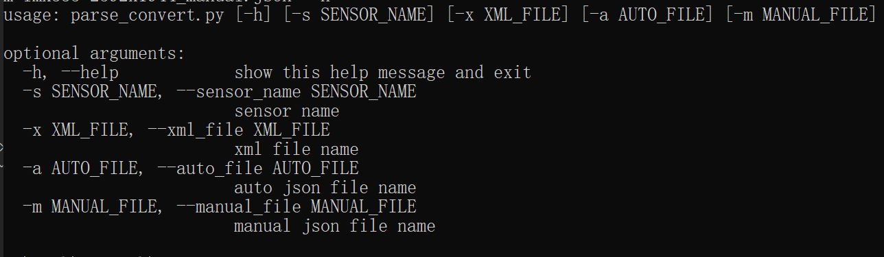

Execute the conversion header file tool parse_convert.py, parse and convert the three copied configuration files into a parameter header file (it is recommended to use python3.x for the conversion tool)

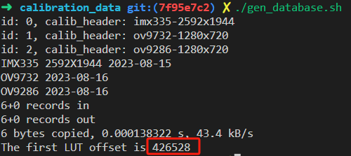

Figure 2-2 Parameter Partition Automatically Calculates Dewarp Offset

1,
/* lut_offset */
CONFIG_MEM_SENSOR_CFG_BASE + 426528, // 426528 is calculated by the script
