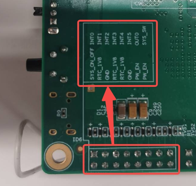

When using a PMU, you need to set up the EVB board as follows
Use the jumper cap to connect PIN13(OUT0) and PIN14(PW_EN) of the J1 interface, taking care to disconnect PIN15(SYS_SW) and PIN16(PW_EN)
Depending on the different wake-up source, PIN2 (SYS_ON_OFF) is connected to the corresponding PIN using a jumper, and the button K1 can control the state of INT, press the button to go high, and release it to low
