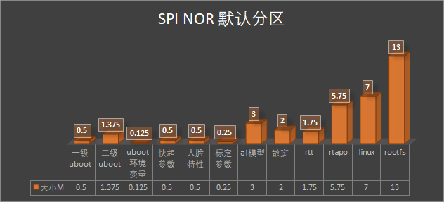

6.1 SPI NOR#
6.1.1 Default SPI NOR Partition#
image-spi_nor_default_part
SPI NOR Partition
Content
Start Addr
Size
Size MB
Size
Primary U-Boot
0x0
512KB
0.5
512KB
Secondary U-Boot
0x80000
0x160000
1.375
1.375MB
U-Boot Env Vars
0x1e0000
128KB
0.125
128KB
Quick Boot Params
0x200000
512KB
0.5
512KB
Face Features
0x280000
512kB
0.5
512kB
Calibration Params
0x300000
256KB
0.25
256KB
AI Model
0x340000
3MB
3
3MB
Speckle
0x640000
2MB
2
2MB
RT-Thread
0x840000
0x1c0000
1.75
1.75MB
RT-Thread App
0xa00000
0x5c0000
5.75
3.75MB
Linux
0xfc0000
0x700000
7
7MB
Rootfs
0x16c0000
0xb00000
13
13MB

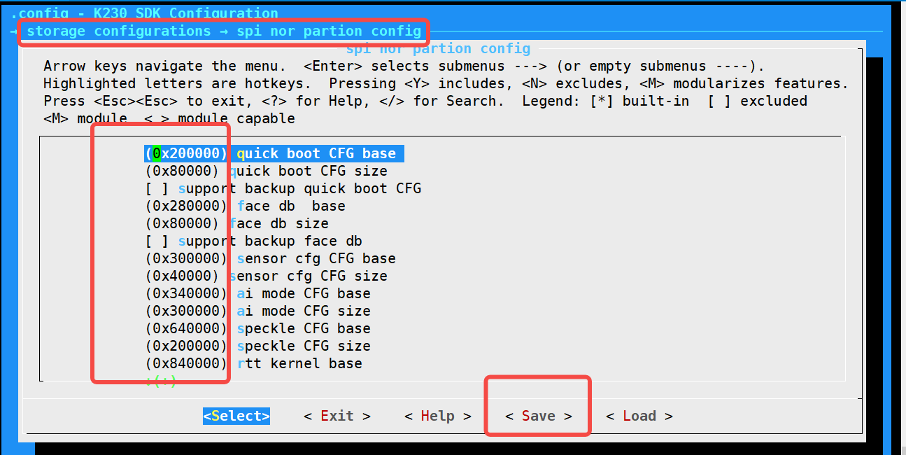

6.1.2 Partition Modification and Implementation Description#
In the SDK main directory, execute make menuconfig —> storage configurations —> spi nor partition config to modify the partition (interface shown below). After modification, execute make build-image.
image-image-menuconfig_spi_nor_part
Detailed implementation of partition modification through menuconfig:
After configuring with make menuconfig, a .config file is generated (partial content shown below):
The tools/menuconfig_to_code.sh script will dynamically modify the Linux device tree and board/common/gen_image_cfg/genimage-spinor.cfg file based on these definitions (key script shown below):
    flash {}
    partition quick_boot_cfg {
    partition face_db {
    partition sensor_cfg {
    partition ai_mode {
    partition speckle_cfg {
    partition rtt {
    partition rtt_app {
        image = "${rtapp_data_file}"
    partition linux {
    partition rootfs_ubi {
        image = "rootfs.ubi"
Finally, genimage will parse the board/common/gen_image_cfg/genimage-spinor.cfg file and generate the correct image.
genimage --rootpath little-core/rootfs/ --tmppath genimage.tmp --inputpath images --outputpath images --config board/common/gen_image_cfg/genimage-spinor.cfg

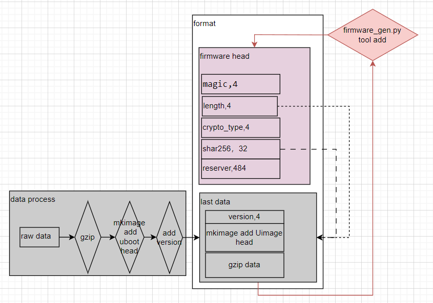

6.1.3 Partition Data Format and Generation Process#
Currently, the data in parameter partitions such as quick boot parameters, facial features, calibration parameters, AI models, speckle, RTT, and RTApp are not encrypted. The format and generation process are as follows:
image-20230705151949318
The main generation script is as follows:
# For more detailed generation details, please read the gen_cfg_part_bin function in the board/common/gen_image_script/gen_image_comm_func.sh script
${k230_gzip} -f -k ${filename}  # gzip
sed -i -e "1s/\x08/\x09/"  ${filename}.gz
# add uboot head
${mkimage} -A riscv -O linux -T firmware -C gzip -a ${add} -e ${add} -n ${name}  -d ${filename}.gz  ${filename}.gzu;
python3  ${firmware_gen}   -i ${filename}.gzu -o fh_${filename} ${arg}; # add k230 firmware head
The corresponding execution process prints as follows:
##  + k230_priv_gzip -n8 -f -k speckle.bin
##  + sed -i -e '1s/\x08/\x09/' speckle.bin.gz
##  + mkimage -A riscv -O linux -T firmware -C gzip -a 0x14040000 -e 0x14040000 -n speckle -d speckle.bin.gz speckle.bin.gzu
##  Image Name:   speckle
##  Created:      Wed Jul  5 15:37:49 2023
##  Image Type:   RISC-V Linux Firmware (gzip compressed)
##  Data Size:    45 Bytes = 0.04 KiB = 0.00 MiB
##  Load Address: 14040000
##  Entry Point:  14040000
##  + python3 /home/wangjianxin/k230_sdk/tools/firmware_gen.py -i speckle.bin.gzu -o fh_speckle.bin -n
##  the magic is:  b'K230'
##  ----- NO ENCRYPTION + HASH-256 -----
##  the encryption type:  0
##  mesg_hash:  b'3543e2038aedad88a29f8ee98983064367cc79f6e709ed7571df9b391884b8b1'
When U-Boot starts, it will parse and verify the parameter partitions (quick boot parameters, facial features, calibration parameters, AI models, speckle, RTT, RTApp) data and load the parsed raw data into the correct memory locations.
The memory locations for each parameter partition can be configured via make menuconfig -> Memory configuration (reference interface below):
image-20230705153242437

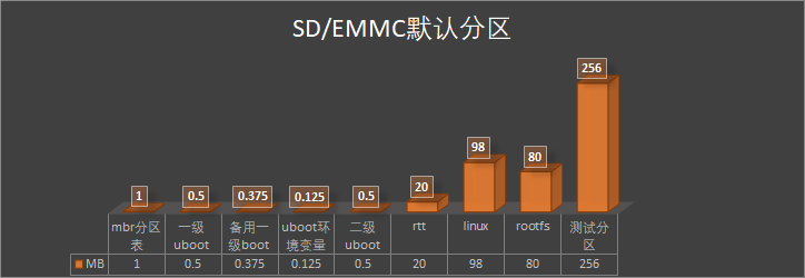

6.2 SD and eMMC#
6.2.1 Default SD and eMMC Partitions#
image-20230705100321637
SD/eMMC Default Partitions
Content
Start Addr
Size
Size MB
Size
MBR Partition Table
0x0
0x100000
1MB
Primary U-Boot
0x100000
0x80000
0.5
512KB
Backup Primary Boot
0x180000
0x60000
0.375
384KB
U-Boot Environment Vars
0x1e0000
0x20000
0.125
128KB
Secondary U-Boot
0x200000
0x800000
0.5
8MB
RTT
0xa00000
0x1400000
20
20MB
Linux
0x1e00000
0x6200000
98
98MB
Rootfs
0x8000000
0x5000000
80
80MB
Test Partition
0xd000000
0x10000000
256
256MB
6.2.2 SD and eMMC Partition Modification#
If partitioning is required, modify the board/common/gen_image_cfg/genimage-sdcard.cfg file. After modification, execute make build-image.

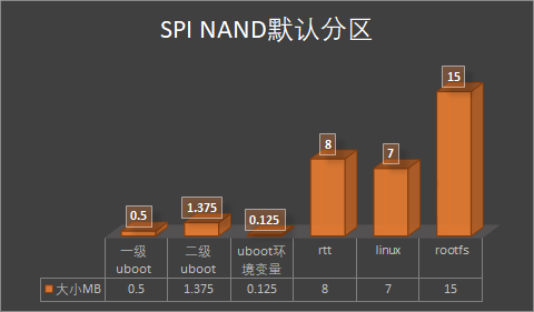

6.3 SPI NAND#
6.3 Default SPI NAND Partitions#
image-20230705111015174
SPI NAND Partitions
Content
Start Addr
Size
Start Addr
Size MB
Size
Primary U-Boot
0x0
512KB
0x0
0.5
512KB
Secondary U-Boot
0x80000
0x160000
0x80000
1.375
1.375MB
0x1e0000
128KB
0x1e0000
0.125
128KB
RTT
0x200000
0x800000
0x200000
8
8MB
Linux
0xa00000
0x700000
0xa00000
7
7MB
Rootfs
0x1100000
0xf00000
0x1100000
15
15MB
6.3.2 SPI NAND Partition Modification#
If partitioning is required, modify the board/common/gen_image_cfg/genimage-spinand.cfg file. After modification, execute make build-image.

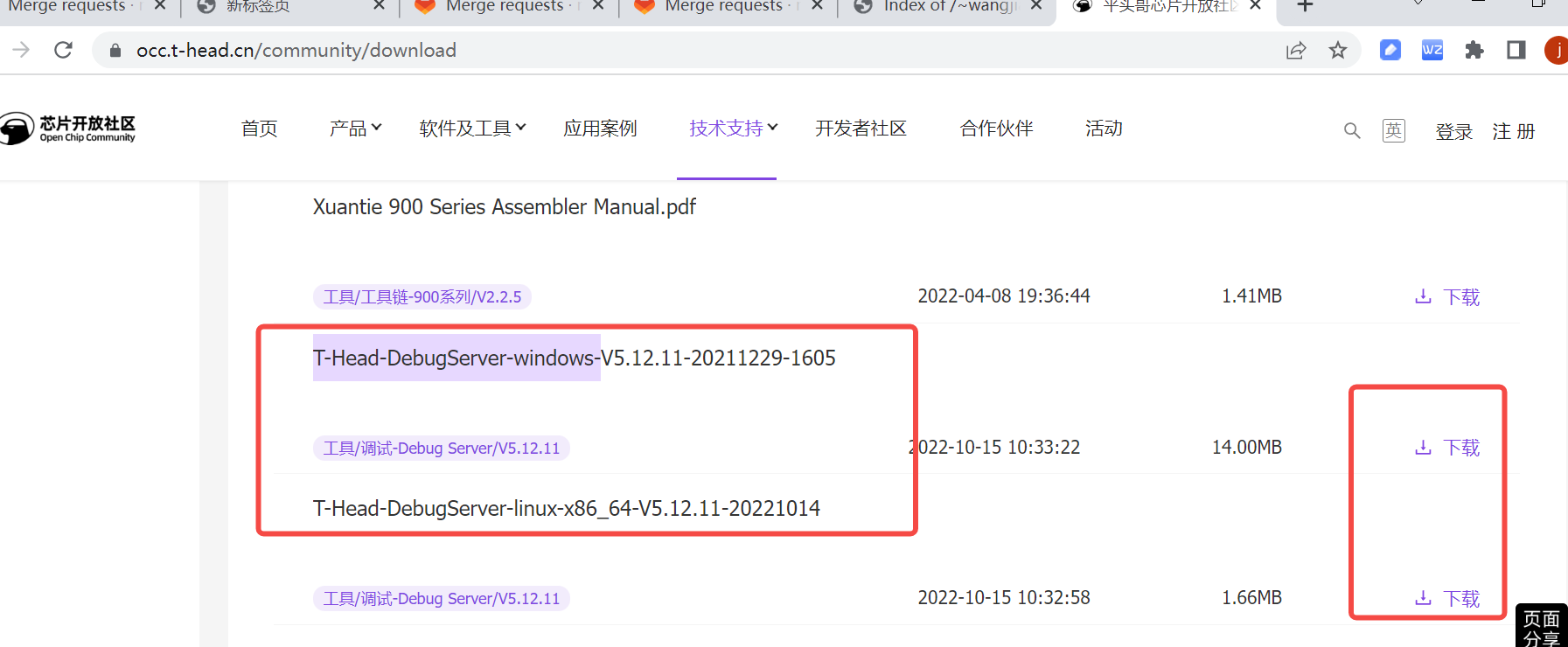

  1. Download the T-Head-DebugServer software and the “DebugServer User Guide v5.6” from T-Head’s OCC platform https://occ.t-head.cn/community/download, and install the T-Head-DebugServer software on your PC following the “DebugServer User Guide v5.6”.
