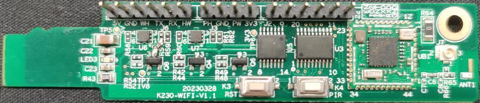

AiW4211LV10 is a low-power IoT WiFi chip, our company uses this chip platform to design an AiW4211LV10 development board, the development board can be connected to the K230 EVB board through the TF card slot. After the K230 EVB is loaded with the AiW4211LV10 driver, a wlan0 wireless card can be generated to realize network data communication.
WiFi daughter board
Figure 1-1 AiW4211LV10 development board

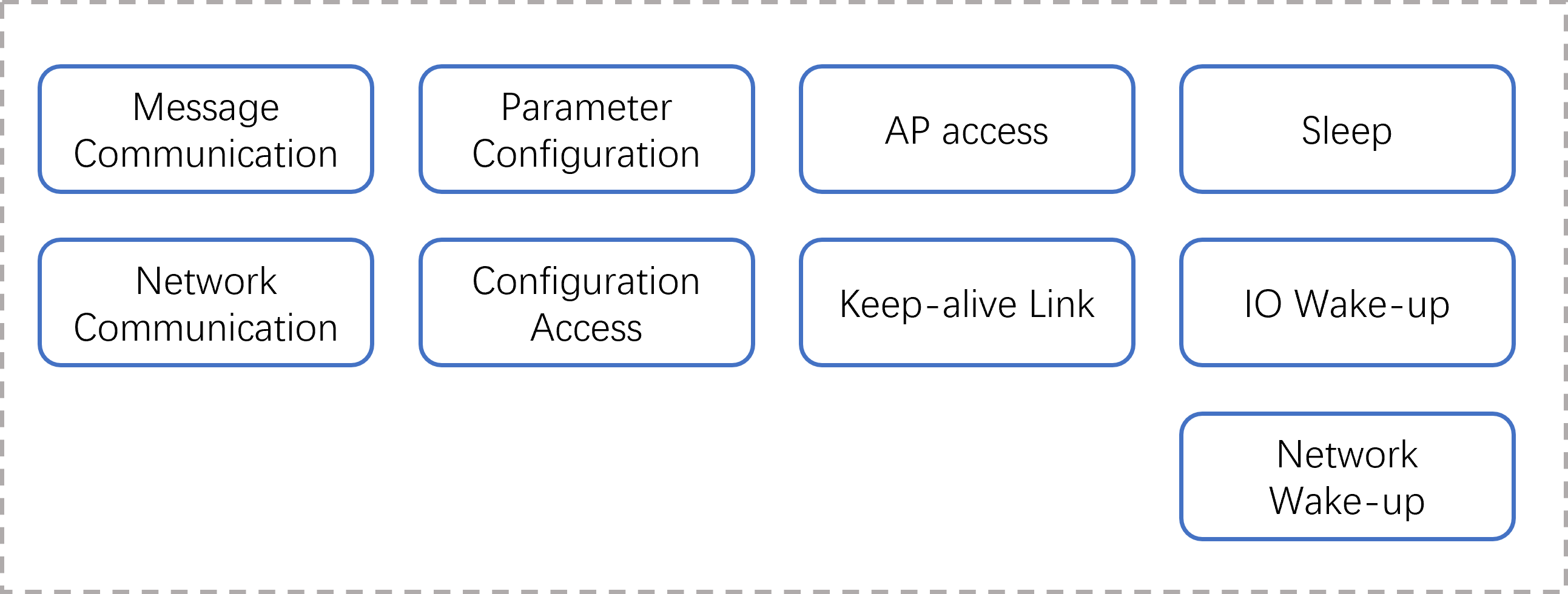

The main functions of WiFi are shown in Figure 1-1:
Block diagram of the WiFi function
Figure 1-1 WiFi function block diagram
Brief introduction of the main functions of WiFi:
  • Message communication: WiFi receives and parses message instructions and command parameters sent by the host to trigger the execution of corresponding events
  • Network communication: network data transparent transmission
  • Parameter configuration: Establishes a SoftAP, receives configuration parameters, and triggers configuration events
  • Configuration access: Manage configuration files formed by configuration data, stored on flash
  • AP access: Access the specified AP, monitor the access status, and handle it accordingly
  • keepalive link: Establishes a keepalive link between maintenance and the remote server
  • Sleep: Set the software and hardware environment, power down the host (according to the platform characteristics, the K230 is self-powered), and the WiFi enters sleep mode
  • IO wake-up: Processes button or PIR wake-up signals, restores the software and hardware environment, and powers up the host
  • Wake-on-LAN: Processes wake-up packets from keepalive links, restores the software and hardware environment, and powers up the host

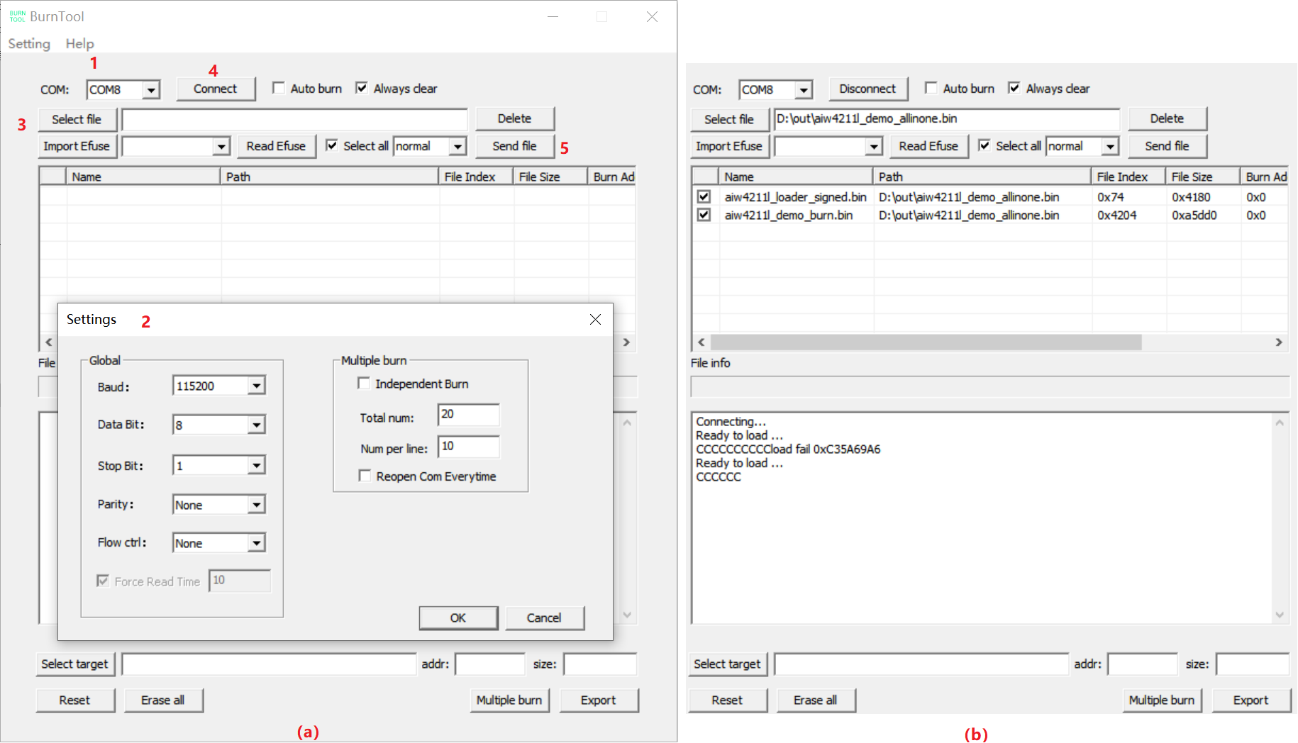

Use the BurnTool .exe of the programming tool in the WiFi SDK support directory to flash the firmware aiw4211l_demo_allinone.bin to the AiW4211LV10 development board through the serial port.
For programming methods, please refer to the document “AiW4211V10/AiW4211LV10 BurnTool Tool Tool User Guide.pdf”, which is stored in the support directory of the WiFi SDK.
Users can also contact Chengdu Aiqi Technology Co., Ltdhttp://www.aichtech.com/. for relevant information.
Figure 5-1 shows a schematic diagram of fast programming of veneers:
Burn 3
Figure 5-1 Rapid programming of veneer
Step 1: Choose to program the COM port Step 2: Configure COM port parameters through the “Setting” menu item Step 3: Select WiFi firmware step 4: Click the “Connect” control to initiate a connection to the WiFi development board, the WiFi development board is powered on, and the tool log window can see ready to load … , indicating that the connection has been established and can start flashing Step 5: Click the “Send file” control to start flashing

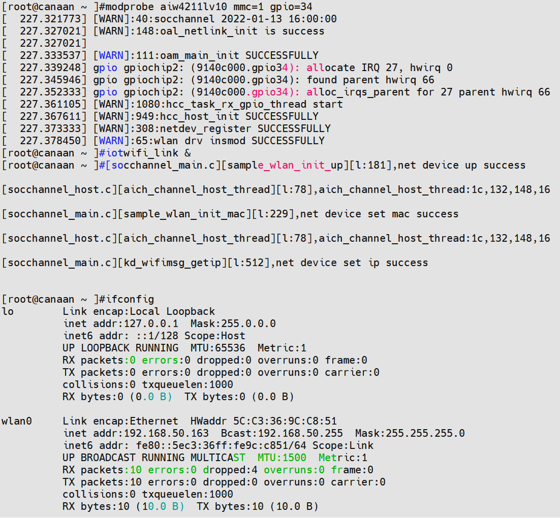

5.2 Driver Loading#
Refer to Section 2.2 to configure the hardware environment, press and hold the K1 button on the K230 EVB board to power on and start, and load the driver:
modprobe AIW4211LV10 or modprobe AIW4211LV10 MMC=1 GPIO=34
Start the configuration tool server side and run it in the background: iotwifi_link &
The current driver supports passing in the MMC master number and GPIO number for interrupt detection, which can achieve more flexible hardware configuration, and if no parameters are passed, the default values of 1 and 34 specified in the code are used respectively. iotwifi_link functions similar to wpa_supplicant, first up, and then synchronize the MAC address and IP address from the WiFi device side to the Host side.
Driver loading
Figure 5-2 Driver loading and iotwifi_link startup

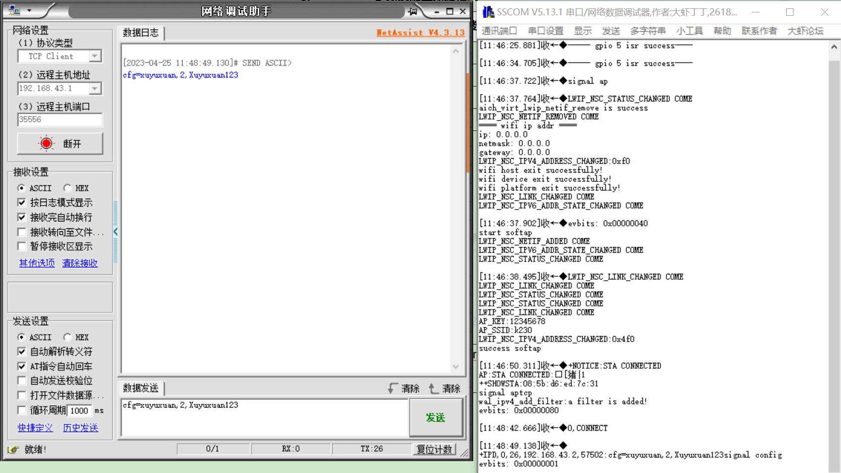

Figure 5-3 NetAssist configuration runs

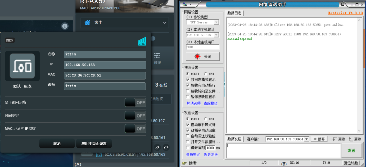

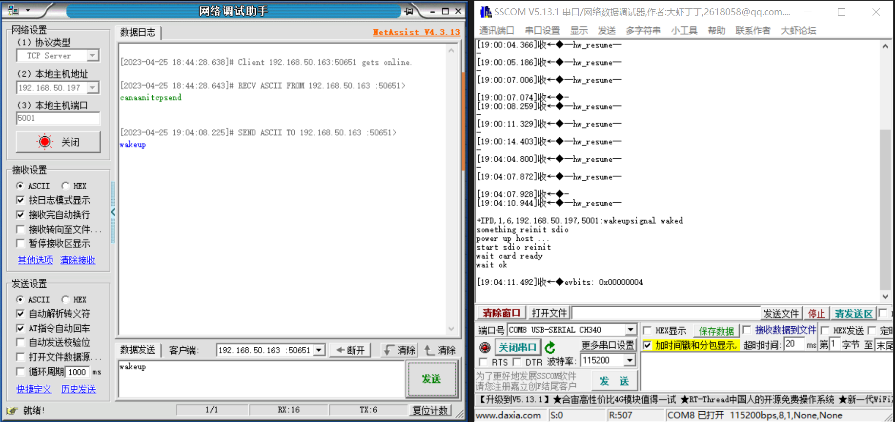

Note: “wake_gpios”: [5] is an array item, the current array has only one element 5, indicating that WiFi can be woken up by its own gpio5, the IO corresponds to the key K4, if the new wake-up source can be appended with comma separation. It depends on the specific hardware design.
config
Figure 5-4 (A) WiFi access router and assigned IP (B) tcp keepalive server

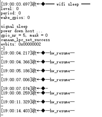

5.4.1 Configuring Hibernation Through Tools#
Run the configuration tool client to send a sleep command to trigger WiFi sleep: iotwifi_cli –dirsleep
enter sleep
Figure 5-5 WiFi enters the hibernation log

In the actual business program, WiFi sleep can be triggered by calling the API interface kd_wifi_sleep provided by the communication interface shared library libhal_iotwifi.so. Please refer to Chapter 6.2 for details.
The tool iotwifi_cli also triggers WiFi sleep by calling this interface.
5.4.3 Sleep by Monitoring Levels#
The K230 EVB can be self-powered, after power-down, the level of the J1 PIN14 (PW_EN) pin of the K230 EVB development board will be pulled low, and WiFi can also trigger sleep by monitoring the level of this pin. The premise of this function is that the K230 power management function is normal, and the macro CONFIG_WIFI_MONITOR_HOSTLEVEL is enabled when compiling the WiFi firmware (not enabled by default), after enabling the macro, WiFi will ignore the sleep command sent by the K230 and sleep only according to the pin level state.
The tool k230_pwrdown can realize the relatively simple K230 EVB dual-core self-power-down, which does not do any security processing of business logic such as file storage and status detection, so it can only be used for scenario verification where the level triggers WiFi sleep. The tool is not integrated into the K230 SDK, so it needs to be copied to the K230 EVB for execution:
./k230_pwrdown

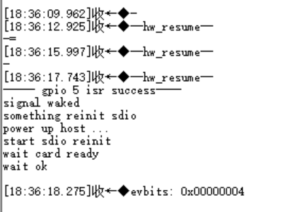

5.5 System Wake#
5.5.1 Key Wake-up#
If WiFi has gone to sleep, simply press the K4 button on the AiW4211LV10 development board to wake up WiFi, WiFi will send a wake-up signal to the PMU of the K230 EVB, and if the K230 EVB is in the power-down state (non-cold start) configured in Section 5.4.3, it will be powered on.
WiFi wake-up
Figure 5-6 Press the button wake-up log
5.5.2 Wake on LAN#
If the WiFi has gone to sleep, NetAssist sends wakeup to wake up the WiFi, WiFi will send a wake-up signal to the PMU of the K230 EVB, and if the K230 EVB is in the power-down state (non-cold start) configured in Section 5.4.3, it will be powered on.
Wake on LAN
Figure 5-7 Wake-on-LAN log
