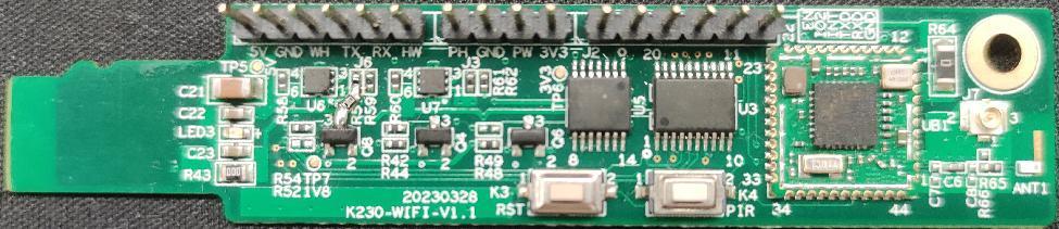

AiW4211LV10 is a low-power IoT WiFi chip, our company uses this chip platform to design an AiW4211LV10 development board, the development board can be connected to the K230 EVB board through the TF card slot. After the K230 EVB is loaded with the AiW4211LV10 driver, a wlan0 wireless card can be generated to realize network data communication.
WiFi daughter board
Figure 1-1 AiW4211LV10 development board

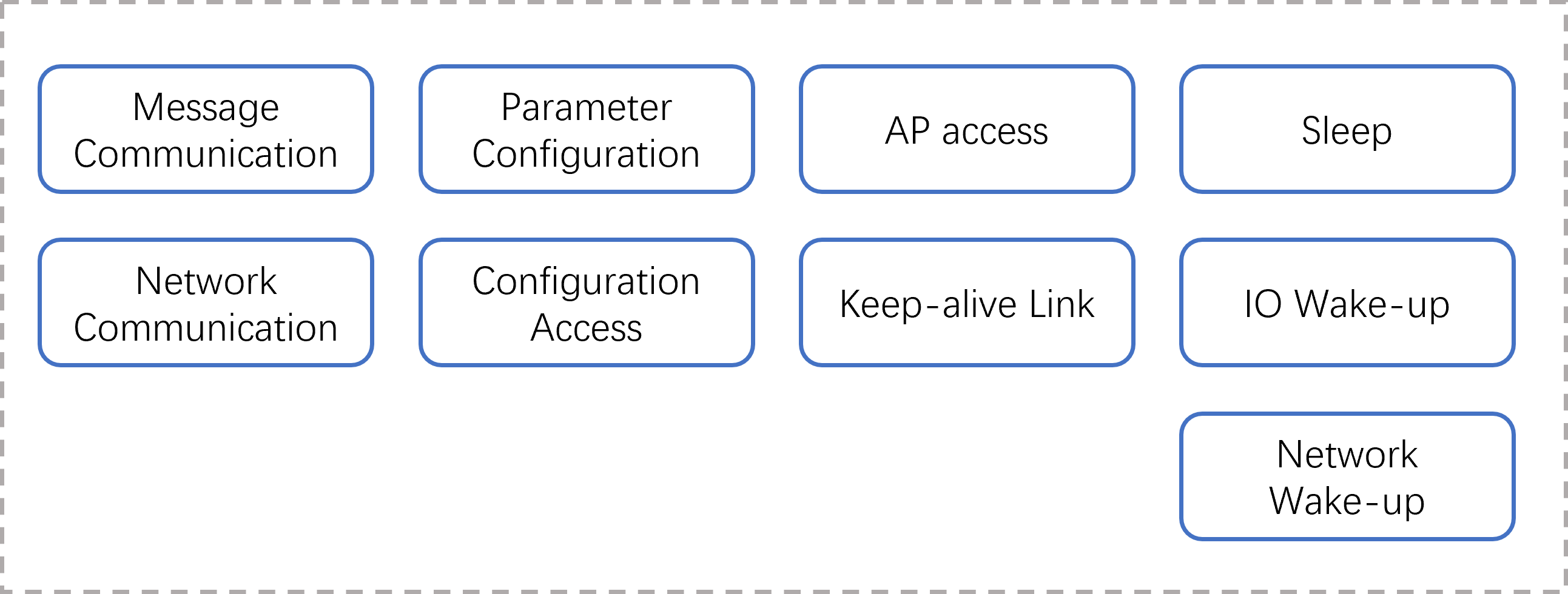

The main functions of WiFi are shown in Figure 1-1:
Block diagram of the WiFi function
Figure 1-1 WiFi function block diagram
Brief introduction of the main functions of WiFi:
  • Message communication: WiFi receives and parses message instructions and command parameters sent by the host to trigger the execution of corresponding events
  • Network communication: network data transparent transmission
  • Parameter configuration: Establishes a SoftAP, receives configuration parameters, and triggers configuration events
  • Configuration access: Manage configuration files formed by configuration data, stored on flash
  • AP access: Access the specified AP, monitor the access status, and handle it accordingly
  • keepalive link: Establishes a keepalive link between maintenance and the remote server
  • Sleep: Set the software and hardware environment, power down the host (according to the platform characteristics, the K230 is self-powered), and the WiFi enters sleep mode
  • IO wake-up: Processes button or PIR wake-up signals, restores the software and hardware environment, and powers up the host
  • Wake-on-LAN: Processes wake-up packets from keepalive links, restores the software and hardware environment, and powers up the host

  • The description of the pin headers of the AiW4211LV10 development board is shown in Table 2-3
Table 2-3 Description of the header headers of WiFi development boards
WIFI daughter board interface
Signal Definition
Level
Necessity
K230 USIP LP3 EVB Interface
J4
Goldfinger
SDIO_CLK/CMD/DATA
SDIO signals and GND
3.3V
Must connect
TF card slot
J6
PIN1
VDD_5V_WIFI
Power input _5V
POWER
Must connect
TP21(V1.1) or J5.PIN16(V1.0)
PIN2
GND
GND
GND
obligate
PIN3
WIFI_WAKE_HOST
WIFI WAKE-UP K230
1.8V
Functional signals
J1. PIN9
PIN4
WIFI_UART0_TX
Serial port TX, can be connected to K230
1.8V
obligate
J8. PIN15, no connection required at this time
PIN5
WIFI_UART0_RX
Serial port RX, can be connected to K230
1.8V
obligate
J8. PIN13, currently no connection required
PIN6
HOST_WAKE_WIFI
K230 WAKE-UP WIFI
1.8V
Functional signals
J8. PIN11, currently no connection required
J2
PIN1
WIFI_POWER_EN
WIFI enabled, reserved
3.3V
obligate
PIN2
GPIO2
Monitor K230 levels
3.3V
Functional signals
J1. PIN14
PIN3
SDIO_INT_OUT
SDIO Interruption
1.8V
Functional signals
J8. PIN9
PIN4
UART0_TXD
Debug serial port TXD
3.3V
Debug the serial port
Even PC
PIN5
UART0_RXD
Debug serial port RXD
3.3V
Even PC
PIN6
GND
GND
GND
Even PC
J3
PIN1
PIR_WAKE_HOST
PIR WAKE-UP K230
1.8V
Optional
J1. PIN pending
PIN2
GND
PIR power supply, connected to PIR black wire
GND
PIN3
PIR_WAKE_WiFi
PIR signal, connected to the PIR brown line
3.3V
PIN4
VDD_3V3
PIR power supply, connected to PIR red wire
POWER

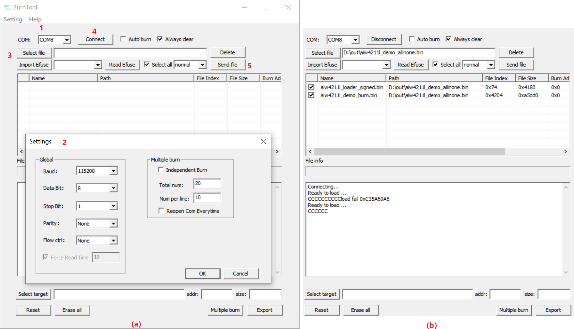

Use the BurnTool .exe of the programming tool in the WiFi SDK support directory to flash the firmware aiw4211l_demo_allinone.bin to the AiW4211LV10 development board through the serial port.
For programming methods, please refer to the document “AiW4211V10/AiW4211LV10 BurnTool Tool Tool User Guide.pdf”, which is stored in the support directory of the WiFi SDK.
Users can also contact Chengdu Aiqi Technology Co., Ltdhttp://www.aichtech.com/. for relevant information.
Figure 5-1 shows a schematic diagram of fast programming of veneers:
Burn 3
Figure 5-1 Rapid programming of veneer
Step 1: Choose to program the COM port Step 2: Configure COM port parameters through the “Setting” menu item Step 3: Select WiFi firmware step 4: Click the “Connect” control to initiate a connection to the WiFi development board, the WiFi development board is powered on, and the tool log window can see ready to load … , indicating that the connection has been established and can start flashing Step 5: Click the “Send file” control to start flashing

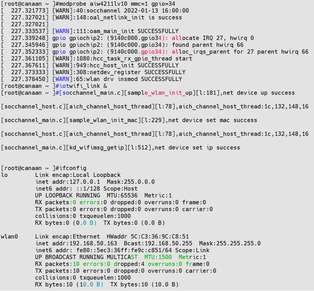

Driver Loading#
Refer to Section 2.2 to configure the hardware environment, press and hold the K1 button on the K230 EVB board to power on and start, and load the driver:
modprobe AIW4211LV10 or modprobe AIW4211LV10 MMC=1 GPIO=34
Start the configuration tool server side and run it in the background: iotwifi_link &
The current driver supports passing in the MMC master number and GPIO number for interrupt detection, which can achieve more flexible hardware configuration, and if no parameters are passed, the default values of 1 and 34 specified in the code are used respectively. iotwifi_link functions similar to wpa_supplicant, first up, and then synchronize the MAC address and IP address from the WiFi device side to the Host side.
Driver loading
Figure 5-2 Driver loading and iotwifi_link startup

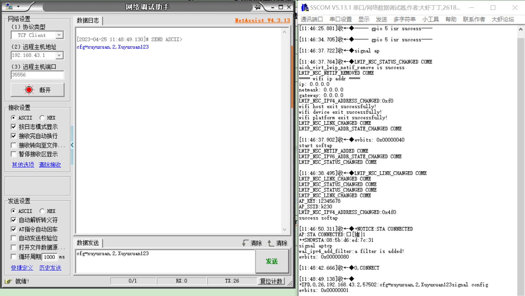

Configure AP Access Through the Network#
The AiW4211LV10 development board supports configuring the name, password, and encryption method of the target AP through the network. The steps to configure AP access are as follows:
Step 1: Prepare a router and record its hotspot name, password, and encryption method information Step 2: The AiW4211LV10 development board will start and run for the first time after the firmware is flashed, or long press the K4 button on the board for 3s after the configuration has been completed, WiFi will start the SoftAP mode to generate a hotspot and establish a socket server based on the TCP protocol Step 3: Connect your PC to the hotspot and start NetAssist Step 4: Configure NetAssist to connect to WiFi as a tcp socket client Step 5: After the server parses the configuration data, connect to the specified AP and exit the SoftAP mode
If the user has the ability, he can develop a mobile APP for network configuration, and here only the PC+NetAssist solution is used for simplicity. The SoftAP parameters and configuration data format are shown in Table 5-1, and the NetAssist configuration operation is shown in Figure 5-1:
Table 5-1 SoftAP parameters and configuration data format
Project
Parameters
AP name
K230
AP password
12345678
server ip
192.168.43.1
server port
35556
config data
cfg=<targer ap name>,<targer ap auth>,<targer ap password> for example:cfg=xuyuxuan,2,Xuyuxuan123
SoftAP access
Figure 5-3 NetAssist configuration runs

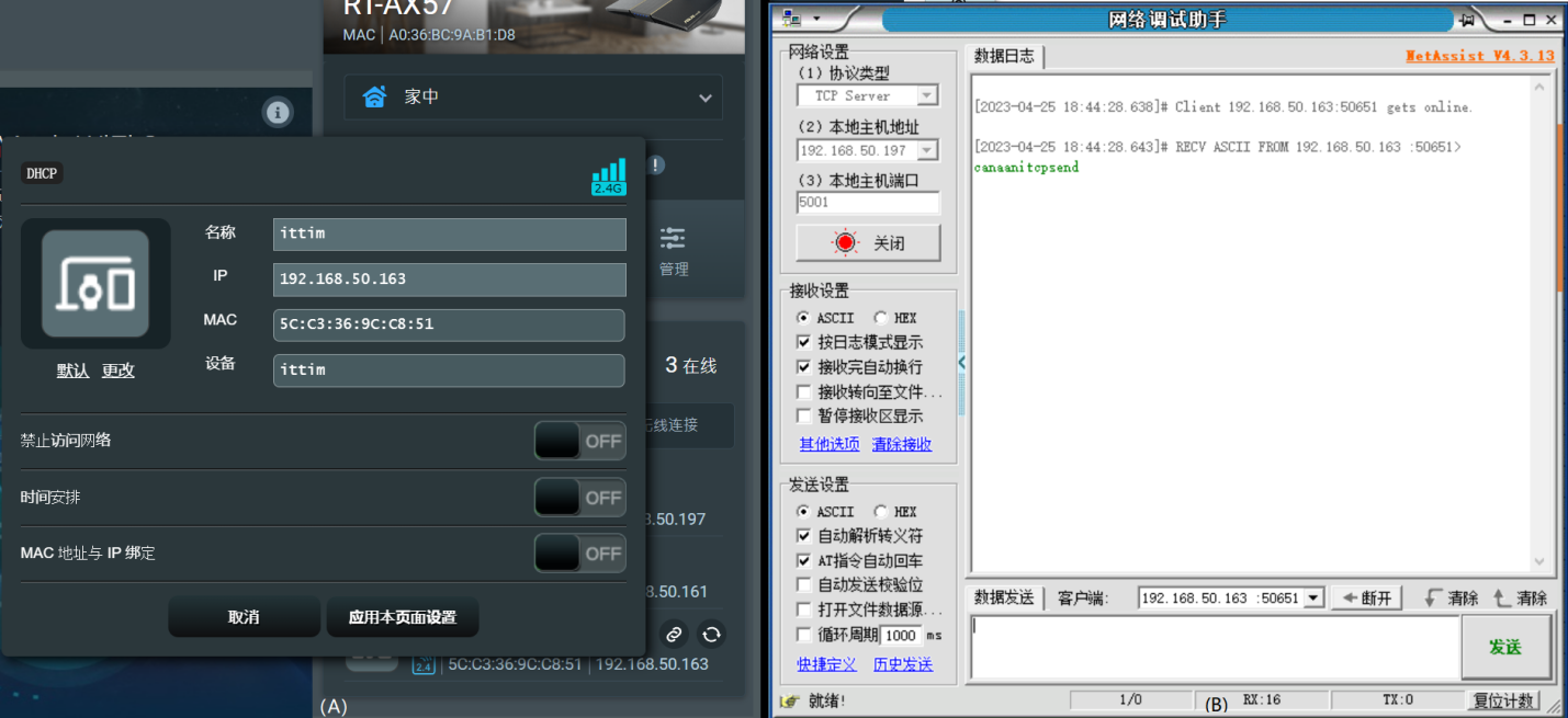

Step 1: Prepare a router and start the hotspot Step 2: Connect the PC to the hotspot, then start NetAssist, here for simplicity use PC+NetAssist as the remote keepalive server Step 3: Configure NetAssist as a tcp socket server to wait for WiFi keepalive link access Step 4: The K230 side edits the configuration file/etc/wifi.conf based on the hotspot information and the server information started by NetAssist Step 5: Run the configuration tool client, parse the configuration file, and send the configuration message: iotwifi_cli –config /etc/wifi.conf Step 6: After receiving the configuration parameters, AiW4211LV10 first stores the sleep parameters, then accesses the specified AP, and finally establishes a tcp socket client to connect to the tcp socket server established by NetAssist
/etc/wifi.conf is a WiFi working parameter configuration file, written in json format. It is basically a mapping of the wifi_config_t structure. For details, please refer to Chapter 6.1.2. The contents of the file are as follows:
"sleep": {
"level": 2,
"period": 3000,
"wake_gpios": [5]
"conn": {
"ssid": "xuyuxuan",
"auth": 2,
"key": "Xuyuxuan123",
"bssid": "",
"pairwise": 0

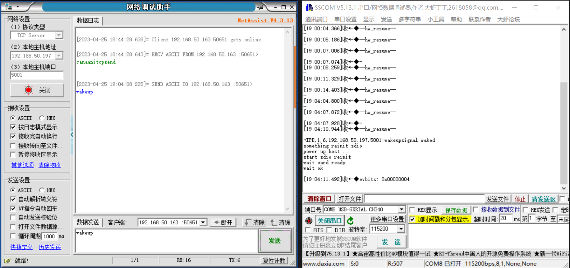

"keepalive": {
"svrip": "192.168.50.197",
"svrport": 5001,
"time": 10,
"intvl": 2,
"probes": 5,
"hrintvl": 60,
"hrprobes": 5
Note: “wake_gpios”: [5] is an array item, the current array has only one element 5, indicating that WiFi can be woken up by its own gpio5, the IO corresponds to the key K4, if the new wake-up source can be appended with comma separation. It depends on the specific hardware design.
config
Figure 5-4 (A) WiFi access router and assigned IP (B) tcp keepalive server

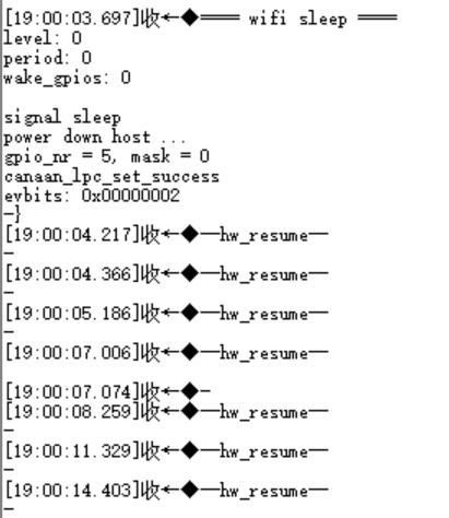

Configuring Hibernation Through Tools#
Run the configuration tool client to send a sleep command to trigger WiFi sleep: iotwifi_cli –dirsleep
enter sleep
Figure 5-5 WiFi enters the hibernation log
Sleep by Calling the API#
In the actual business program, WiFi sleep can be triggered by calling the API interface kd_wifi_sleep provided by the communication interface shared library libhal_iotwifi.so. Please refer to Chapter 6.2 for details.
The tool iotwifi_cli also triggers WiFi sleep by calling this interface.

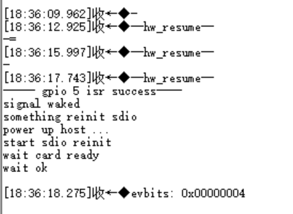

System Wake#
Key Wake-up#
If WiFi has gone to sleep, simply press the K4 button on the AiW4211LV10 development board to wake up WiFi, WiFi will send a wake-up signal to the PMU of the K230 EVB, and if the K230 EVB is in the power-down state (non-cold start) configured in Section 5.4.3, it will be powered on.
