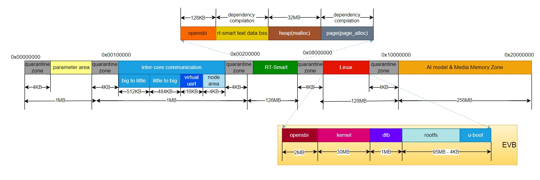

The following figure shows the memory layout of the current SDK USIP LP3 EVB and CanMV-K230:
Figure 1 SDK memory layout
You can configure the memory interval of each module by entering selection in the k230_sdk directorymake menuconfig``Memory->Configuration, and configuration is not supported at this time
Memory configuration of parameter areas and intercore communication areas
