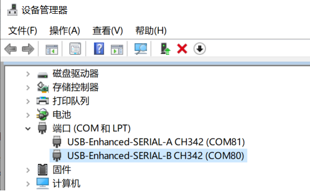

The CanMV-K230 comes with a CH342 USB to serial chip. The driver download address is https://www.wch.cn/downloads/CH343SER_EXE.html.
View the serial port number
windows-serial
Two serial ports are displayed here: COM80 for the small core Linux debug serial port, and COM81 for the large core rt-smart debug serial port.

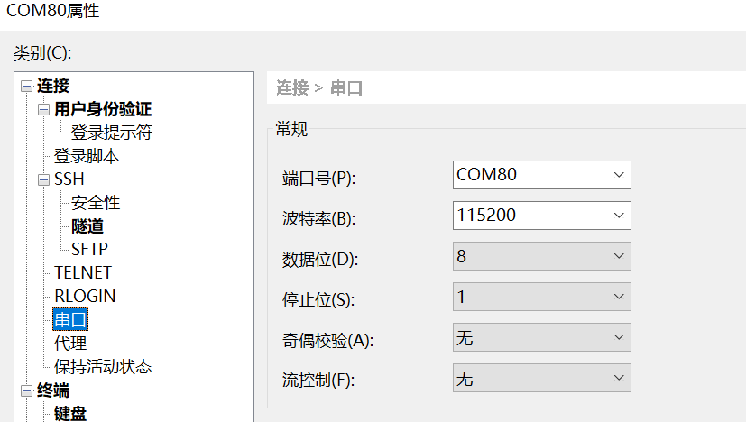

Configure serial port information
Open the Xshell tool (or other serial port tools).
  1. Select the port number displayed in the Device Manager
  2. Baud rate: 115200
  3. Data bits: 8
  4. Stop bits: 1
  5. Parity: None
  6. Flow control: None
