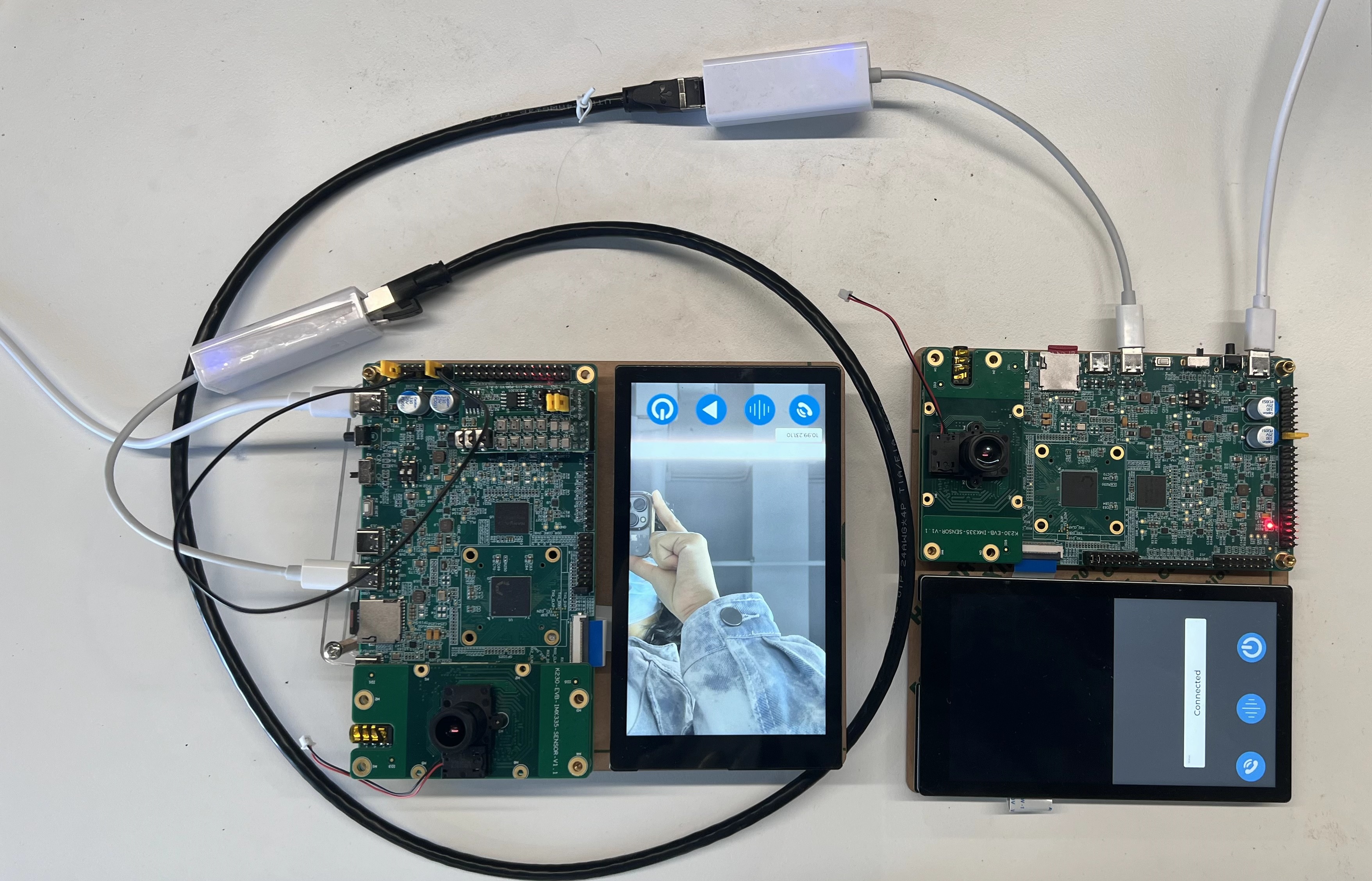

peephole boards
In the figure above, the EVB board on the left runs the peephole device side, and the EVB board on the right runs the simulated mobile phone end. The key functions on the interface UI are as follows:
  • Intercom button: Controls the start/cancel of the intercom.
  • Voice Change button: Controls the enable/disable of voice changer.
  • Play button: Go to the playback interface to play back the recorded video or captured picture.
  • Shutdown button: Controls the shutdown of the peephole device.

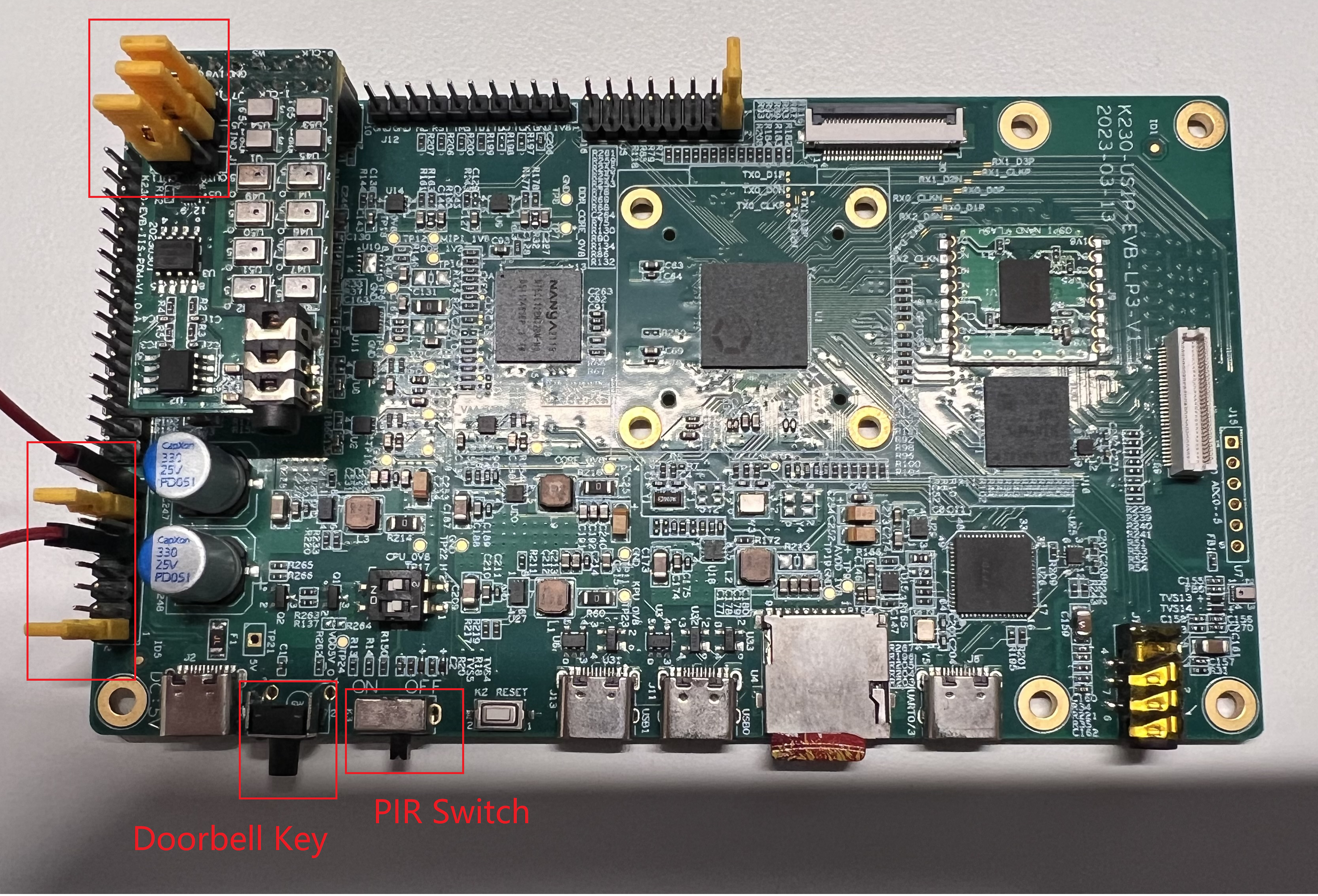

The peephole device is shown in the figure below and can be started in two ways.
  • Method 1: Dial the DIP switch toON, this method simulates PIR wake-up.
    • The device will capture the first frame, detect the humanoid, and capture the humanoid 10 seconds after it is detected. The humanoid detection referred to in this article is the entire humanoid.
    • Once this mode is activated, doorbell mode can be entered by pressing the doorbell button shortly.
  • Method 2: Long press the button, this method simulates the doorbell wake-up.
    • The MIC and earphone on the EVB board simulate the scene outside the door; the MIC and earphone on the audio daughter board simulate the scene inside the door.
peephole_device

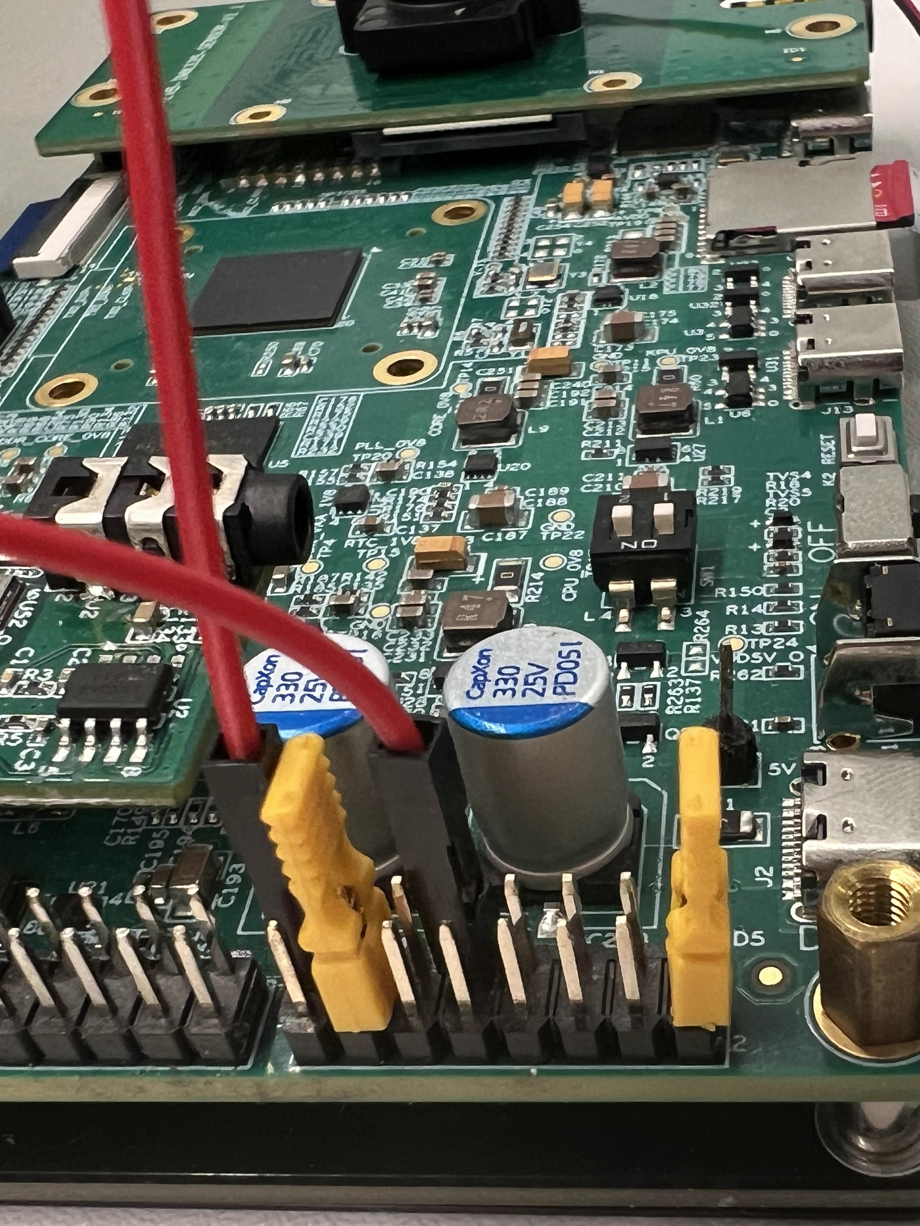

After burning the peehole image, you need to short-connect the 1 and 2 pins, 13 and 14 pins, 9 and 15 pins of J1 respectively, as shown in the figure below.
pmu connection
