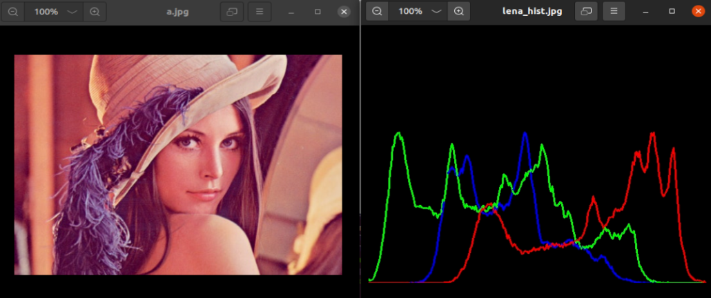

1_opencv_calcHistAn example of the running result of a test case is as follows:
test_opencv_calcHist
Among them, the left side is the original image, and the right side is the pixel histogram information of 3 channels.

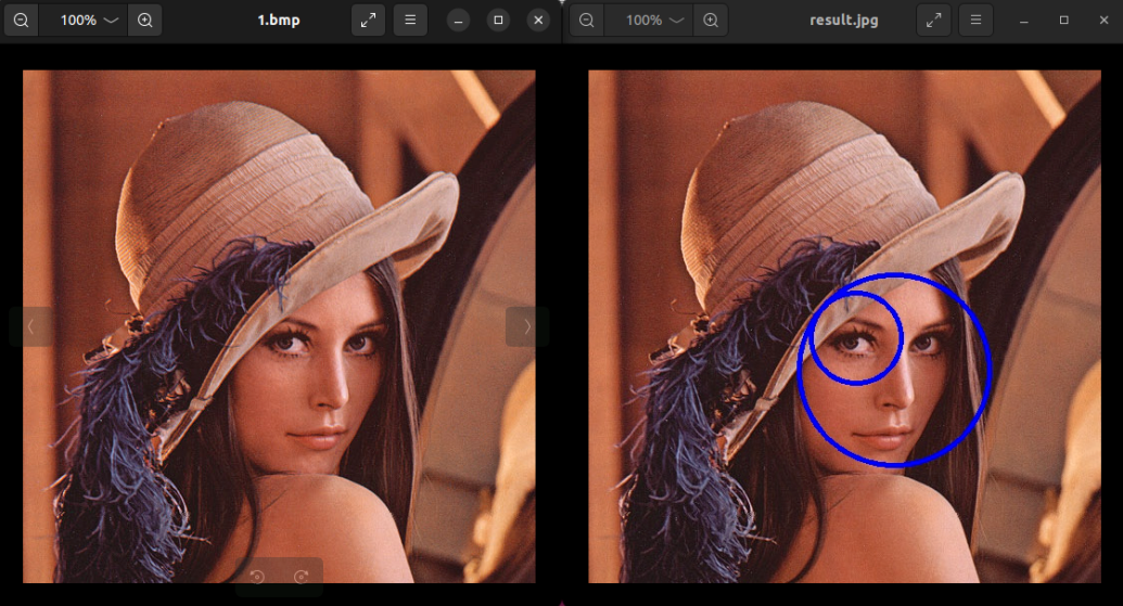

4_opencv_features2dAn example of the running result of a test case is as follows: test_opencv_features2d The left side is the original image, and the right side is the processed feature extraction result map.
3.5 opencv_objdetect#
5_opencv_objdetectThe test cases run as follows:
5_opencv_objdetectAn example of the running result of a test case is as follows: test_opencv_objdetect
Among them, the left side is the original image, and the right side is the object detection result map of the eyes and face.
