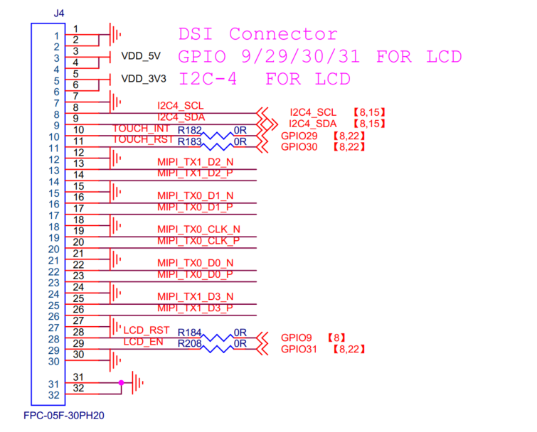

1.1.1 MIPI interface#
The hardware pins on EVBLP3 are as follows:
The image contains an illustrated description that has been automatically generated
  • screen touch is I2C4 (SCL: GPIO7, SDA GPIO8)
  • screen touch rst:gpio29, int:gpio30
  • screen rst:gpio9,backlight:gpio31
  • The pins of MIPI correspond one-to-one with the pins of the screen

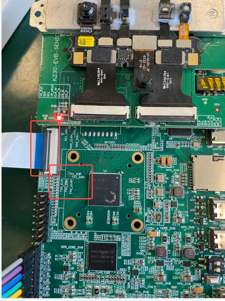

1.1.2 Physical drawings#
Image contains game console, electronics, circuit description has been automatically generated
  • Figure 1 is the MIPI interface, using a flexible cable
  • Figure 2 is the MIPI signal test point, including four data lines and one CLK line

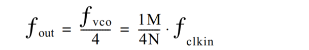

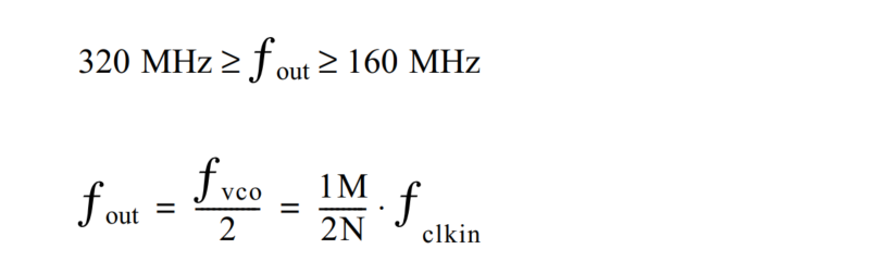

1.2.1.1 Calculate the PLL of PHY#
The data rate is given by twice the PLL output clock phase frequency: data rate (Gbps) = PLL Fout(GHz) * 2, and the output frequency is a function of the input reference frequency and the multiplier/divider ratio. The PLL for calculating PHY is divided into 4 ranges to do calculations, different frequencies correspond to different frequencies, which can be determined in the following ways:
M
m+2
N
n+1
Fclkin
24M

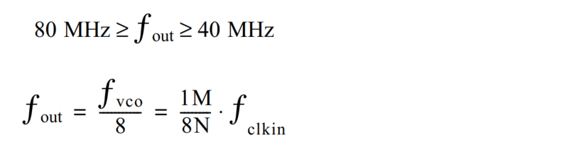

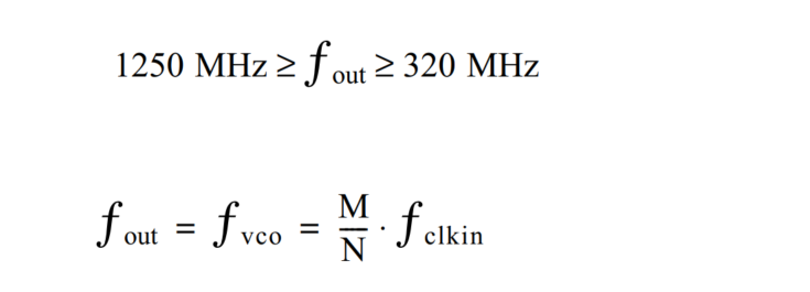

For:
Text, letter description is automatically generated

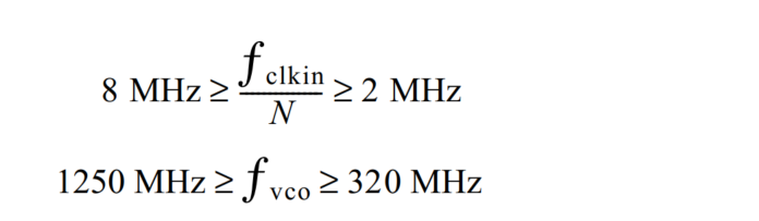

However in this need to follow the following restrictions:
The image contains a text description that has been automatically generated
For:
For:
The Text description is automatically generated
For:
The text Medium confidence description has been automatically generated
Each of the above for corresponds to a PLL level, and different levels correspond to different calculation formulas and limits, and the calculation example is as follows:

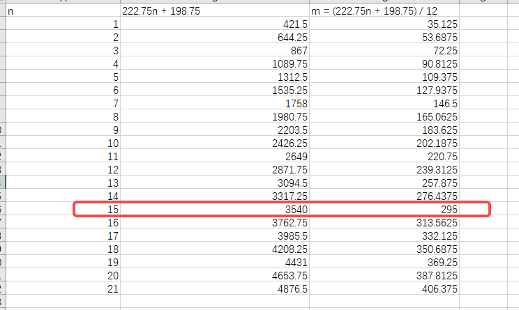

Example:
The rate of mipi is 445.5M: so the rate of pll is 222.75M, and the second formula should be selected, calculated as follows
222750000 = 1M / 2N = (m+2) / 2(n+1) * 24000000 , the finishing formula is as follows:
222.75n + 198.75 = 12m is calculated by excel as follows:
The table description is automatically generated
The resulting m = 295 and n = 15.
Configure the m and n in the PLL are integer values, if all the values are not integers, you need to add 1 and subtract 1 from the values of m and n, push back to see which frequency you need to be the closest, and then verify whether it is available, you can’t repeat the above operation.

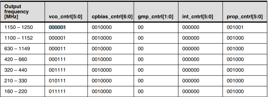

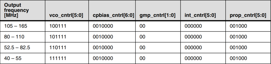

1.2.1.2 Configure VOC for PHY#
The VOC configured with PHY can be queried according to the table:
Example:
The rate of mipi is 445.5M: so the rate of the pll is 222.75M, and VOC = 010111 = 0x17

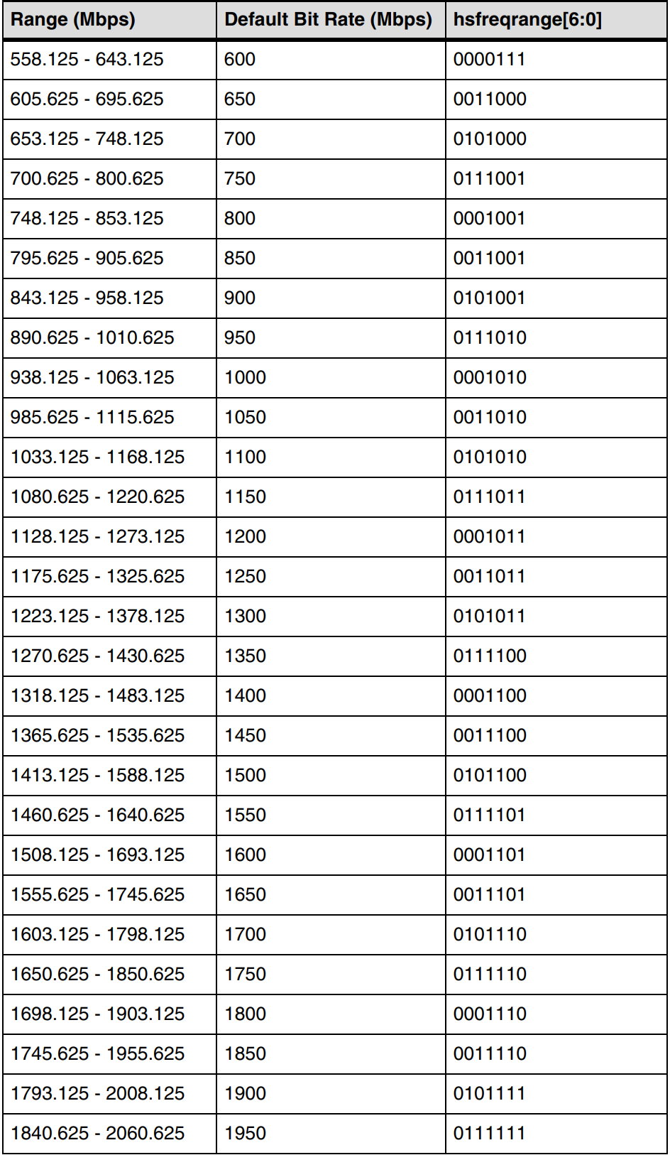

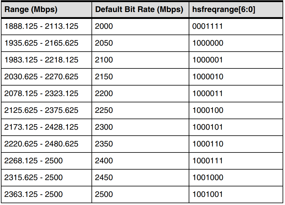

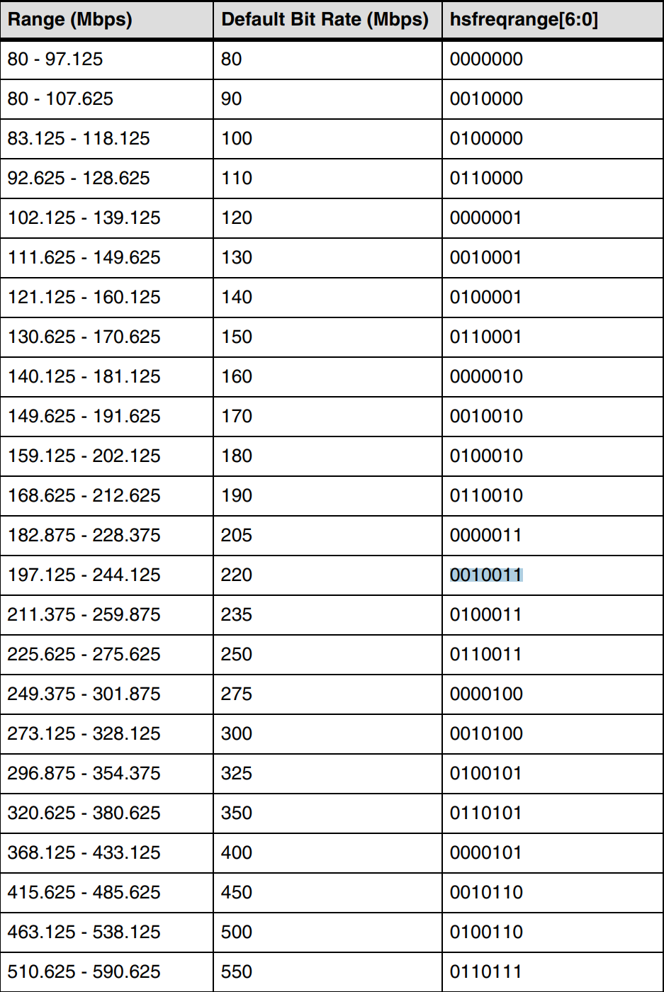

1.2.1.3 Configure FreQ#
The FREQ of the configured PHY can be queried according to the table:
Example:
The rate of mipi is 445.5M: the rate of pll is 222.75M, freq selects 0100101, when configuring this, you need to set the highest bit [7] = 1, all freq = 10100101 = 0xa5

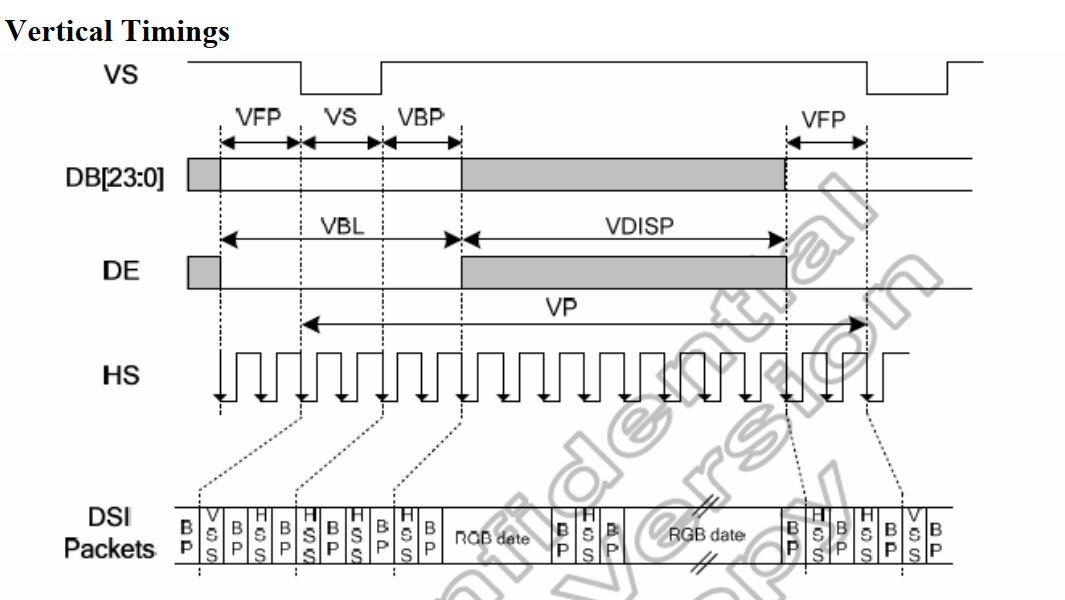

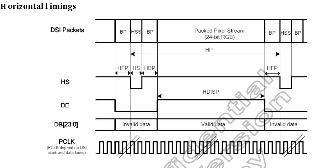

1.2.2.1 Configure the timing of the display#
Each manufacturer’s screen will have a set of timing for screen control, mainly including the control timing of the frame and the control timing of a line, as shown in the following figure:
The Illustrative description has been automatically generated
Illustrative, Schematic description is automatically generated
These parameters are also used in DSI, and the configured timing and screen are consistent.

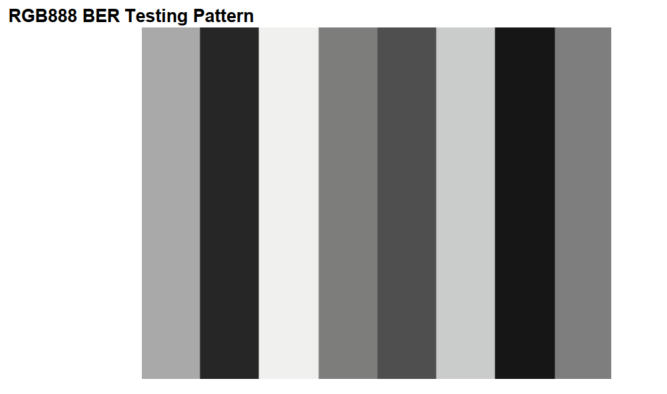

1.2.2.3 DSI’s self-test mode#
The DSI self-test mode will send the data of the color bar according to the self-configured DSI timing to be sent, so that it does not rely on VO to read data from the DDR, and the test mode is shown as follows:
Background pattern The medium confidence description has been automatically generated
The 24-bit interface is used between DSI and vo, so the configured color bar is the effect shown above, and the use method only needs to enable the color bar after configuring DSI, and the API is as follows

3.1.16 k_vo_display_resolution#
【Description】
Display timing。
【Definition】
typedef struct{  k_u32 PCLK;  k_u32 phyclk;  k_u32 htotal;  k_u32 hdisplay;  k_u32 hsync_len;  k_u32 hback_porch;  k_u32 hfront_porch;  k_u32 vtotal;  k_u32 vdisplay;  k_u32 vsync_len;  k_u32 vback_porch;  k_u32 vfront_porch; } k_vo_display_resolution;
【Members】
Member name
description
pclk
The pix clk frequency of VO
phyclk
The frequency of D-Phy
htotal
The total pixels of a row
hdisplay
The number of valid pixels per row
hsync_len
The number of pixels that the row synchronizes
hback_porch
The number of pixels on the back porch
hfront_porch
The number of pixels on the front porch
vtotal
Total number of rows
vdisplay
The number of rows valid for one frame
vsync_len
The number of pixels in which the frame is synchronized
vback_porch
The number of rows on the back porch
vfront_porch
The number of rows on the front porch
【Note】
none
【See Also】
none
3.1.17 k_vo_mipi_phy_attr#
【Description】
A structure that defines the MIPI PHY frequency
【Definition】
typedef struct {  k_u32 n;  k_u32 m;  k_u32 voc;  k_u32 phy_lan_num;  k_u32 hs_freq; }k_vo_mipi_phy_attr;
【Members】
Member name
description
n
Pll coefficient
m
Pll coefficient
voc
Pll coefficient
hs_freq
The frequency range of Phy
phy_lan_num
The number of LANs for Phy
【Note】
none
【See Also】
none

3.1.20 k_connector_type#
【Description】
The type of connection screen.
【Definition】
typedef enum {  HX8377_V2_MIPI_4LAN_1080X1920_30FPS;  LT9611_MIPI_4LAN_1920X1080_30FPS; } k_connector_type;
【Members】
Member name
description
v_frame
Information about the frame
HX8377 Screen initialization
HDMI 1080p initialization
【Note】
none
【See Also】
none
3.1.21 k_dsi_lan_num#
【Description】
The number of lanes for DSI.
【Definition】
typedef enum {  K_DSI_1LAN = 0,  K_DSI_2LAN = 1,  K_DSI_4LAN = 3, } k_dsi_lan_num;
【Members】
Member name
description
K_DSI_1LAN
1-line mode
K_DSI_2LAN
2-wire mode
K_DSI_4LAN
4-wire mode
【Note】
none
【See Also】
none

3.1.24 k_connectori_phy_attr#
【Description】
Connector Connector Configuration PHY information.
【Definition】
typedef struct {  k_u32 n;  k_u32 m;  k_u32 voc;  k_u32 hs_freq; } k_connectori_phy_attr;
【Members】
Member name
description
n
Pll coefficient
m
Pll coefficient
voc
Pll coefficient
hs_freq
【Note】
none
【See Also】
none
