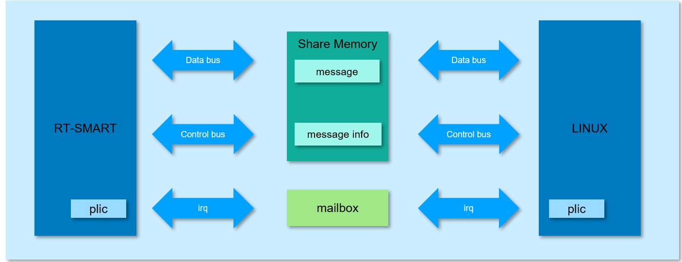

1.1.1 Internuclear communication implementation principle#
Shared memory is used for large and little cores to send the specific content of communication messages
Shared memory management is used to identify the properties of communication messages such as address, size, port number, etc
Mailbox implements the notification mechanism after the large and little cores send messages through interrupts
1.1.2 Memory Space Usage#
At present, the data sharing memory area used by large and little cores is designed to have a total of 1M space, and for the party involved in communication, the sending and receiving space each occupies 512KB of space. The area of shared memory used to maintain the state of individual cores is 4KB.
