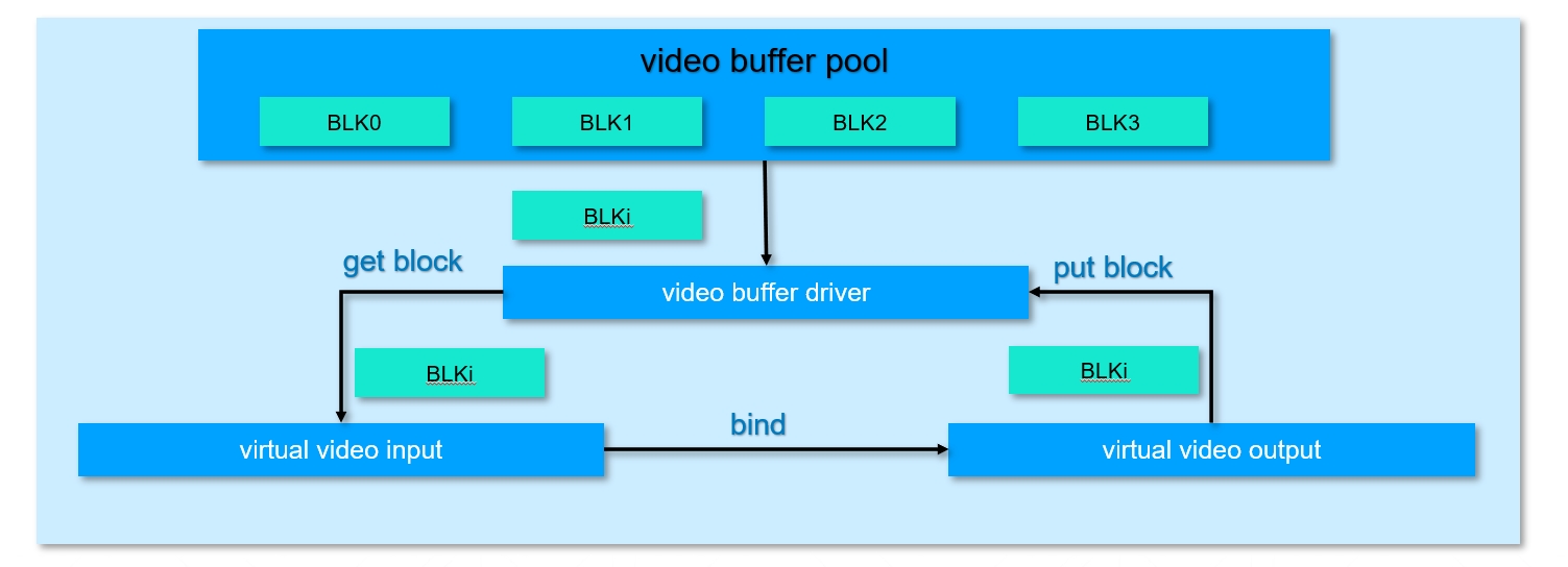

1.2.1 VB Pool#
A video buffer pool is a set of buffers (rather than one) that are primarily used by multimedia hardware devices and flow between multimedia hardware devices. The vb pool is divided into public vb pool and private vb pool, the public vb pool is mainly for VI, before using to determine the size of the vb block according to the image parameters of the VI, and then apply for a certain number of vb blocks to form a vb pool. In general, for the original picture input by the VI, the size of one frame corresponds to the size of a vb block, and multiple vb blocks are equivalent to providing the VI with a mechanism for multi-frame buffering. These public vb blocks can also be used by VO or VENC. Private vb pools often represent that the data stored in memory is closely related to the multimedia device itself, for example, the encoded stream data is still very different from the actual image pixel composition of the video stream, these streams are only available codecs, and VB provides a dedicated buffer pool for these devices. The following figure shows the process of virtual VI and virtual VO using VB for vb block circulation.
The Illustrative description has been automatically generated
