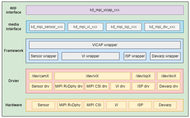

The VICAP software architecture is shown in Figure 1-2, from top to bottom: application interface layer, media interface layer, system framework layer, driver layer and hardware layer.
Application layer interface: Provide kd_mapi_vicap_xxx form of API interface and usage instructions. It is a further encapsulation of the functional interfaces provided by the various submodules of the media interface layer, simplifying the application development process.
Media Interface Layer: This layer consists of VICAP submodules, each of which provides its own Media Interface API encapsulation.
Framework layer: responsible for the control and management of the software functions and business logic of the entire system of VICAP. By integrating the interfaces and functions provided by each sub-module, a complete set of VICAP system control logic and processes is formed.
Driver layer: A collection of kernel driver functions for each hardware module of VICAP.
Hardware layer: A collection of specific hardware modules of VICAP, including sensors.

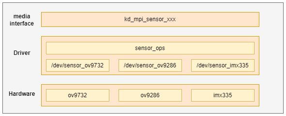

The system architecture of the sensor module is shown in Figure 1-4 below:
Figure 1-4 Sensor system architecture
From top to bottom: media interface layer, hardware driver layer, and hardware layer
Media Interface Layer: Provides kd_mpi_sensor_xxx interfaces for external modules to operate and access sensor devices.
Driver layer: This layer mainly consists of two parts, namely: sensor_dev and sensor_drv.
sensor_dev: Responsible for the registration of device driver files and provide the implementation process of file operation interface. The kernel driver is accessed by registering the device file node /dev/sensorxx for programs in user space.
sensor_drv: The hardware driver for the specific sensor and encapsulates the operation for the sensor as a unified interface.
Hardware layer: sensor module hardware, the current system supports up to three hardware sensors at the same time.
