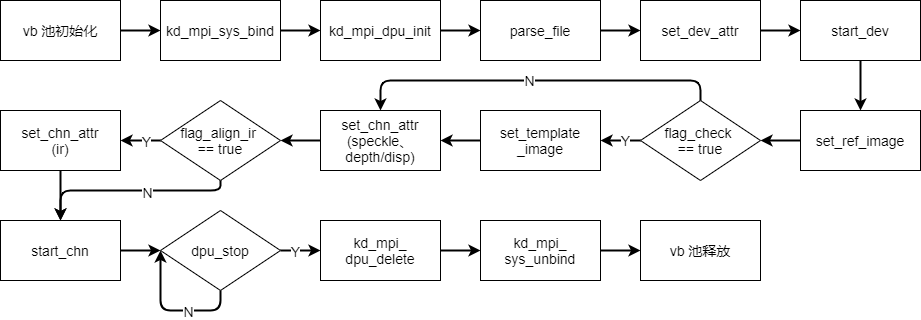

1.2.1 Binding mode invokes the process#
The first step is to initialize vb pool. The last step is to release vb pool.
Illustrative, Schematic description is automatically generated

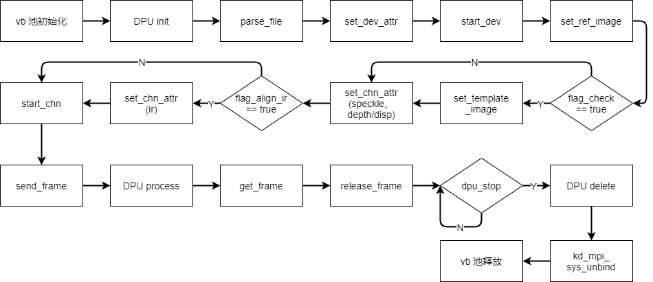

1.2.2 Invoke the process in unbound mode#
The Illustrative description has been automatically generated
