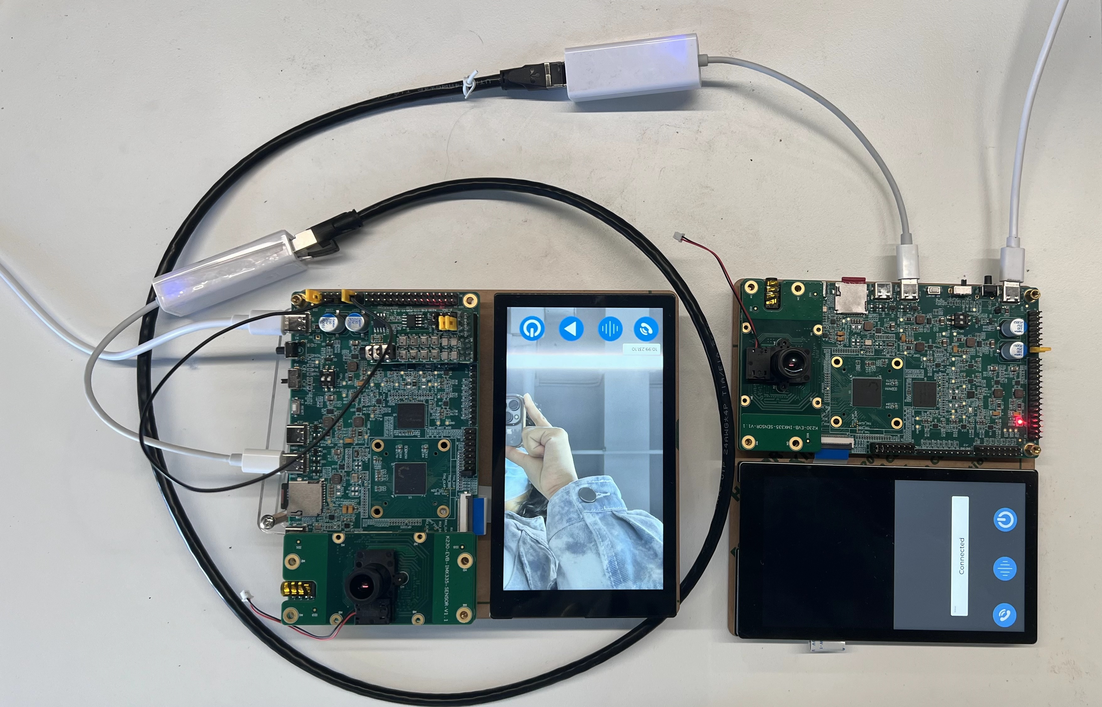

Apart from the external audio sub-board and Ethernet cable, two sets of devices are needed for the remote peephole: one set as the peephole device and one set to simulate the mobile device. The audio sub-board is used on the peephole device end.
In the above image, the EVB board on the left runs the peephole device end, while the EVB board on the right runs the simulated mobile end. The button functions on the UI interface are as follows:
Intercom button: Controls the start/cancel of the intercom.
Voice change button: Controls the enable/cancel of the voice change.
Playback button: Enters the playback interface to replay recorded videos or captured images.
Shutdown button: Controls the shutdown of the peephole device end.

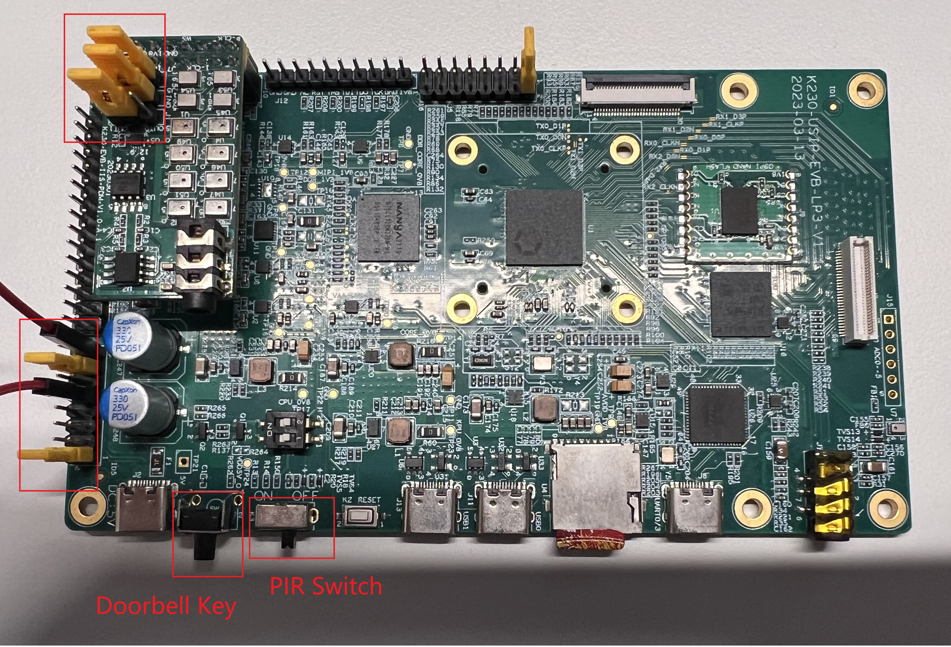

Method 1: Toggle the dip switch to
ONto simulate PIR wake-up.The device will perform the first frame capture, human detection, and capture 10 seconds after detecting a human. Human detection here refers to the whole human body.
After starting this mode, you can enter doorbell mode by briefly pressing the doorbell button.
Method 2: Long press the button to simulate doorbell wake-up.
The mic and headset on the EVB board simulate the outside door scene; the mic and headset on the audio sub-board simulate the inside door scene.

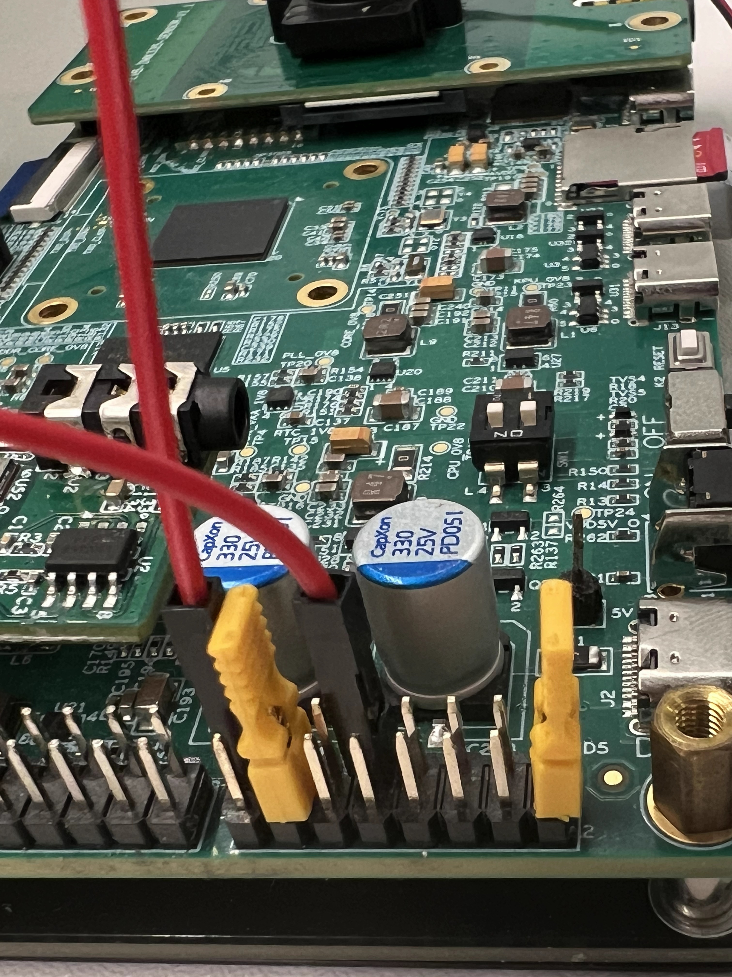

The peephole image is in self-start mode. After flashing the peephole image, short the 1, 2 pins, 13, 14 pins, and 9, 15 pins of J1 as shown below.
