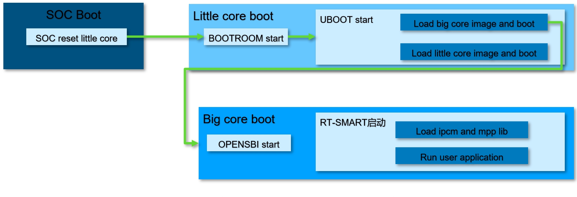

K230 boot sequence#
The overall startup process of the K230 is shown in the figure below

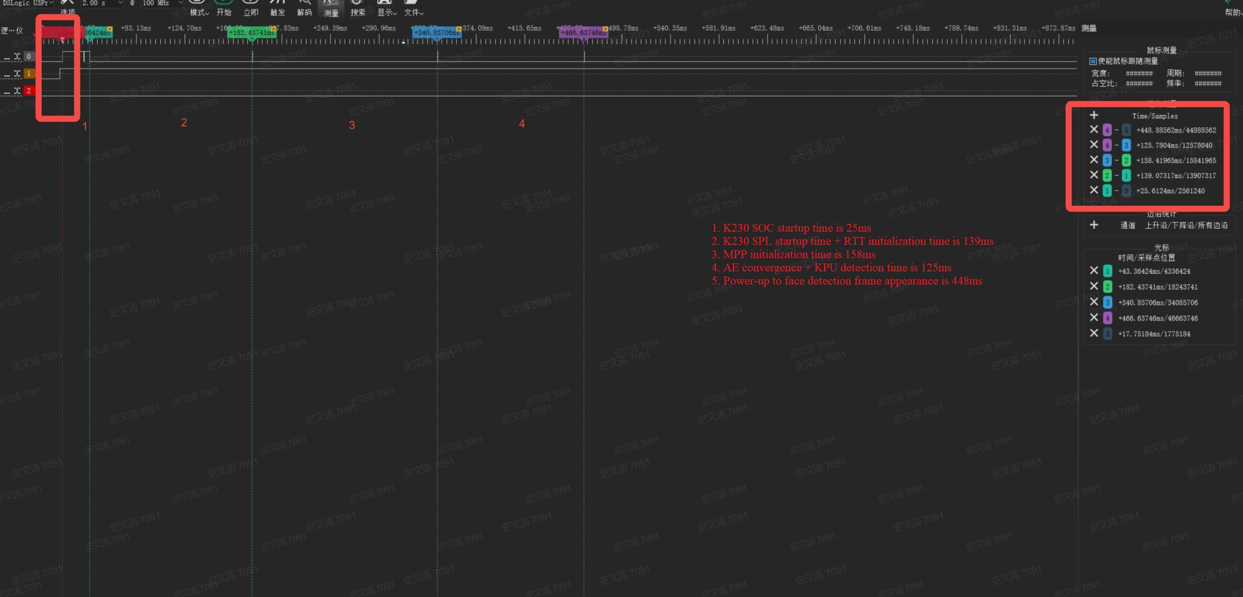

Adding GPIO edge changes at the point that needs to be measured allows for more accurate timing with a logic analyzer or oscilloscope.
The power signal on the development board can be detected by the 14th pin of the K230_EVB_LPDDR3_UNSIP board J1 (15 and 16 pins need to be shorted with jumper caps).

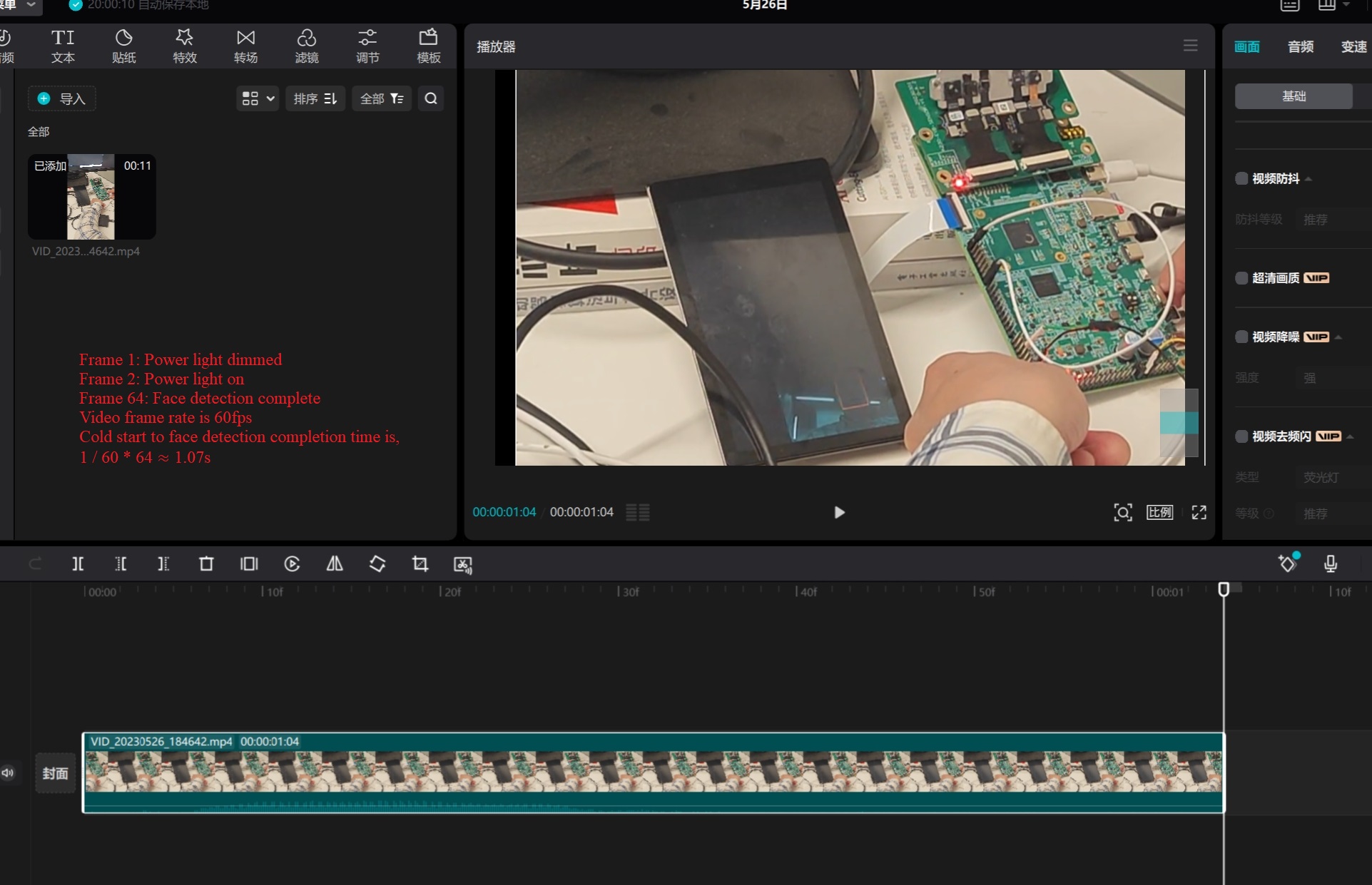

Video recording of the entire system boot process, the on-board power light on means that the system is powered on, and the VO display VI image represents that the video pipeline has been established and can be displayed. A frame appears to frame the face to indicate that face recognition is completed.

As can be seen from the figure in the previous section, the first step after bootROM is to load the image of the large and little cores, so the first step to optimize the boot time is to crop the large and little core images first.

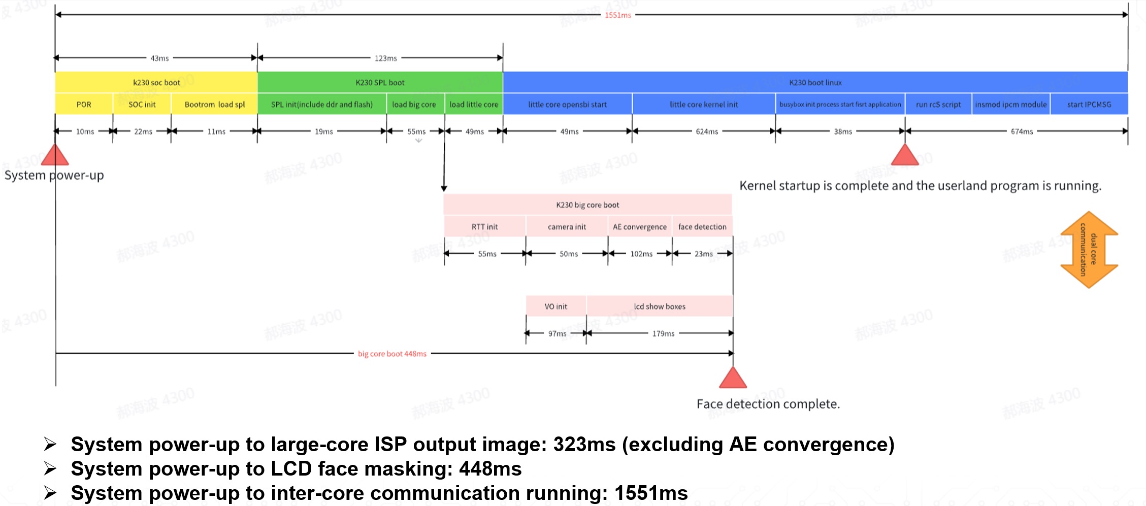

Optimize performance#
Door lock POC start time statistics, the measurement time of this statistic is June 9, and there may be errors with the current latest SDK version data door lock
