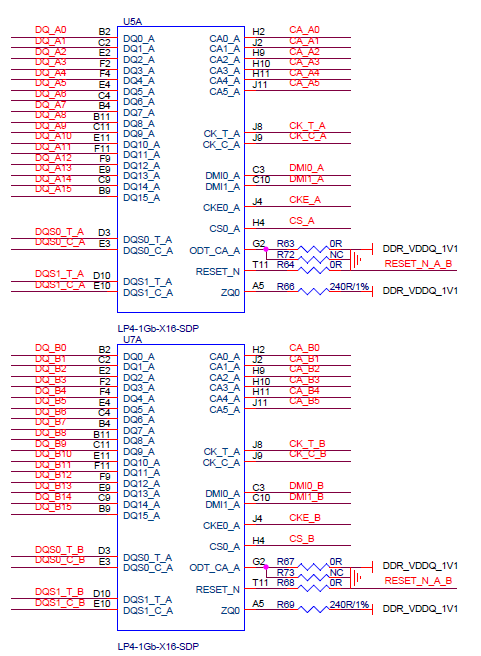

LPDDR4
W66AP6NBUAF/G/HI
Winbond
4Gb
LPDDR4
K4F8E304HB-MGCJ
Samsung
8Gb
LPDDR4
EM6LF32MBAJB-62SH
EtronTech
8Gb
LPDDR4
RS256M32LS4D1BNR-46BT
Rayson
8Gb
LPDDR4
RS512M3LO4D1BDS-53BT
Rayson
16Gb
LPDDR4
GDB4CBQN-MK
GigaDevice
16Gb
The schematic of the K230 DDR PHY and each DRAM chip must be consistent with the reference schematic, including power decoupling capacitors.

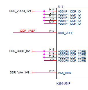

LPDDR4#
The circuit design of LPDDR4 refers to Figures 3-12, 3-13, 3-14, 3-15, and 3-16.
Figure 3-12 K230 LPDDR4 Circuit
Figure 3-13 K230 LPDDR4 Power Circuit
Figure 3-14 K230 LPDDR4 Reference Voltage Circuit
Figure 3-16 LPDDR4 Chip Power Circuit
When using LPDDR4, note:
The schematic of the DDR PHY and each DRAM chip needs to be consistent with the reference design, including power decoupling capacitors.
The DDR_ZN pin needs to be connected to a 240Ω (1%) calibration resistor to ground.
The RESRT_N pin is directly connected to the corresponding pin of the chip.
When using LPDDR4 chips with K230, the VREF voltage is 0.6V, and it is recommended to use 1kΩ (1%) resistors for voltage division.
