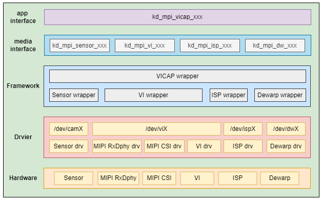

VICAP hardware consists of four modules: Sensor, VI, ISP, and Dewarp (as shown in Figure 1-1 below). Support up to 3 sensors at the same time, the MCM module through the ISP to realize the time division multiplexing management of multiple sensors, the output data of the multiple sensors is written to DDR through the Write interface of the Memory Interface of the MCM, and then read in and loaded into the ISP Pipeline for processing through the Read interface.
Figure 1-1 VICAP hardware architecture diagram
The VICAP software architecture is shown in Figure 1-2, from top to bottom: application interface layer, media interface layer, system framework layer, driver layer and hardware layer.
Application layer interface: Provide kd_mapi_vicap_xxx form of API interface and usage instructions. It is a further encapsulation of the functional interfaces provided by the various submodules of the media interface layer, simplifying the application development process.
Media Interface Layer: This layer consists of VICAP submodules, each of which provides its own Media Interface API encapsulation.
Framework layer: responsible for the control and management of the software functions and business logic of the entire system of VICAP. By integrating the interfaces and functions provided by each sub-module, a complete set of VICAP system control logic and processes is formed.
Driver layer: A collection of kernel driver functions for each hardware module of VICAP.
Hardware layer: A collection of specific hardware modules of VICAP, including sensors.

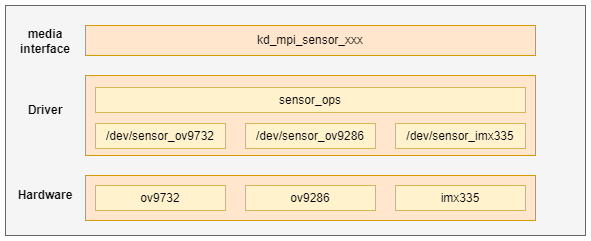

The system architecture of the sensor module is shown in Figure 1-4 below:
Figure 1-4 Sensor system architecture
From top to bottom: media interface layer, hardware driver layer, and hardware layer
Media Interface Layer: Provides kd_mpi_sensor_xxx interfaces for external modules to operate and access sensor devices.
Driver layer: This layer mainly consists of two parts, namely: sensor_dev and sensor_drv.
sensor_dev: Responsible for the registration of device driver files and provide the implementation process of file operation interface. The kernel driver is accessed by registering the device file node /dev/sensorxx for programs in user space.
sensor_drv: The hardware driver for the specific sensor and encapsulates the operation for the sensor as a unified interface.
Hardware layer: sensor module hardware, the current system supports up to three hardware sensors at the same time.
