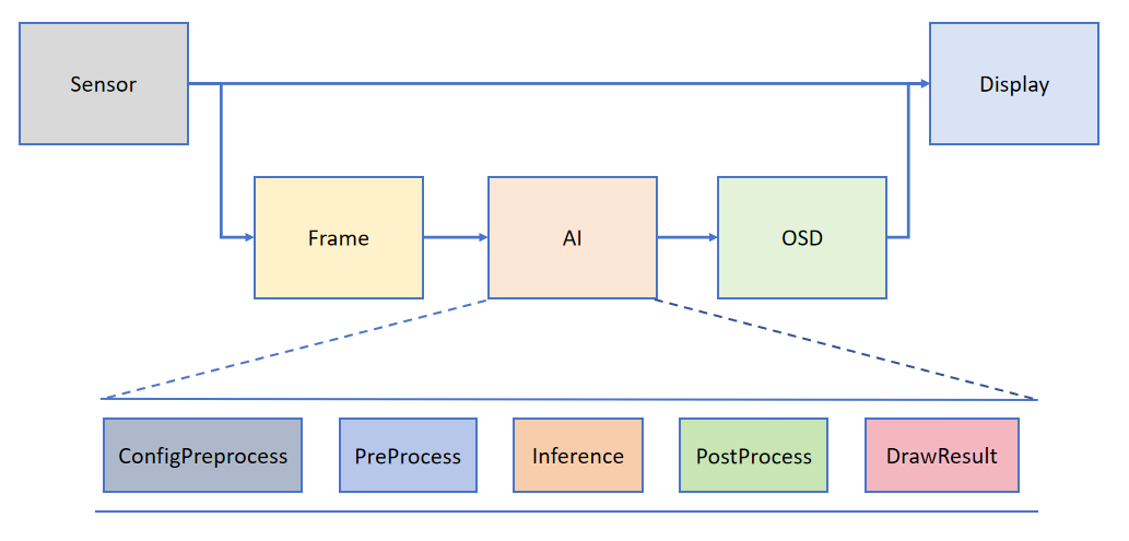

To help users simplify the development of AI components, we have built a supporting AI development framework based on the API interface provided by K230_CanMV. The framework structure is shown in the diagram below:
The Camera outputs two streams of images by default: one in YUV420SP format (Sensor.YUV420SP) is directly provided to the Display for display; the other in RGBP888 format (Sensor.RGBP888) is used for AI processing. The AI is mainly responsible for the pre-processing, inference, and post-processing workflow of tasks. After processing, the results are drawn on the OSD image instance and sent to the Display for overlay display.
The PipeLine process encapsulation mainly simplifies the development process of visual tasks. You can use ‘get_frame’ to get a frame for machine vision processing; if you want to customize the AI process, refer to face_detection. For audio-related AI, refer to the keyword_spotting and tts_zh examples in the demo.

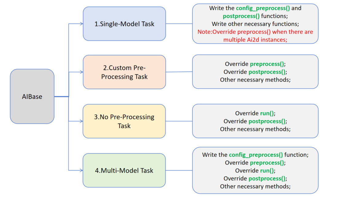

2.3.1. Overview#
Users can write custom task classes inheriting from AIBase according to specific AI scenarios. Tasks can be divided into four categories: single-model tasks, multi-model tasks, custom pre-processing tasks, and no pre-processing tasks. Different tasks require different code implementations, as shown in the diagram below:
Introduction to different tasks:
Task Type |
Task Description |
Code Description |
Single-Model Task |
This task has only one model, focusing on the model’s pre-processing, inference, and post-processing. Pre-processing uses Ai2d, possibly with one or multiple Ai2d instances. Post-processing is customized based on the scenario. |
Write a custom task class, focusing on config_preprocess, postprocess, and other methods like draw_result. If multiple Ai2d instances are used, override preprocess to set the computation process of pre-processing stages. |
Custom Pre-Processing Task |
This task has one model, focusing on pre-processing, inference, and post-processing. Pre-processing does not use Ai2d; it can be customized with ulab.numpy. Post-processing is customized based on the scenario. |
Write a custom task class, focusing on preprocess, postprocess, and other methods like draw_result. |
No Pre-Processing Task |
This task has one model and requires no pre-processing. Focus on inference and post-processing. Usually part of a multi-model task, using the output of the previous model as input. Post-processing is customized based on needs. |
Write a custom task class, focusing on run (the entire inference process, including preprocess, inference, postprocess), postprocess, and other methods like draw_results. |
Multi-Model Task |
This task includes multiple models, possibly in series or other combinations. Each model is essentially one of the first three types, unified in a complete task class. |
Write multiple sub-model task classes. Different sub-model tasks refer to the first three task definitions. Different tasks focus on different methods. Write a multi-model task class to unify sub-model task classes for the entire scenario. |

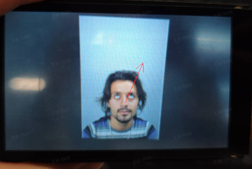

3.2 Gaze Estimation#
3.2.1 Demo Description#
Gaze estimation predicts the eye gaze direction based on facial features. This application uses a dual-model approach, first performing face detection, then predicting the gaze direction of the detected face, and marking it with an arrow on the screen.
3.2.2 Code#
Open the IDE, select File -> Open File, and choose the corresponding script according to the following path: This PC -> CanMV -> sdcard -> examples -> 05-AI-Demo -> eye_gaze.py. You can refer to the source code displayed in the IDE. Click the run button at the bottom left of the IDE to demonstrate the demo.
3.2.3 Demonstration Effect#
The original image is as follows:
Here, the demonstration effect is given using the 01studio LCD screen (800*480) as an example. Please change the display_mode in the __main__ function to lcd and run it. The HDMI effect is similar.

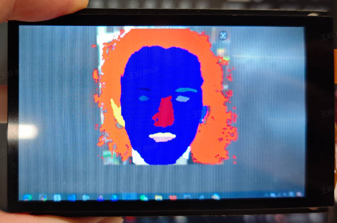

3.6 Face Parsing#
3.6.1 Demo Description#
Face parsing (also known as face segmentation) is a dual-model application. First, it performs face detection, then implements segmentation of different parts of the face. Face segmentation includes pixel-level classification of parts such as eyes, nose, and mouth, with different regions marked in different colors on the screen.
3.6.2 Code#
Open the IDE, select File -> Open File, and choose the corresponding script according to the following path: This PC -> CanMV -> sdcard -> examples -> 05-AI-Demo -> face_parse.py. You can refer to the source code displayed in the IDE. Click the run button at the bottom left of the IDE to demonstrate the demo.
3.6.3 Demonstration Effect#

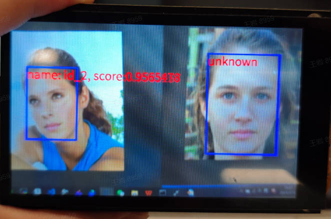

3.9 Face Recognition#
3.9.1 Demo Description#
The face recognition application performs face identity recognition on each frame of the video based on the information from face registration. If the recognized face is in the registration database, it labels the recognized face’s identity information; otherwise, it displays “unknown.”
3.9.2 Code#
Open the IDE, select File -> Open File, and choose the corresponding script according to the following path: This PC -> CanMV -> sdcard -> examples -> 05-AI-Demo -> face_recognition.py. You can refer to the source code displayed in the IDE. Click the run button at the bottom left of the IDE to demonstrate the demo.
3.9.3 Demonstration Effect#
The registered face original image is as follows:

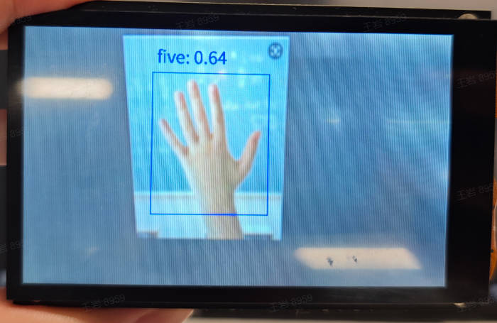

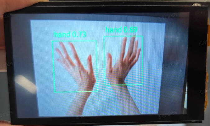

3.12 Palm Detection#
3.12.1 Demo Description#
The palm detection application detects the presence of palms in each frame of the video and marks the palm detection box on the screen.
3.12.2 Code#
Open the IDE, select File -> Open File, and choose the corresponding script according to the following path: This PC -> CanMV -> sdcard -> examples -> 05-AI-Demo -> hand_detection.py. You can refer to the source code displayed in the IDE. Click the run button at the bottom left of the IDE to demonstrate the demo.
3.12.3 Demonstration Effect#

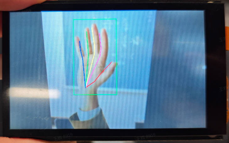

3.14 Palm Key Point Detection#
3.14.1 Demo Description#
Palm key point detection is a dual-model task. First, it detects the palm in each frame of the video, then performs key point regression on each detected palm to obtain the positions of 21 palm skeletal key points. These key points and their connections are displayed on the screen.
3.14.2 Code#
Open the IDE, select File -> Open File, and choose the corresponding script according to the following path: This PC -> CanMV -> sdcard -> examples -> 05-AI-Demo -> hand_keypoint_detection.py. You can refer to the source code displayed in the IDE. Click the run button at the bottom left of the IDE to demonstrate the demo.
3.14.3 Demonstration Effect#

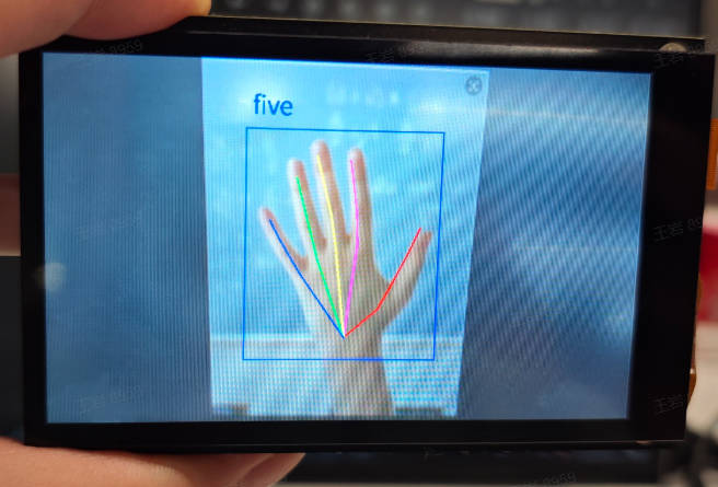

3.15 Gesture Recognition#
3.15.1 Demo Description#
The gesture recognition application is a classification-based task. First, it detects the palm in each frame of the video, then classifies the detected palm to recognize the gesture. This example supports three gestures as shown below.
3.15.2 Code#
Open the IDE, select File -> Open File, and choose the corresponding script according to the following path: This PC -> CanMV -> sdcard -> examples -> 05-AI-Demo -> hand_recognition.py. You can refer to the source code displayed in the IDE. Click the run button at the bottom left of the IDE to demonstrate the demo.
3.15.3 Demonstration Effect#

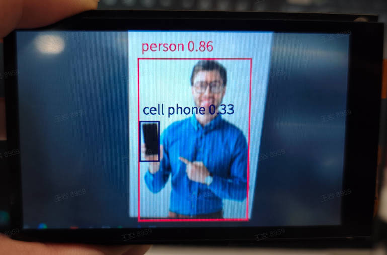

3.20 YOLOv8n Object Detection#
3.20.1 Demo Description#
The YOLOv8n object detection application uses the YOLOv8n model to detect 80 categories from the COCO dataset, and the detection results are marked on the screen with detection boxes.
3.20.2 Code#
Open the IDE, select File -> Open File, and choose the corresponding script according to the following path: This PC -> CanMV -> sdcard -> examples -> 05-AI-Demo -> object_detect_yolov8n.py. You can refer to the source code displayed in the IDE. Click the run button at the bottom left of the IDE to demonstrate the demo.
3.20.3 Demonstration Effect#

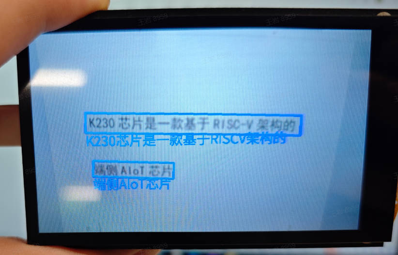

3.21 OCR Detection#
3.21.1 Demo Description#
The OCR detection application detects text appearing in the video, and the detection results are marked on the screen with detection boxes.
3.21.2 Code#
Open the IDE, select File -> Open File, and choose the corresponding script according to the following path: This PC -> CanMV -> sdcard -> examples -> 05-AI-Demo -> ocr_det.py. You can refer to the source code displayed in the IDE. Click the run button at the bottom left of the IDE to demonstrate the demo.

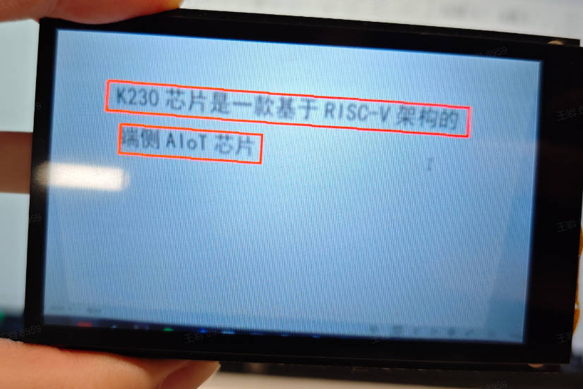

3.21.3 Demonstration Effect#
3.22 OCR Recognition#
3.22.1 Demo Description#
The OCR recognition application is a dual-model task. First, it detects text in each frame of the video, then recognizes the detected text, and finally marks the detection box on the screen and adds the recognized text content near the detection box.
3.22.2 Code#
Open the IDE, select File -> Open File, and choose the corresponding script according to the following path: This PC -> CanMV -> sdcard -> examples -> 05-AI-Demo -> ocr_rec.py. You can refer to the source code displayed in the IDE. Click the run button at the bottom left of the IDE to demonstrate the demo.
3.22.3 Demonstration Effect#

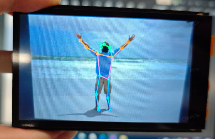

3.24 Human Key Point Detection#
3.24.1 Demo Description#
The human key point detection application uses the YOLOv8n-pose model to detect human poses, resulting in the positions of 17 human skeletal key points, which are connected with lines of different colors and displayed on the screen.
3.24.2 Code#
Open the IDE, select File -> Open File, and choose the corresponding script according to the following path: This PC -> CanMV -> sdcard -> examples -> 05-AI-Demo -> person_keypoint_detect.py. You can refer to the source code displayed in the IDE. Click the run button at the bottom left of the IDE to demonstrate the demo.
3.24.3 Demonstration Effect#

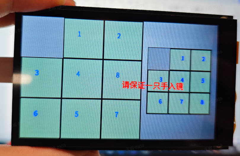

3.25 Puzzle Game#
3.25.1 Demo Description#
The puzzle game is a hand-based fun game. When the application starts, ensure there are no palms in the camera range and wait for the screen to initialize. On the left is a randomly scrambled puzzle, and on the right is the target puzzle. When a palm enters, open the thumb and middle finger. The yellow dot between the fingers is used to locate the moving block. Quickly pinch the two fingers together and then open them again. The yellow dot turns blue, and the corresponding block moves to the adjacent empty space.
3.25.2 Code#
Open the IDE, select File -> Open File, and choose the corresponding script according to the following path: This PC -> CanMV -> sdcard -> examples -> 05-AI-Demo -> puzzle_game.py. You can refer to the source code displayed in the IDE. Click the run button at the bottom left of the IDE to demonstrate the demo.
3.25.3 Demonstration Effect#
Here, the demonstration effect is given using the 01studio LCD screen (800*480) as an example. Please change the display_mode in the __main__ function to lcd and run it. The HDMI effect is similar. Keep a certain distance from the camera, open the thumb and middle finger, and pinch the thumb and middle finger around the empty block. The empty block and the current block will swap positions.

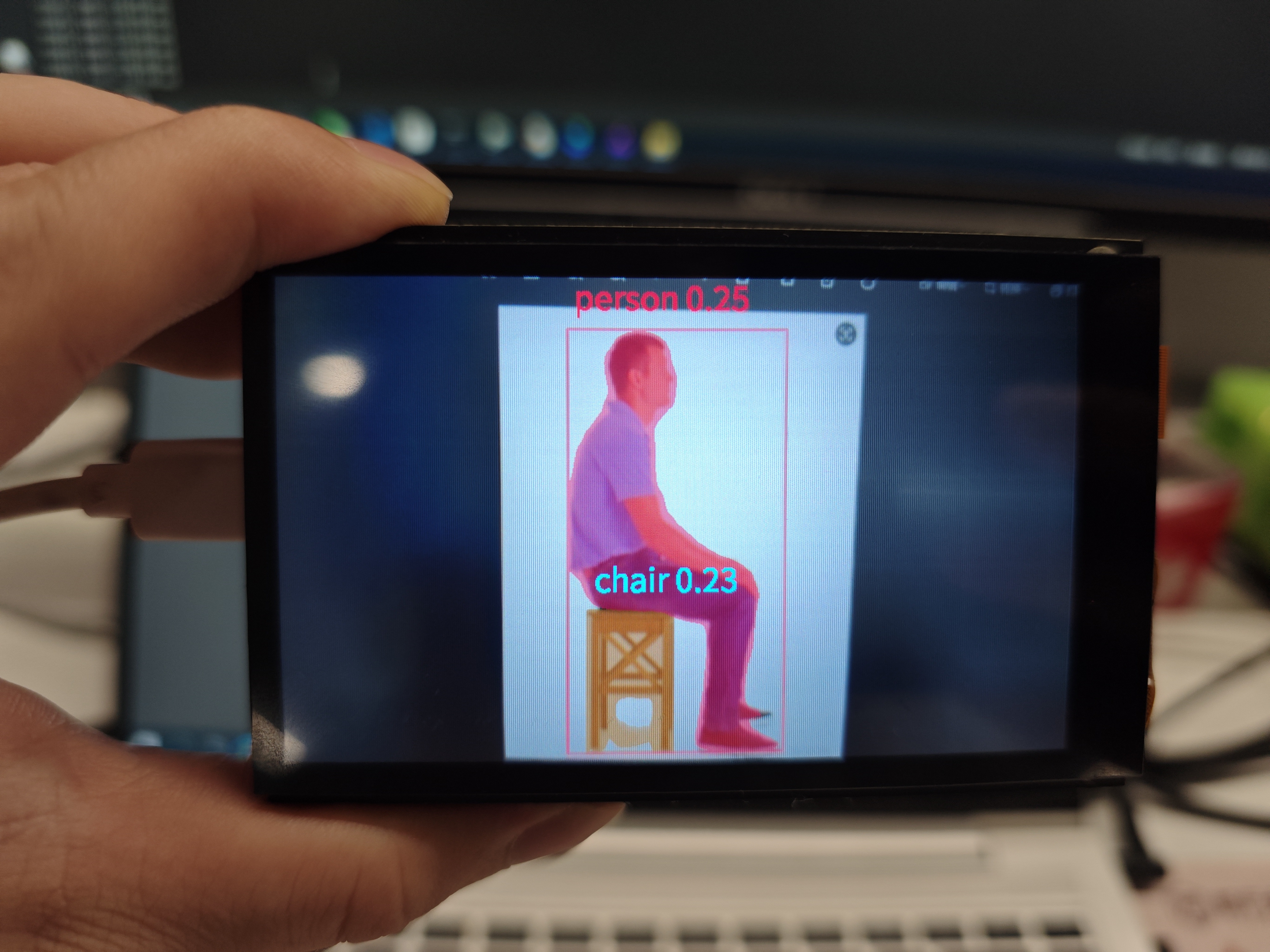

3.26 YOLOv8n Segmentation#
3.26.1 Demo Description#
The YOLOv8n segmentation application uses the YOLOv8n model to segment objects from 80 categories of the COCO dataset appearing in the video, displaying them as a mask on the screen.
3.26.2 Code#
Open the IDE, select File -> Open File, and choose the corresponding script according to the following path: This PC -> CanMV -> sdcard -> examples -> 05-AI-Demo -> segment_yolov8n.py. You can refer to the source code displayed in the IDE. Click the run button at the bottom left of the IDE to demonstrate the demo.
3.26.3 Demonstration Effect#

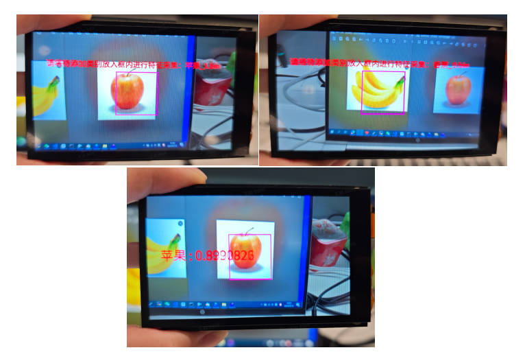

3.27 Self-Learning#
3.27.1 Demo Description#
Self-learning is a feature-based classification method. First, set the labels in the code and specify the names of the items to be collected. Then start the application and place the items to be collected in the feature collection box as prompted on the screen. Once feature collection is complete, it automatically enters recognition mode. Place the item to be recognized in the collection box, and it will be compared with the registered items for feature comparison, completing classification based on similarity.
3.27.2 Code#
Open the IDE, select File -> Open File, and choose the corresponding script according to the following path: This PC -> CanMV -> sdcard -> examples -> 05-AI-Demo -> self_learning.py. You can refer to the source code displayed in the IDE. Click the run button at the bottom left of the IDE to demonstrate the demo.
3.27.3 Demonstration Effect#
The images of the apple and banana to be learned are as follows:
Here, the demonstration effect is given using the 01studio LCD screen (800*480) as an example. Please change the display_mode in the __main__ function to lcd and run it. The HDMI effect is similar. Follow the screen prompts to place the apple and banana in the box for learning, then automatically enter recognition mode. The object in the box will be recognized as an apple or banana, and a similarity score will be given.
