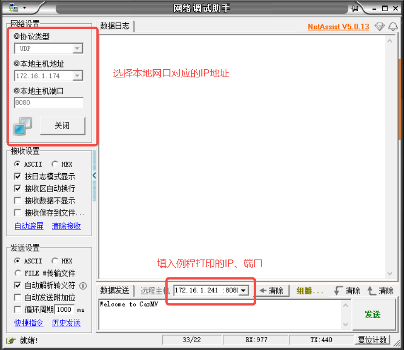

3. Example Phenomenon and Operation Instructions#

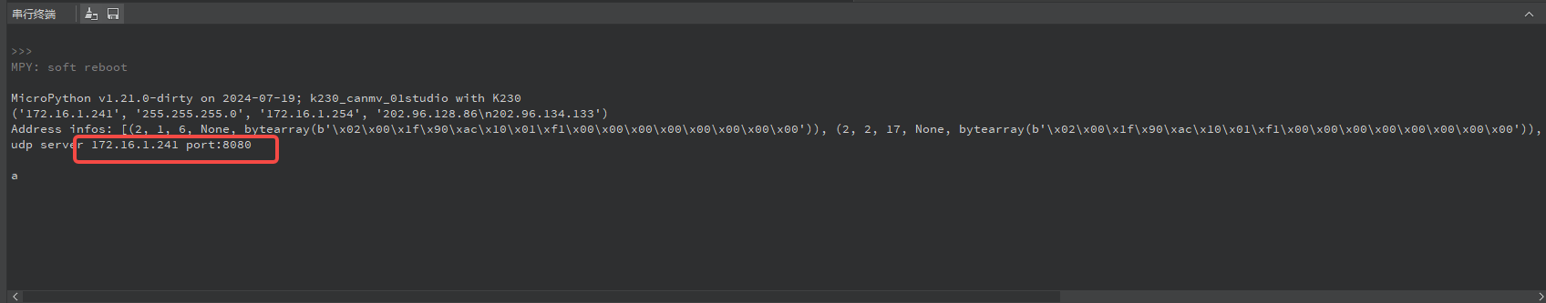

After running the code, the serial terminal will output the server’s IP address and port number information:
In the network debugging assistant, select UDP and configure the connection parameters:

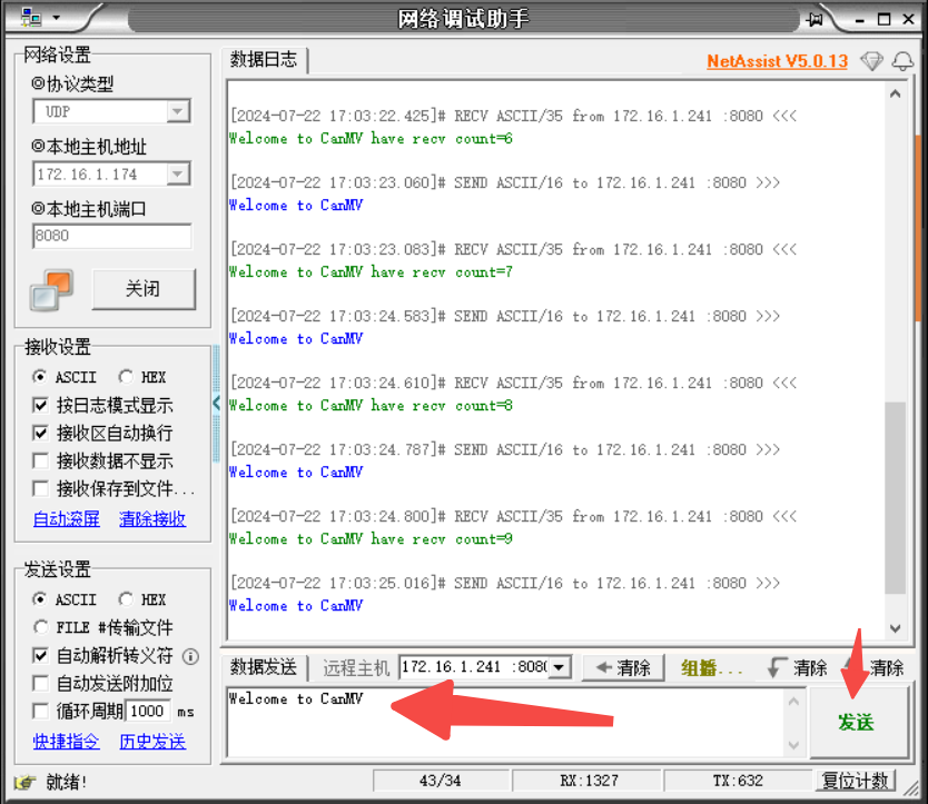

Send data and observe the server’s response:
