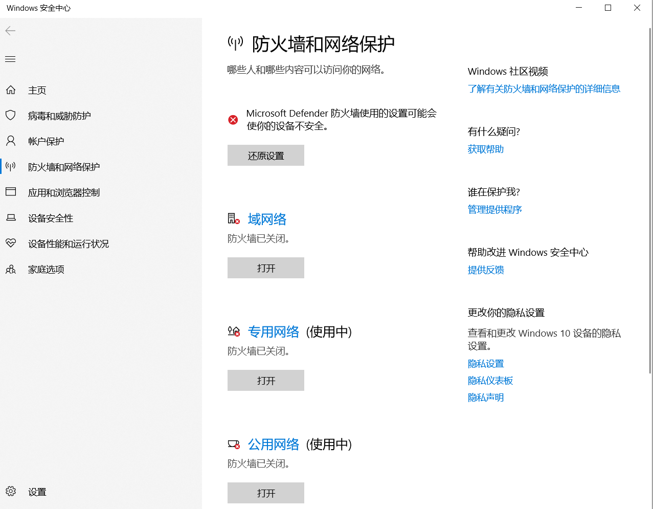

1.2 Disable Firewall#
To avoid the firewall blocking TCP communication, it is recommended to temporarily disable the firewall on your computer.

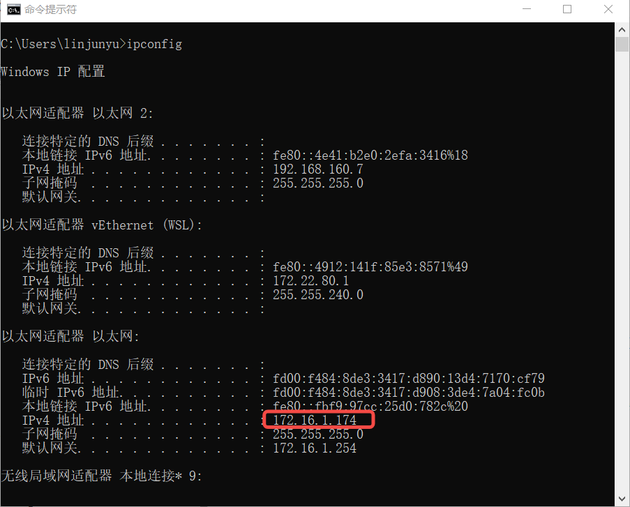

1.4 Obtain IP Address#
Open the Command Prompt (CMD), enter
ipconfig, and query and record the IP address of the computer’s network card for subsequent configuration and testing.

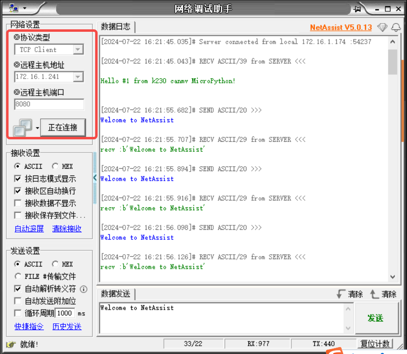

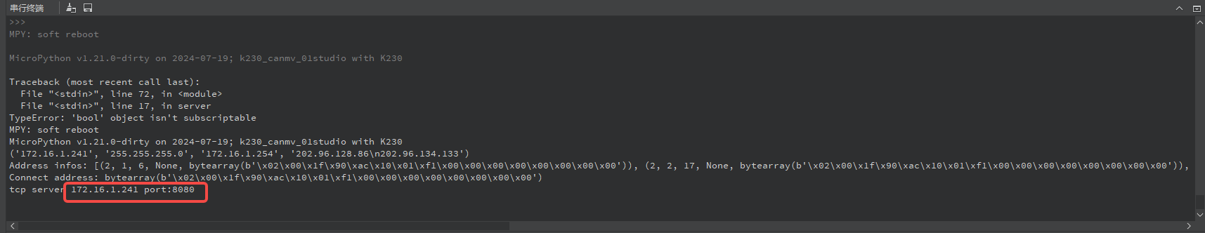

Run the above server code and observe that the serial terminal will print the server’s IP address and port number.
Open NetAssist Network Debugging Assistant, configure it as a TCP client, and enter the IP address and port number displayed by the server terminal, then click “Connect”:
After a successful connection, the client will receive a message from the server.
