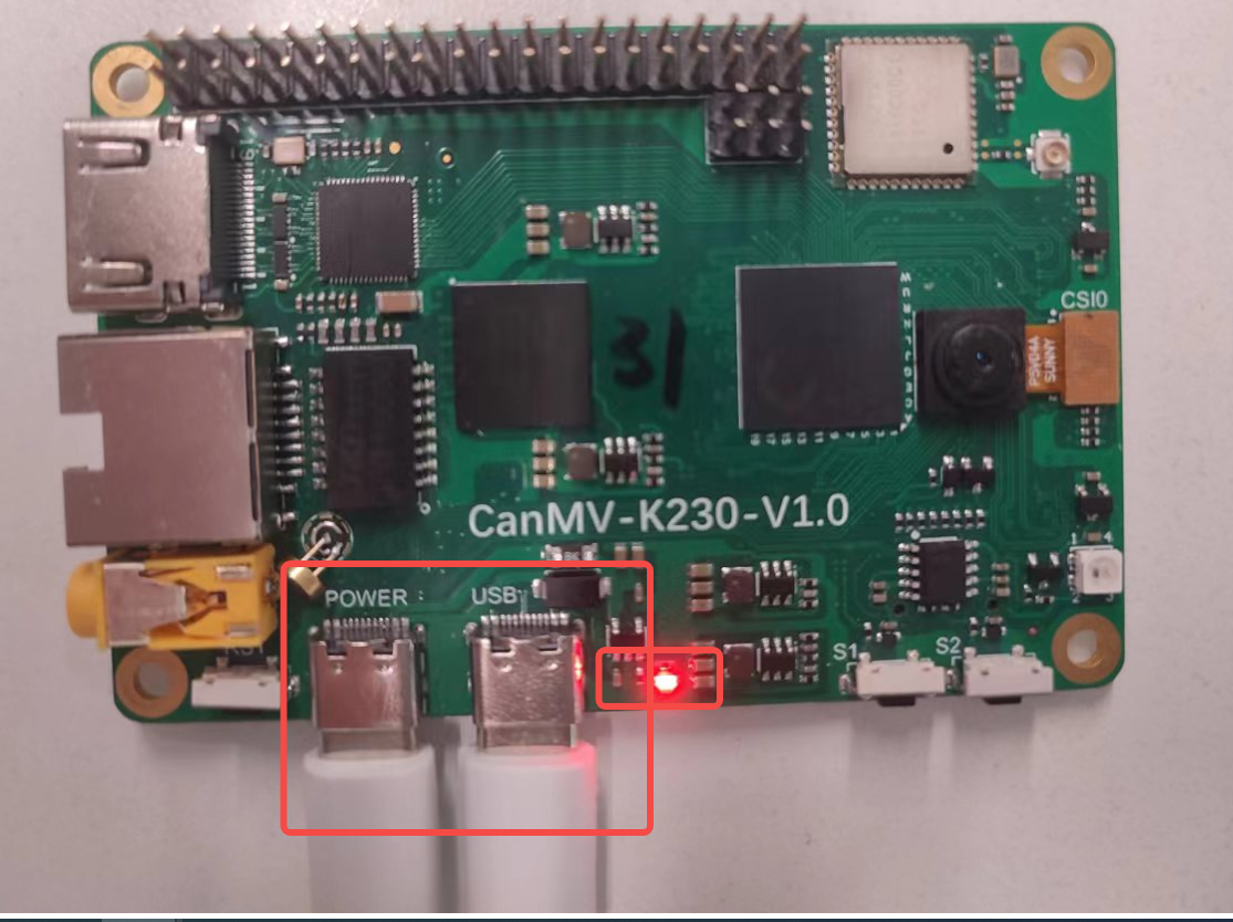

3. Usage Notes#
When using the CanMV-K230 development board, two USB data cables need to be connected simultaneously#
