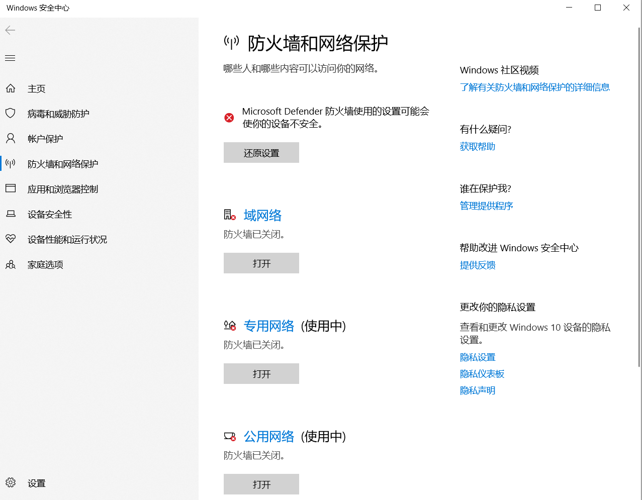

1.2 Disable Firewall#
To avoid the firewall blocking TCP communication, it is recommended to temporarily disable the computer’s firewall.

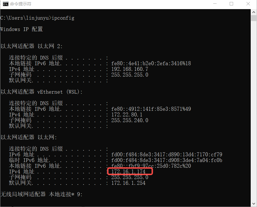

1.4 Obtain IP Address#
Open the Command Prompt (CMD), enter
ipconfig, and query and record the IP address of the computer’s network card for subsequent configuration and testing.

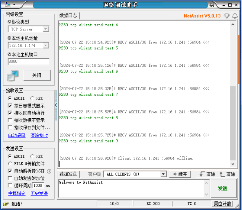

3. Running Results and Operation Instructions#

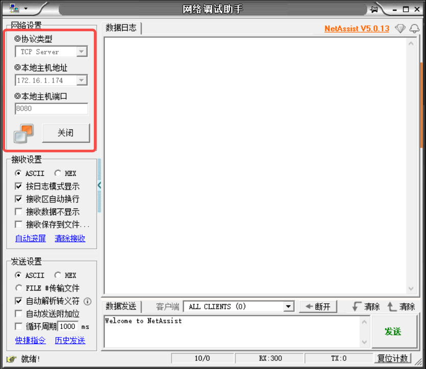

Open the NetAssist Network Debugging Assistant, configure it as a TCP server, and wait for the connection:
Modify the server’s IP and port number in the code:
Run the client code, and NetAssist will display the messages sent by the client:
