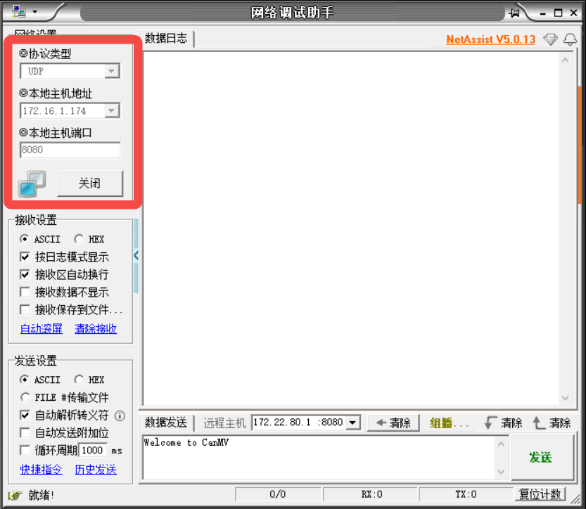

Use NetAssist Network Debugging Assistant to establish a UDP connection:
Modify the server IP address in the code:

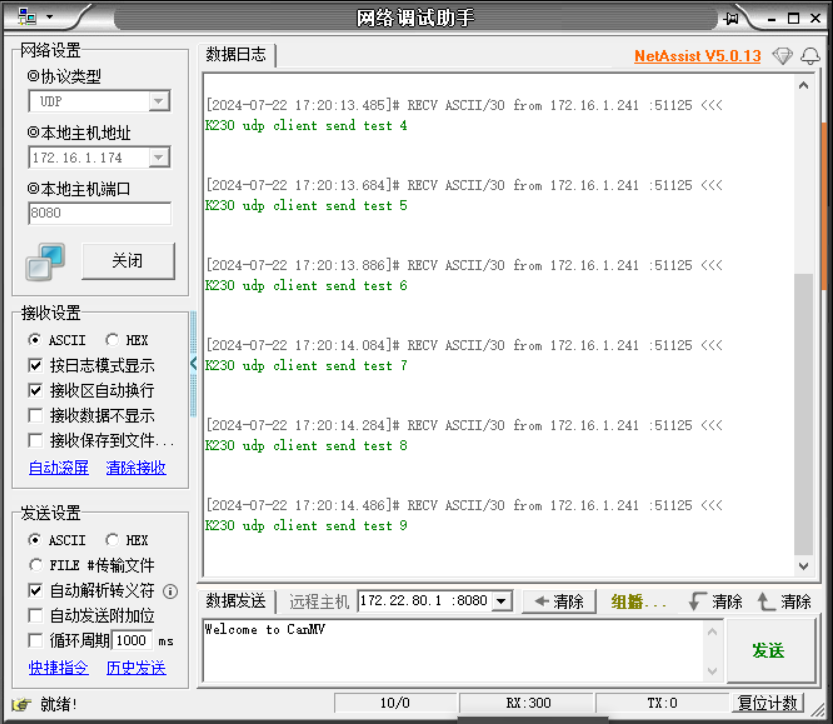

After running the example, NetAssist will display the received UDP packets:
