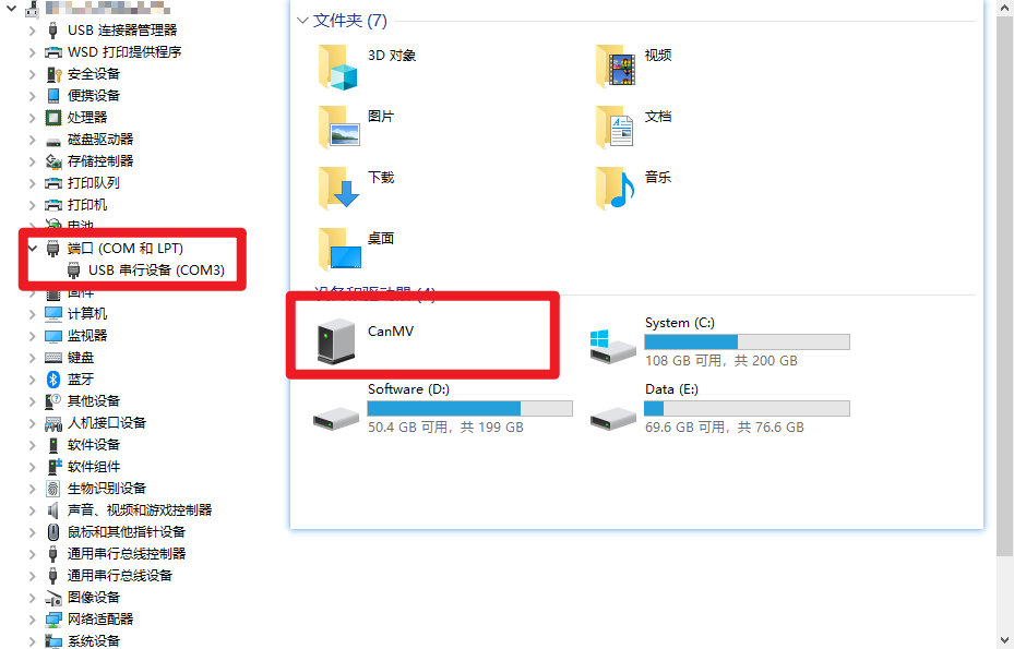

4.1 Viewing Devices on Windows System#
Open the Device Manager, and you will see the following devices:
The USB Serial Device (COM3) is the REPL serial port for Micropython, which is the interface that CanMV-IDE needs to connect to. Please ensure that the firmware file you flashed starts with “CanMV-K230_micropython”.

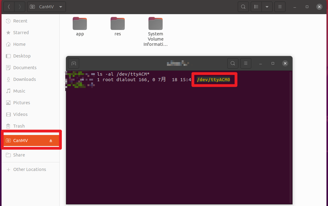

4.2 Viewing Devices on Linux System#
On a Linux system, the serial port device will appear as:
/dev/ttyACM0is the REPL serial port for Micropython, which is also the interface that CanMV-IDE needs to connect to. Please ensure that the firmware file you flashed starts with “CanMV-K230_micropython”.
