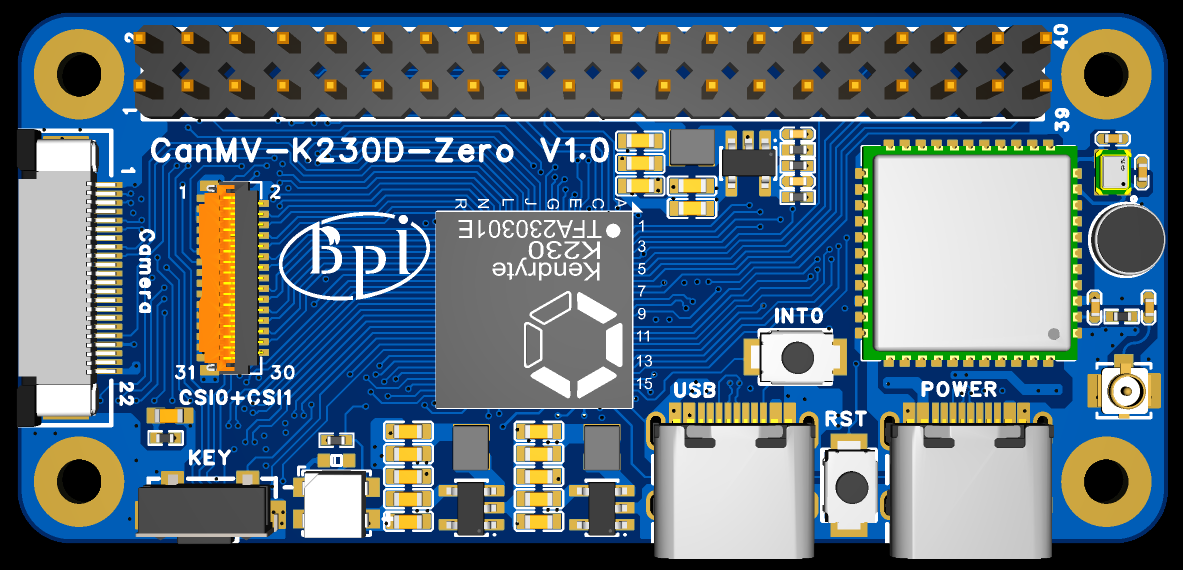

Development Board |
Photo |
Description |
Based on K230, with external 512MB LPDDR for larger memory |
Based on K230D, with built-in 128MB LPDDR4, compact size |
