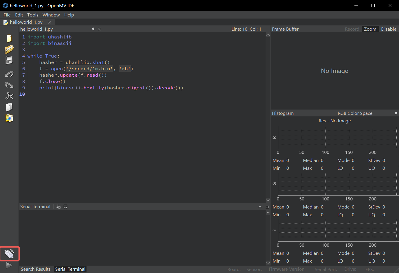

Users can also opt to use the OpenMV IDE, but please note that OpenMV IDE only supports connecting to the K230 and cannot connect to the K210. Using OpenMV IDE version 4.0 and above can achieve a higher image display frame rate.

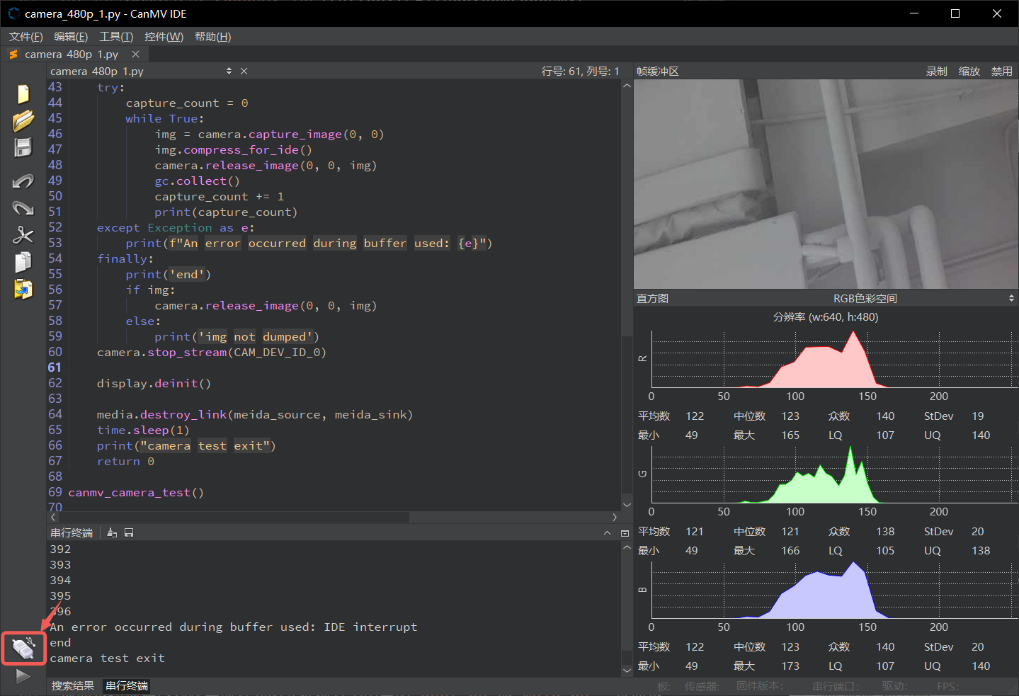

2. Connecting the Development Board#
Connect the development board to your computer via a USB interface, open CanMV IDE, and click the “Connect” button at the bottom left of the interface. Wait for the IDE to complete the connection with the development board.
If using OpenMV IDE, the operation is the same; simply click the “Connect” button at the bottom left.

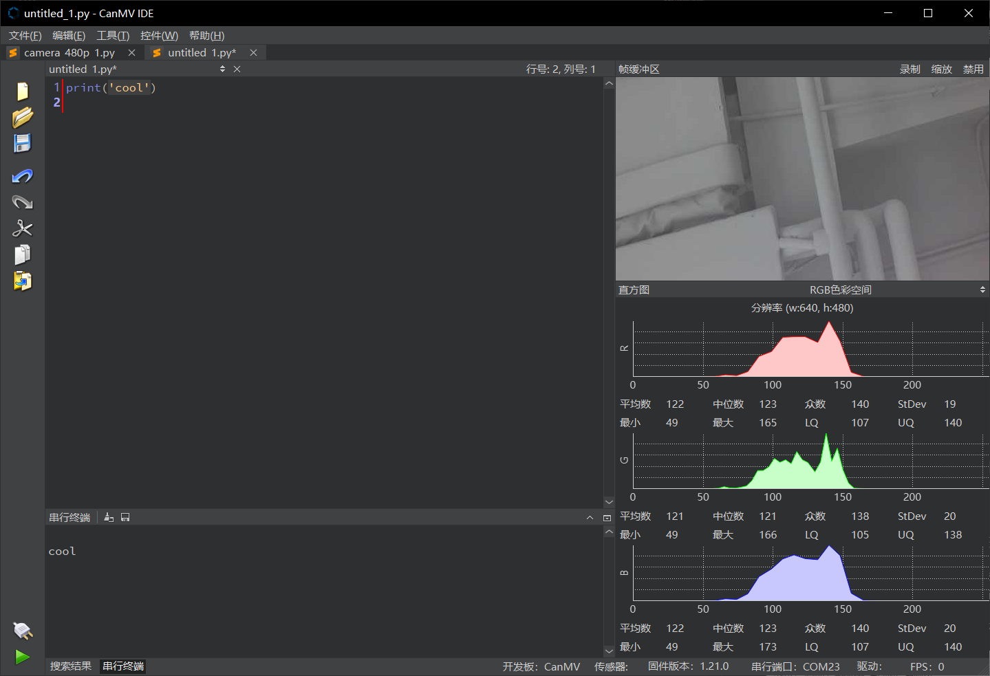

3. Running Python Code#
Before running the code, you first need to open a code file in the editor. Once the file is open, click the “Run” button at the bottom left to run the current file. For example, when running the print('cool') code, the output cool will be displayed in the serial terminal.

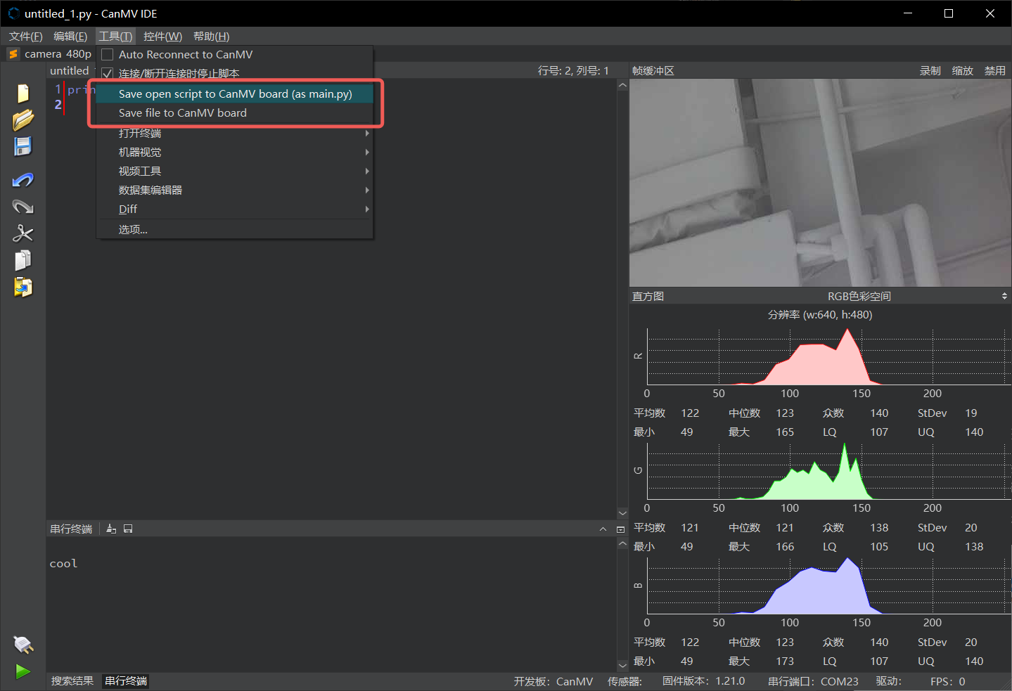

4. Saving Code and Files to the Development Board#
To save code or files to the development board, you can click on the Tools option in the menu bar. This option provides two saving methods:
Save As main.py: Save the currently open script file as main.py, which will automatically run when CanMV starts.
Save File to CanMV Cam: Save the specified file to a specific path on the development board. Note that since only the SD card path is readable and writable on the development board, the file will be saved to
/sdcard/<specified path>.

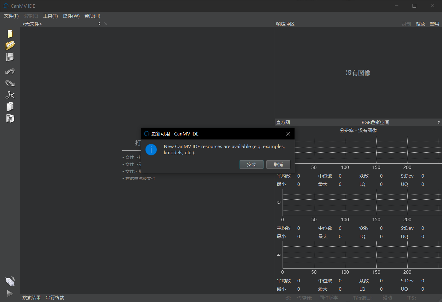

6. Updating Resources#
When new resources (such as sample code or kmodel files) are available, CanMV IDE will prompt for an update with a dialog box at startup. Click the “Install” button to complete the update.
