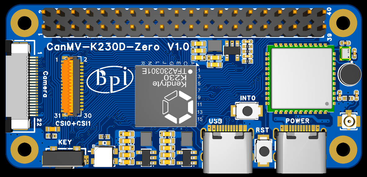

BPI-K230D-ZERO
Bpi-K230D-Zero
Based on K230D, with built-in 128MB LPDDR4, compact size
