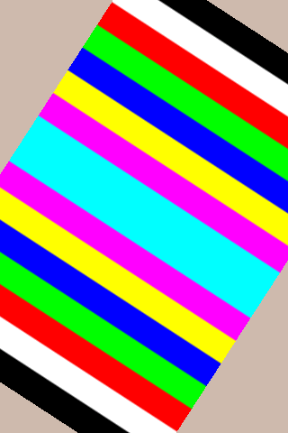

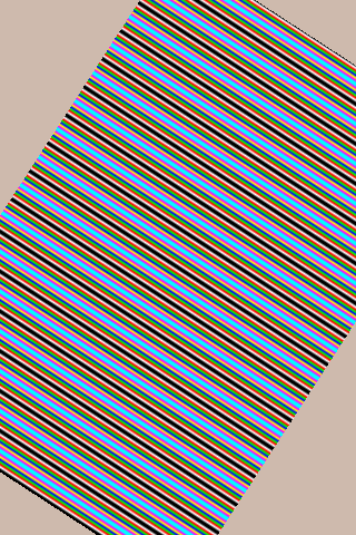

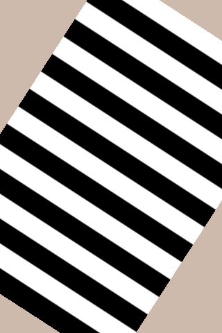

imgIndex#
This is an example using a color lookup table. After running, it generates imgIndex1.png, imgIndex2.png, imgIndex4.png, and imgIndex8.png in the current directory, each using a different number of color indices.
