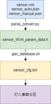

The production flowchart is as follows:
isp param
Figure 2-1 Parameter Partition Production Flowchart
The production steps are as follows:

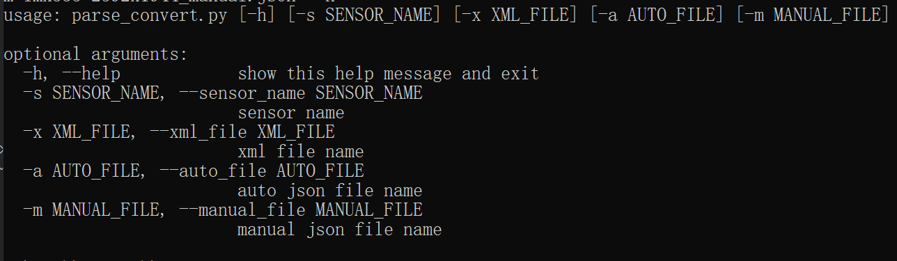

Execute the conversion header file tool parse_convert.py, parse and convert the three copied configuration files into a parameter header file (it is recommended to use python3.x for the conversion tool)
parse_convert

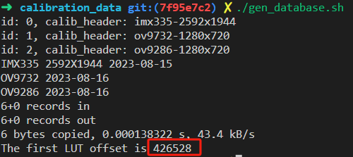

has_lut: Indicates whether there is a dewarp LUT file. Setting this member to 0 means that dewarp parameters are not needed. Setting it to 1 means that dewarp parameters are needed.
lut_offset: When has_lut is set to 1, this member is effective. The value corresponds to the offset of the dewarp parameter in the parameter partition. The specific calculation method is parameter partition base address + header size + parameter structure size + padding size. The parameter partition base address is defined as CONFIG_MEM_SENSOR_CFG_BASE in k_autoconf_comm.h. This definition varies with different compiled hardware. It can be calculated by the gen_database.sh script provided by the SDK. The execution will print the result:
calc_isp_param_data_size
Figure 2-2 Parameter Partition Automatically Calculates Dewarp Offset

The SDK provides a semi-automated script gen_database.sh that links processes 2.2.2.1 - 2.2.2.5. After completing the source code definitions for header, dewarp, and parameter parsing, users can execute this script to produce the binary file, or even compile the SDK directly without manually executing the script.
