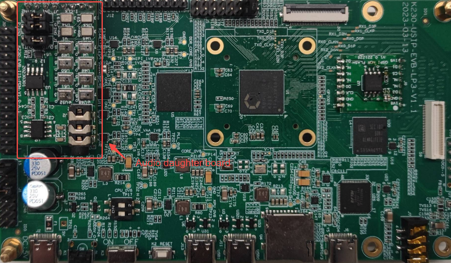

  • Audio daughter board (required when using external audio path), as shown in the figure below, pay attention to the installation position and jumper cap connection. When using PDM audio transmission interface and external I2S audio transmission interface, you need to use an audio daughter board; only the built-in I2S audio transmission interface does not need an audio daughter board.
    image-20230703161821233

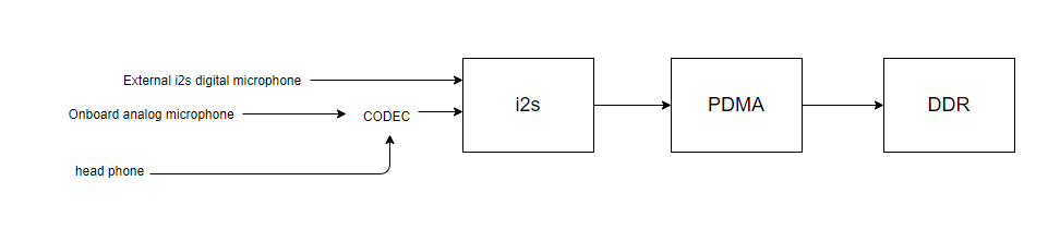

Audio capture supports two audio transmission interfaces: I2S and PDM. I2S audio acquisition supports two groups and can work at the same time, and PDM audio capture supports four groups and can work at the same time.
I2S audio acquisition: supports two groups, of which the first group can be selected as a built-in or external path, and the second group is fixed as an external path. When the first set is used as a built-in path, the left channel sound is the headphone linear analog input, the right channel sound is the on-board analog microphone input, and when set to mono operating mode, the sound is fixed as the on-board analog microphone input. When used as an external path, the left and right channel sounds are digital microphone inputs on the daughter board.
image-20230704100947965

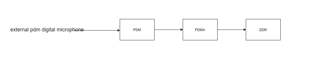

PDM audio acquisition: external daughter board is required, a total of four groups are supported, and it can work at the same time. Each group supports single/dual channel acquisition, and each channel sound is a digital microphone input on the daughter board.
image-20230704101309168

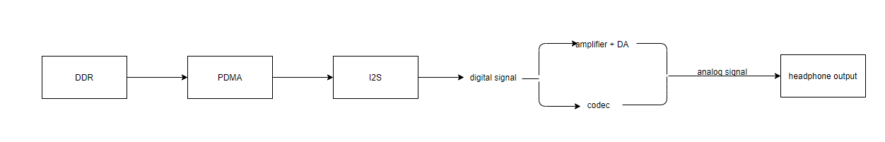

Audio playback supports I2S audio transmission interface. I2S audio capture supports two groups and can work simultaneously. The first group can be selected as an internal or external path, and the second group is fixed as an external path. When the first set is used as a built-in path, the sound output is the on-board headphone output, and when using the external path, the sound output is the daughter board headphone output.
image-20230704104012443
