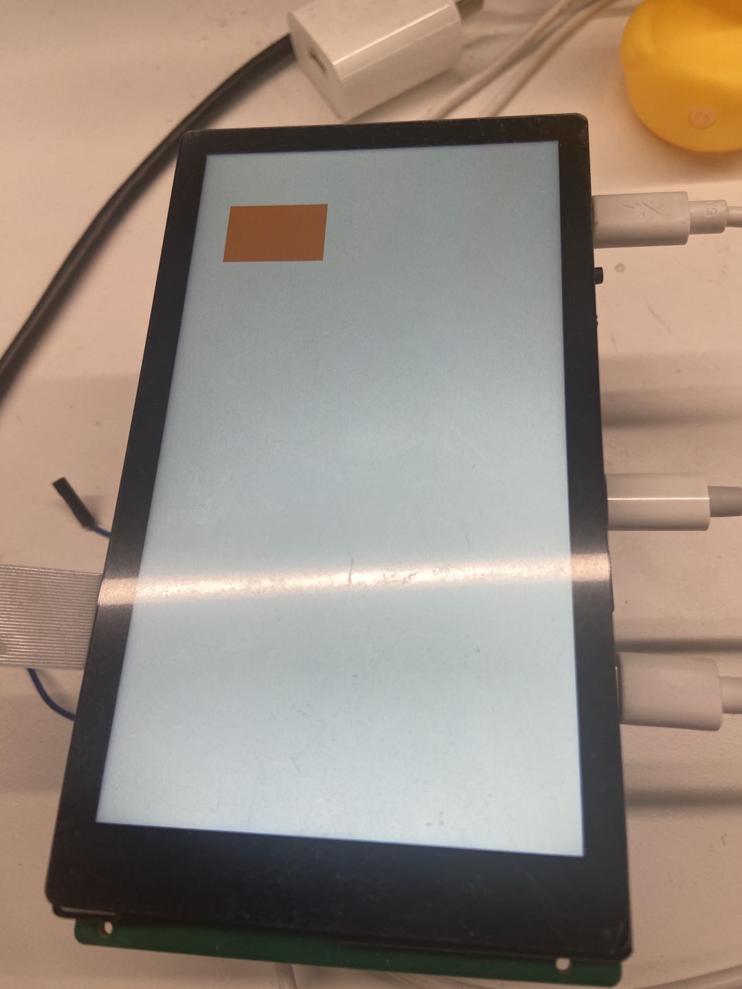

The K230 EVB has a 1080x1920 display. On the small-core Linux, DRM can be used for display. Letting the GPU driver load the DRM dumb buffer can reduce memory copying and achieve efficient rendering. The GPU+DRM related code can be referred to in the vglite_drm demo. Readers can add drm.c to their programs.
Note that as of K230 SDK v0.8, the DRM driver on Linux cannot work independently and relies on the configuration of the SoC video output module by the large core. This can be done by executing sample_vo.elf 3 on the large core.
Additionally, the color format enumeration of DRM does not completely match vg_lite_buffer_format_t. For example, VGLITE_BGRA8888 represents a 32-bit color with red in the lowest 8 bits and alpha in the highest 8 bits, corresponding to DRM_FORMAT_ARGB8888 in DRM.
vglite_drm demo result
The image above shows the correct color displayed on the screen after running the vglite_drm demo: R(255)G(128)B(16).
Generally, to achieve synchronized display, two buffers are needed for ping-pong alternating display. However, to simplify the demonstration code, only one buffer is used here. Readers can implement double buffering with vertical synchronization for continuous rendering.

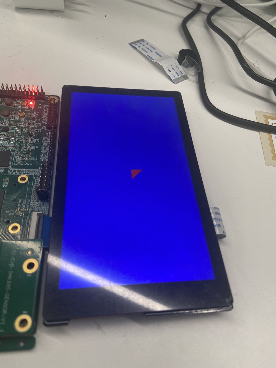

The complete reference code can be found in vglite_drm, and the result of the drawing is shown below.
Simple drawn triangle
It is easy to see that the coordinate system has the positive x direction to the right and the positive y direction downward, which is also the coordinate system used by SVG.

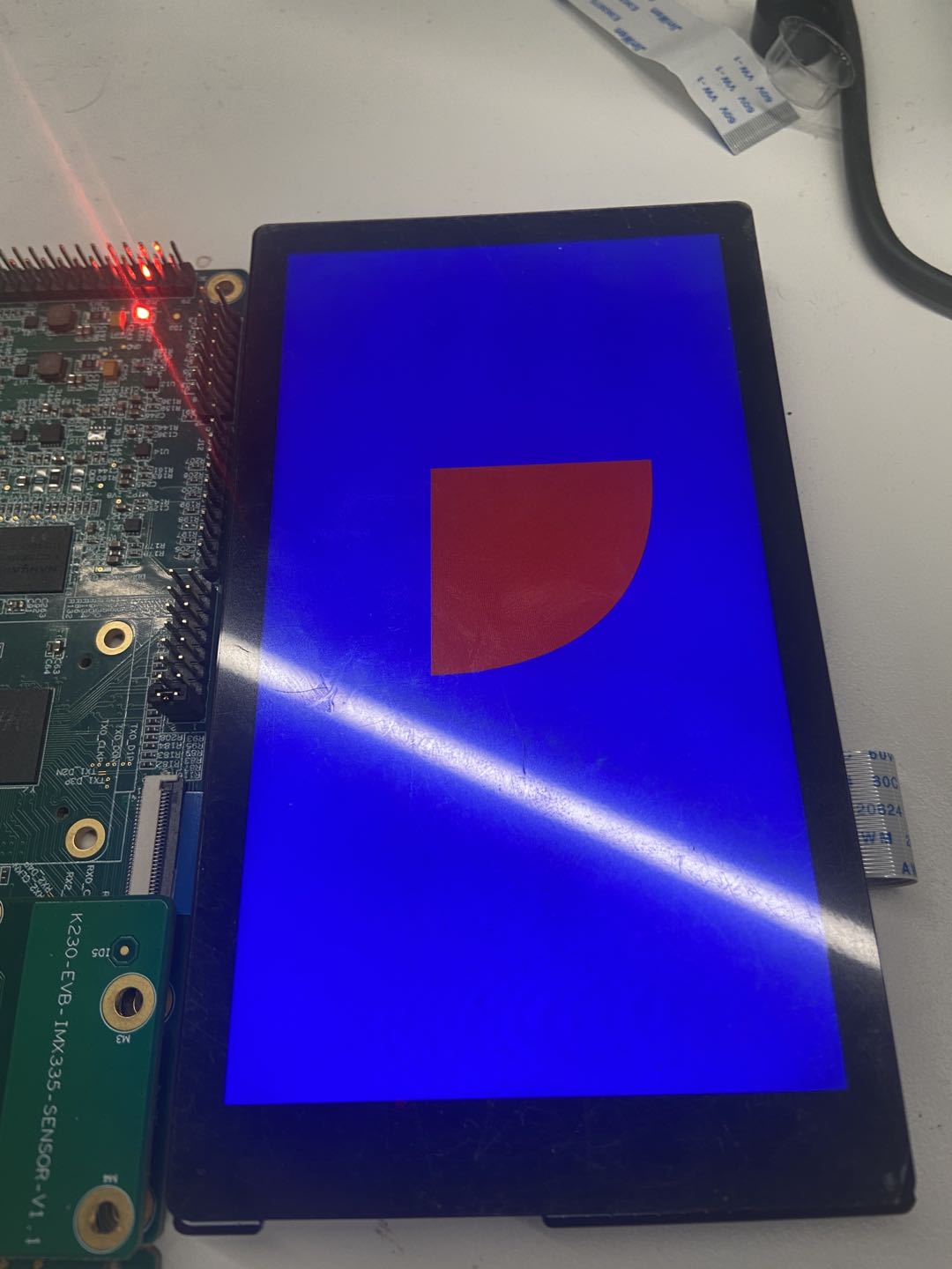

Let’s try changing the bottom edge of the previously drawn triangle to a quadratic Bézier curve, with the midpoint at (1,1), to draw a shape resembling a rounded corner. Modify the path_data as follows:
uint8_t path_data[] = {
    2, 0, 0,
    4, 0, 1,
    6, 1, 1, 1, 0, // Quadratic Bézier curve, control point (1,1), draw to (1,0)
    4, 0, 0,
To better observe this curve, increase the scaling factor, say to 500 times, and adjust the translation to approximately center the shape on the screen.
The final drawn shape looks like this:
Approximate rounded sector
