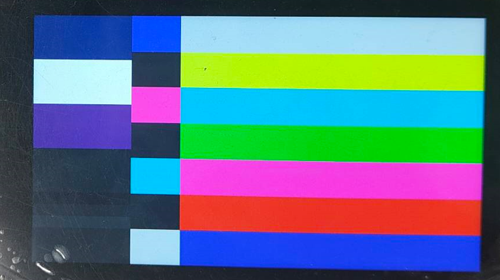

The 2.2 video layer outputs smpte color bars with NV12 color space#
The specific instructions are as follows:
The following figure shows the LCD display:
Display content

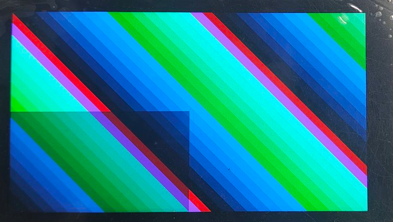

The OSD layer outputs tiles color bars, and the color space is AR24(ARGB8888)#
modetest -M canaan-drm -D 0 -a -s 38@36:1080x1920-30 -P 32@36:1080x1920@AR24 -v -F tiles
Display content

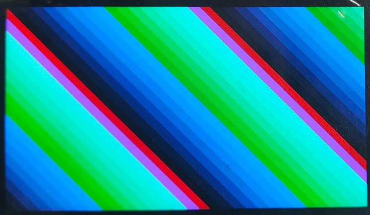

OSD layer outputs tiles color bars with a color space of RG16(RGB565)#
modetest -M canaan-drm -D 0 -a -s 38@36:1080x1920-30 -P 32@36:1080x1920@RG16 -v -F tiles
Display content
