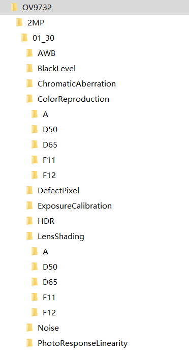

Creating Folders for Calibration Parameter Files#
Please follow the steps below to create folders for each resolution:
  1. Create a folder using the sensor name (e.g., /OV9732)
  2. Create a folder using the lens name (e.g., /2MP)
  3. Create a folder using the sample name (e.g., /01_30)
  4. Create subfolders for each calibration function (as shown in the figure below)
    Create folders
  5. Copy the calibration parameter files into the corresponding parameter folders
For each resolution, an example is as follows:
  • sensor
    • lens
      • sample
        • AWB
          • AWB parameters.txt
          • AWB parameters.mat
        • BlackLevel
          • BLS parameters.txt

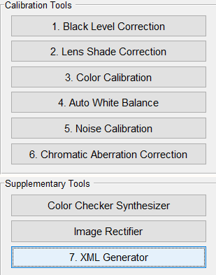

After copying all calibration parameter files into the corresponding folders, open the K230 ISP Calibration Tool and use it to generate the xml file.
As shown in the figure below, click the “7. XML Generator” button on the main interface:

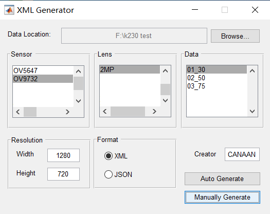

The “XML Generator” dialog box will pop up as shown in the figure below:
Select XML File Generation
In the “Data Location” field, select the correct calibration directory address, select the created sensor folder in the “Sensor” field, select the created lens folder in the “Lens” field, and select the created sample folder in the “Data” field.
Enter the correct Width and Height of the image in the “Resolution” field, select “XML” in the “Format” field, enter the creator’s name in the “Creator” field, and then click “Manually Generate” to generate the “XML” subdirectory under the selected lens folder, where the .xml file will be generated.

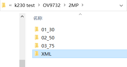

XML Folder
Rename the generated xml file according to the xml name input in the K230 SDK code (e.g., ov9732-1280x720.xml), and place it in the config directory to be correctly called by the K230 SDK.
