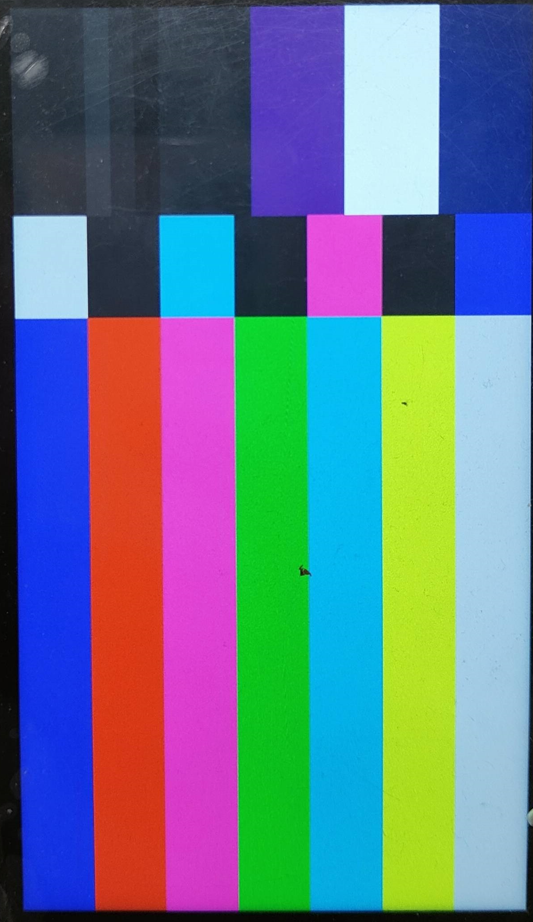

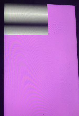

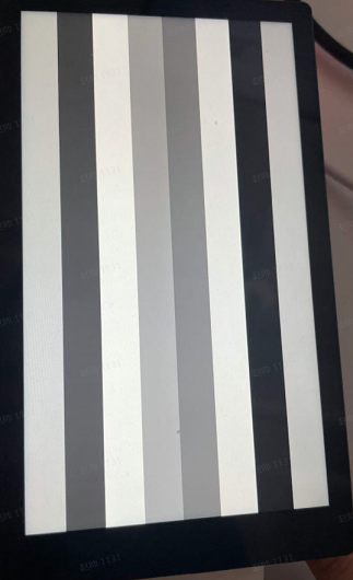

To run the DSI self-test mode demo:
./sample_vo.elf 2
A color bar image will be displayed on the screen, as shown below:
Auto-generated background pattern description

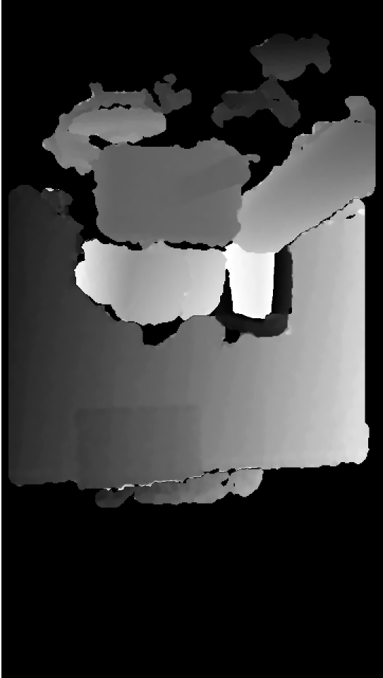

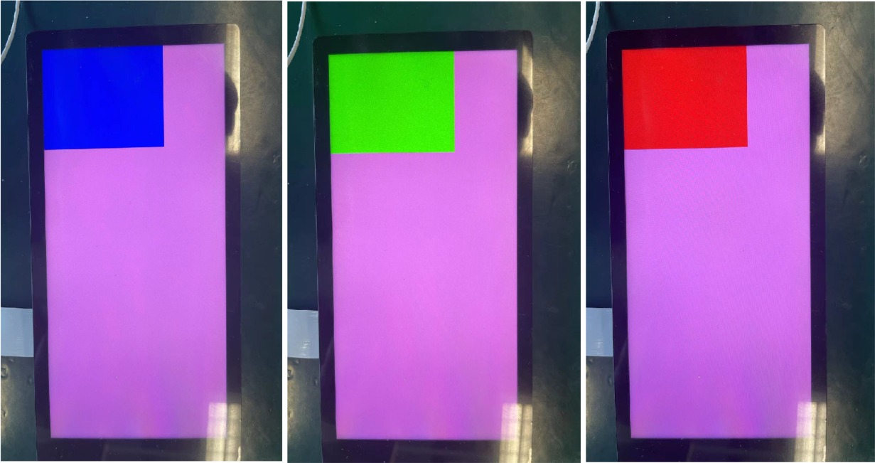

  1. To run the VO and VVI binding demo:
    ./sample_vo.elf 9
    Press Enter once to start sending ARGB data from VVI, press Enter again to exit the program. The display effect alternates between red, green, and blue primary colors, as shown below:
    Image description

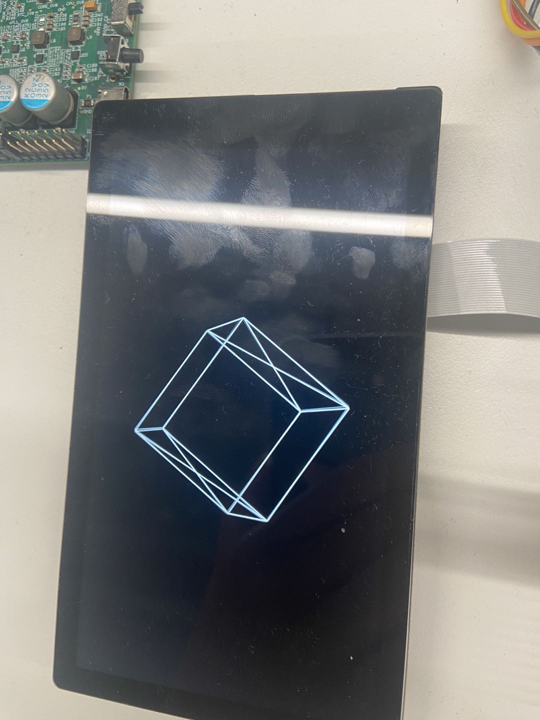

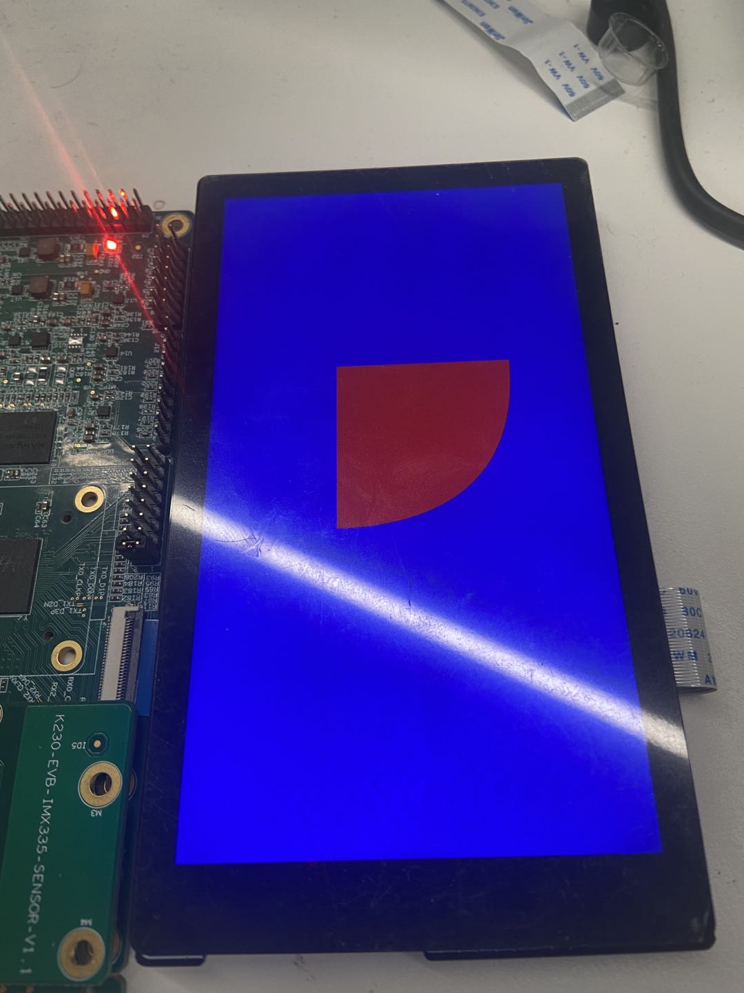

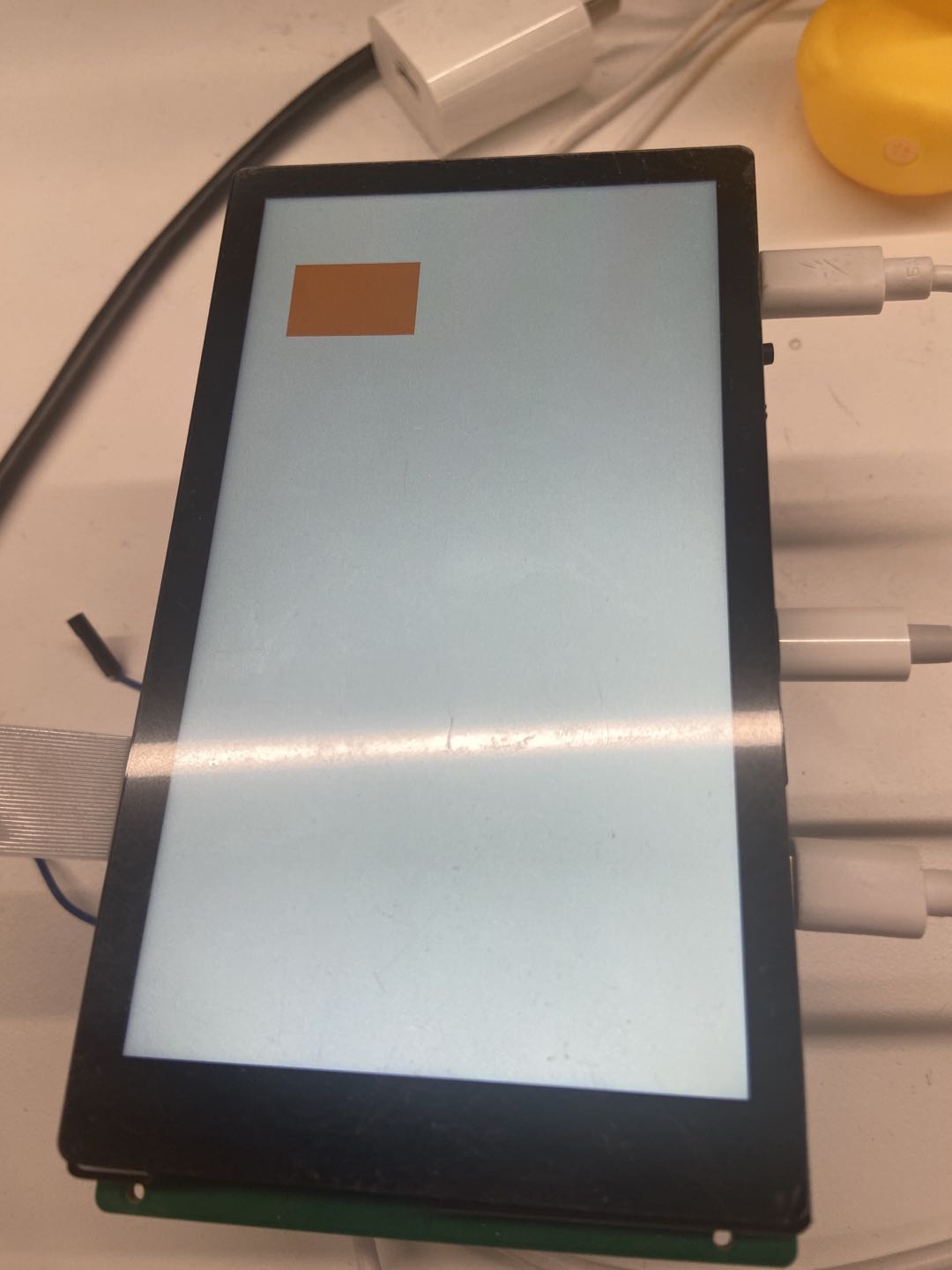

  2. To run the VO layer frame insertion demo:
    ./sample_vo.elf 7
    After executing the command, press Enter once to insert an image from the user layer, press Enter again to exit the program. The display effect is as follows:
    Image description

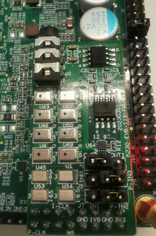

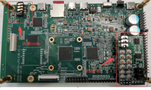

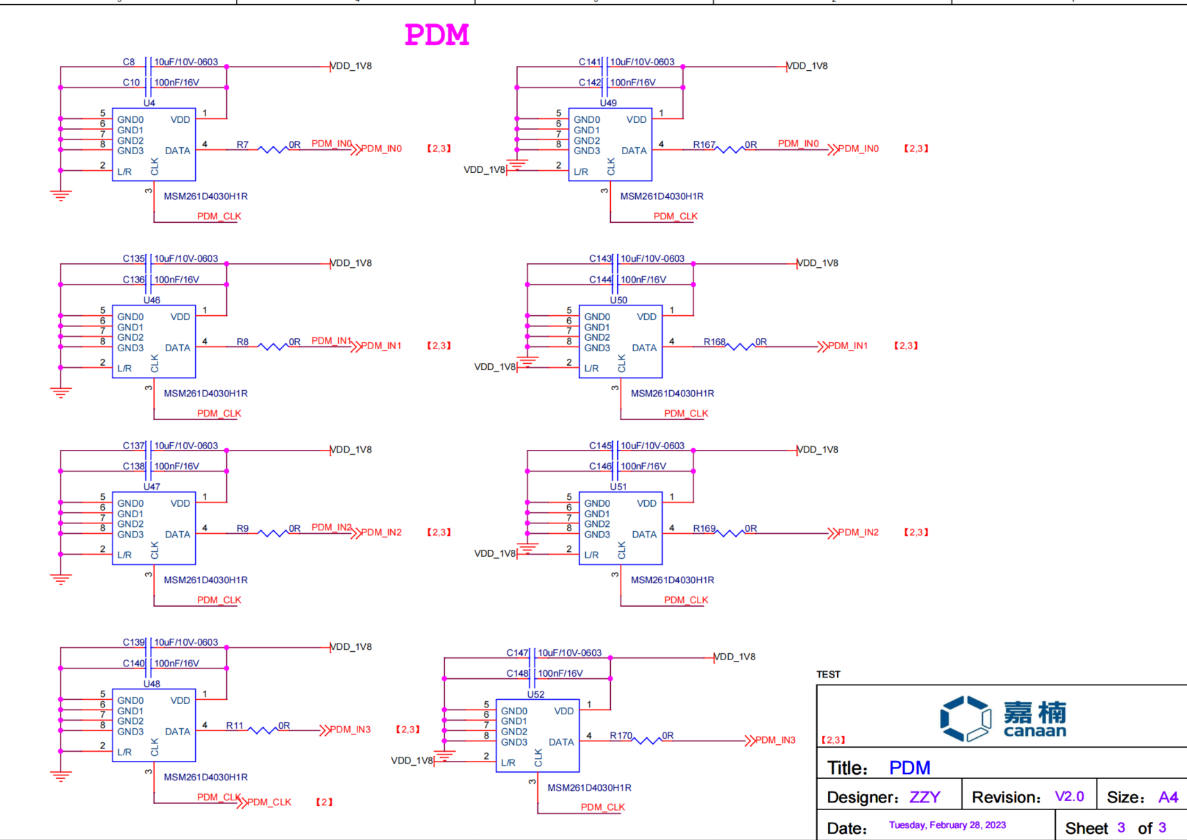

  1. Audio testing depends on the audio sub-board.

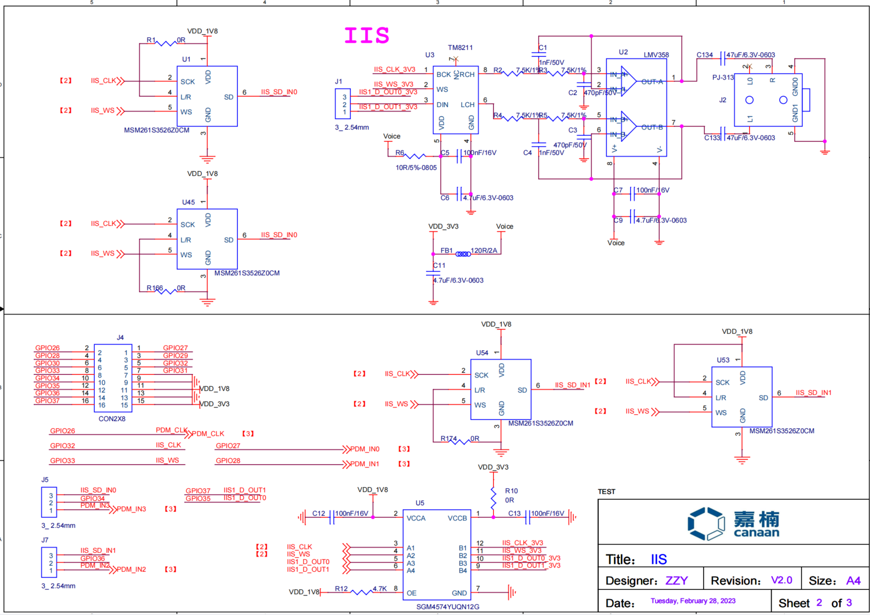

The audio sub-board schematic is as follows:
Diagram, schematic
Diagram, schematic

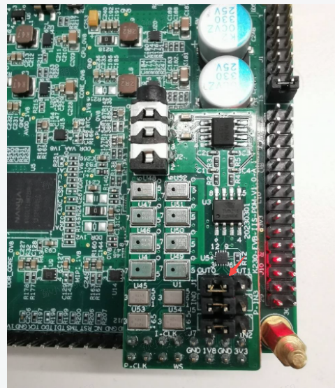

When testing i2s input and output, the audio sub-board can be connected as follows using jumper caps:
Jumper caps for i2s
For pdm audio collection, when collecting data from the 0th or 1st pdm channel, it does not conflict with i2s pins.
When using the 2nd and 3rd pdm channels, jumper caps are needed to switch to pdm channel mode, as follows:
Jumper caps for pdm

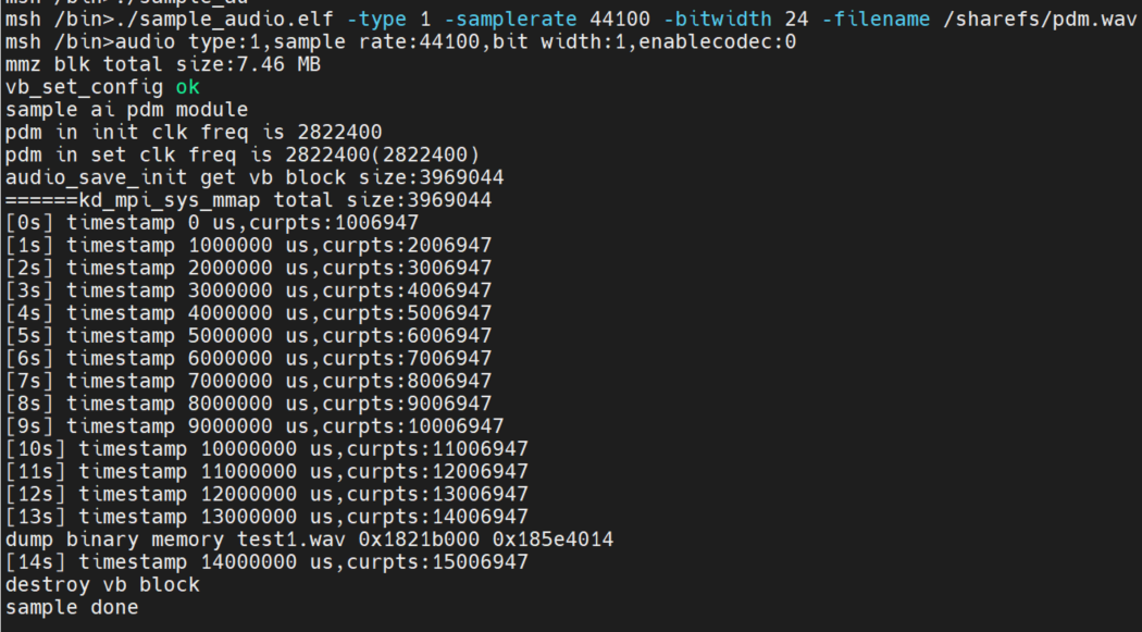

PDM Audio Input Test#
  • Input ./sample_audio.elf -type 1 to collect 15s of pcm audio data.
  • Use the -samplerate option to select the sampling rate for audio collection.
  • Use the -bitwidth option to set the sampling precision.
  • Use the -enablecodec option to set whether to use the built-in codec. After collecting 15s of data, the demo automatically exits and saves the data to a file.
The demo implementation idea: This test collects data by looping the API functions: kd_mpi_ai_get_frame and kd_mpi_ai_release_frame. Note that the ai dev number corresponding to pdm is 1.
pdm in log

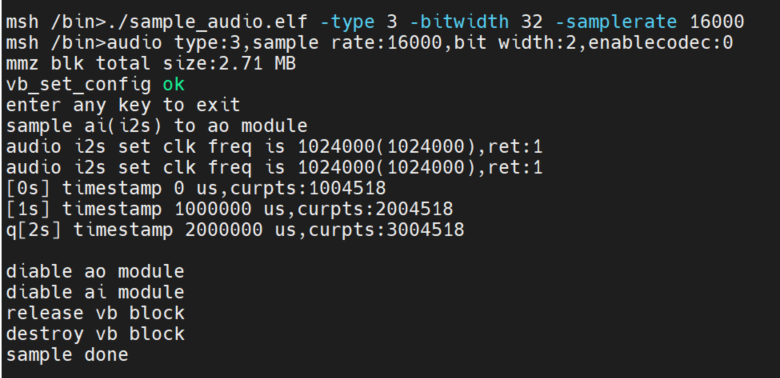

Input ./sample_audio.elf -type 3 -bitwidth 32 to test audio input and output functionalities in real-time through the API interface.
The overall functionality of audio input and output is tested by calling the API interface: kd_mpi_ai_get_frame to get audio data and kd_mpi_ao_send_frame to output audio data. Users can press any key to exit the function test. During the test, the timestamp information collected by ai is output in real-time.
Text description auto-generated

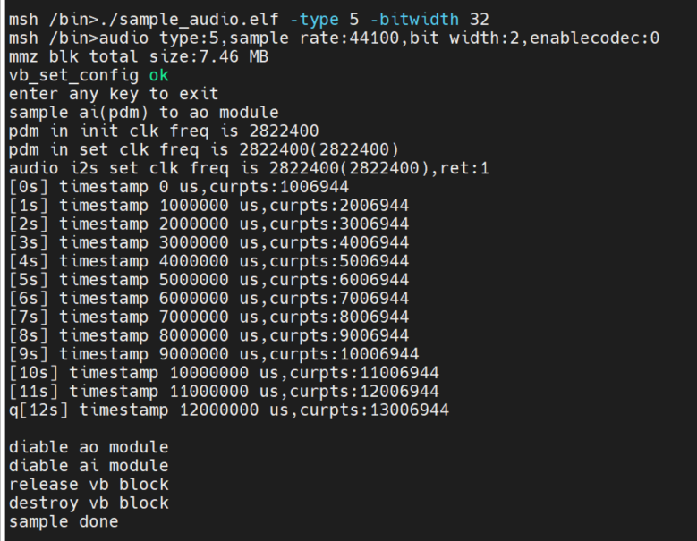

PDM Audio Input, I2S Output API Interface Test#
Input ./sample_audio.elf -type 5 -bitwidth 32 to test audio input and output functionalities in real-time through the API interface.

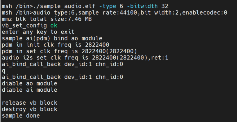

PDM Audio Input, I2S Output System Binding Test#
Input ./sample_audio.elf -type 6 -bitwidth 32 to test audio input and output functionalities in real-time by binding the ai and ao modules.
The overall functionality of audio input and output is tested by calling the system binding API interface: kd_mpi_sys_bind to bind the ai and ao modules. Users can press any key to exit the function test.
pdm in is2 out bind

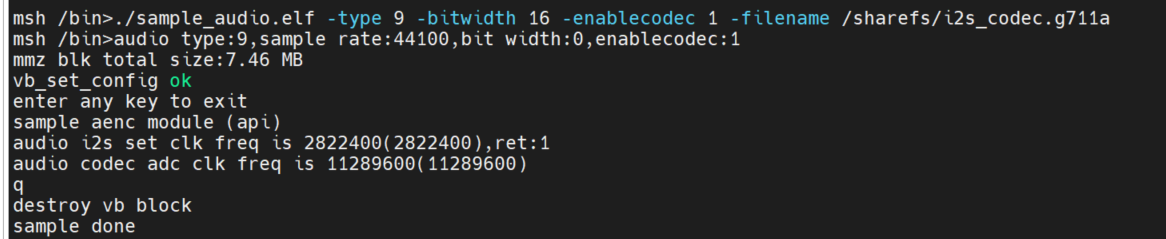

Encoding Test#
Collect ai data and encode it to save to a file. Encoding and decoding only support g711a/u, 16bit.
System binding method: ./sample_audio.elf -type 7 -bitwidth 16 -enablecodec 1 -filename /sharefs/i2s_codec.g711a
audio enc bind log
API interface method: ./sample_audio.elf -type 9 -bitwidth 16 -enablecodec 1 -filename /sharefs/i2s_codec.g711a
audio enc log

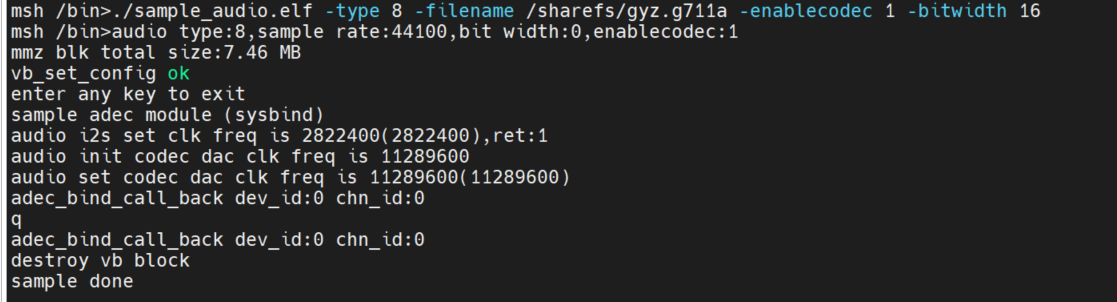

Decoding Test#
Read file data and decode it for playback. Encoding and decoding only support g711a/u, 16bit.
System binding method: ./sample_audio.elf -type 8 -filename /sharefs/gyz.g711a -enablecodec 1 -bitwidth 16
audio dec bind
API interface method: ./sample_audio.elf -type 10 -filename /sharefs/gyz.g711a -enablecodec 1 -bitwidth 16

Run the vglite_drm command. The GPU will display the pattern on the LCD screen, and pressing the Enter key again will display the next pattern, as shown below:
First Pattern
Second Pattern
vglite_cube#
Run the vglite_cube command. The GPU will display a rotating cube on the LCD screen, as shown below:
Cube

modetest -M canaan-drm -D 0 -a -s 38@36:1080x1920-30  -P 31@36:1080x1920@NV12 -v -F smpte
After executing the above command, a color bar will be displayed on the LCD screen, as shown below:

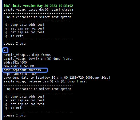

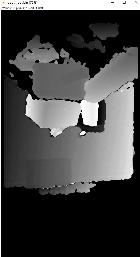

The demo process is as follows:
  1. Start VICAP.
  2. Dump a frame of speckle image in user space.
  3. Send the speckle image obtained from VICAP to DMA for 90-degree rotation processing.
  4. Get the rotated image from DMA in user space.
  5. Send the rotated image from DMA to DPU for depth processing.
  6. Get the depth image processed by DPU in user space.
  7. Save it as a file in the large and small core shared directory /sharefs. You can share this file to the server through mnt and use tools to view the depth image.

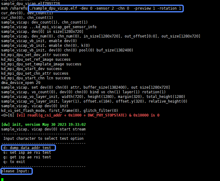

  2. Use the command ./sample_dpu_vicap.elf -dev 0 -sensor 2 -chn 0 -preview 1 -rotation 1 to start the demo. The output print information is as follows:
    run
  3. Input d, the output print information is as follows:
    save
  4. Input q to exit the program.
  5. At this point, the depth_out.bin file is in the /sharefs directory. This file is the depth image file output by DPU, which can be opened and viewed using appropriate software.

  4. The depth image result output by DPU is as follows:
    dpu

  5. The results are as follows:
    depth
