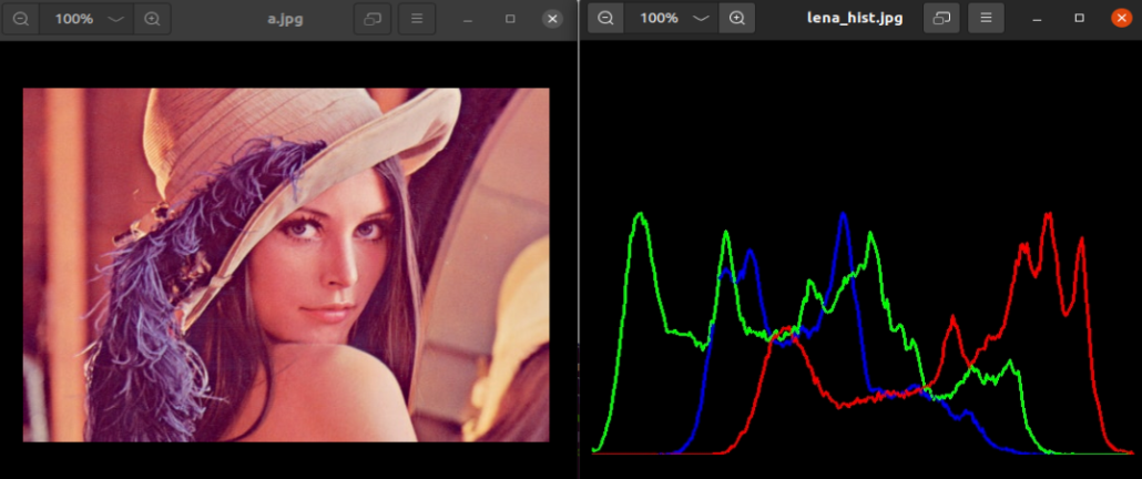

The running result of the 1_opencv_calcHist test case is as follows:
test_opencv_calcHist
On the left is the original image, and on the right is the pixel histogram information of the 3 channels.

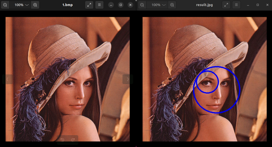

The running result of the 4_opencv_features2d test case is as follows: test_opencv_features2d On the left is the original image, and on the right is the processed feature extraction result image.
opencv_objdetect#
The running method of the 5_opencv_objdetect test case is as follows:
The running result of the 5_opencv_objdetect test case is as follows: test_opencv_objdetect
On the left is the original image, and on the right is the target detection result image for eyes and faces.
