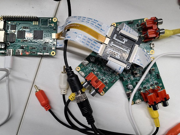

YUV Sensor Demo#
Demo Introduction#
Three-way YUV sensor input, outputting YUV444 packed format to DDR through VICAP’s MCM hardware, and converting to NV12 format using the CSC function of nonai_2d hardware.
VICAP binds to nonai_2d, nonai_2d outputs to both VENC and VO, performing RTSP streaming and screen display.
Feature Description#
Dependency Resources#
Depends on special adapter board hardware, as shown below:
Image Description
Usage Instructions#
