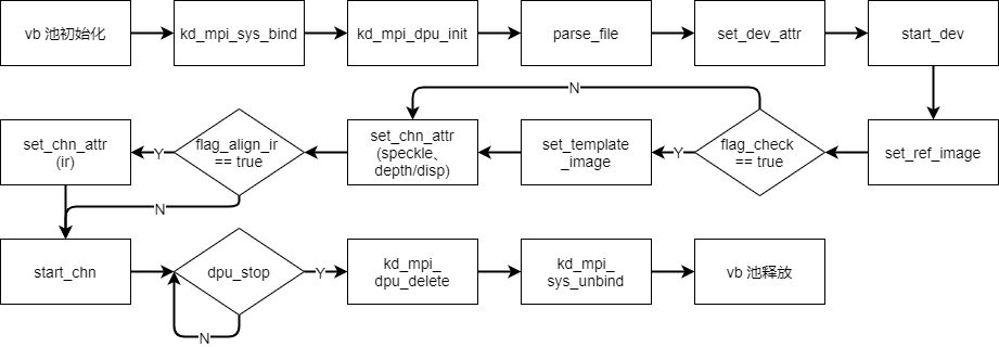

Binding Mode Call Process#
Diagram

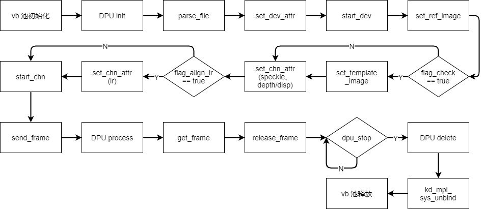

Non-Binding Mode Call Process#
Diagram
