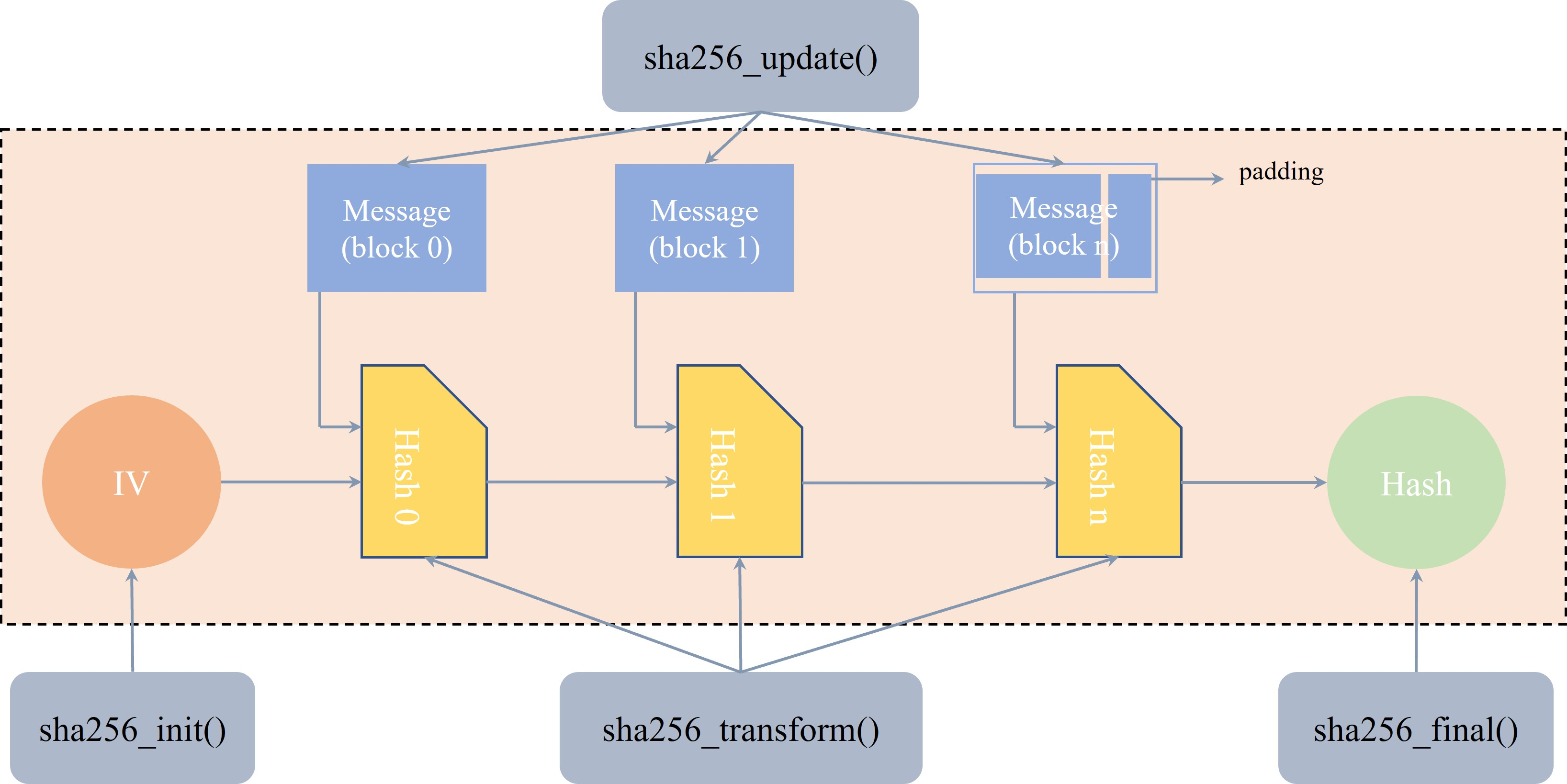

SHA256 is mainly used to calculate the hash value of data. The SHA256 algorithm is implemented in the rt-smart of the main core to calculate the hash value of data. The code logic is shown in the following figure:
