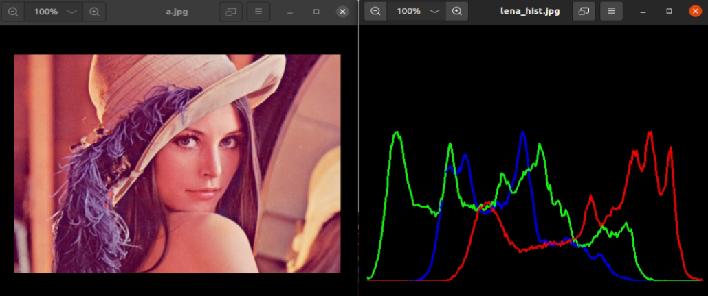

test_opencv_calcHist
On the left is the original image, and on the right is the pixel histogram information of the 3 channels.

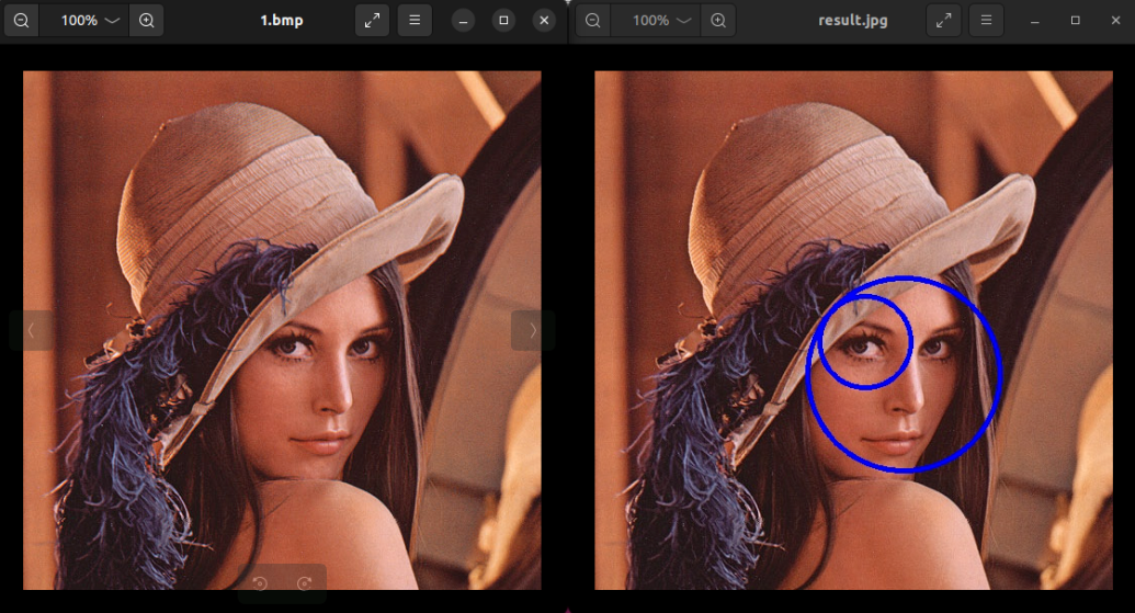

The running result of the 5_opencv_objdetect test case is as follows: test_opencv_objdetect
On the left is the original image, and on the right is the target detection result image for eyes and faces.
