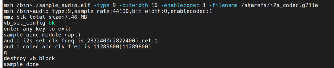

Encoding Test#
Obtain AI data and encode it to save to a file. Encoding and decoding only support g711a/u, 16bit.
System binding method: ./sample_audio.elf -type 7 -bitwidth 16 -enablecodec 1 -filename /sharefs/i2s_codec.g711a
Audio Enc Bind Log
API interface method: ./sample_audio.elf -type 9 -bitwidth 16 -enablecodec 1 -filename /sharefs/i2s_codec.g711a
Audio Enc Log

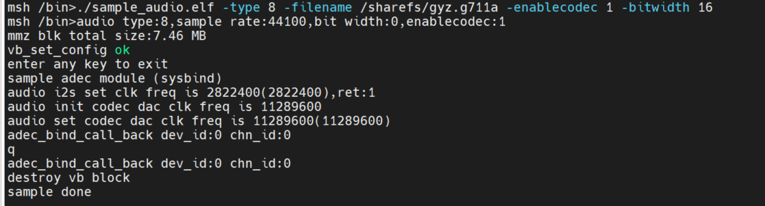

Decoding Test#
Read file data and decode it for playback. Encoding and decoding only support g711a/u, 16bit.
System binding method: ./sample_audio.elf -type 8 -filename /sharefs/gyz.g711a -enablecodec 1 -bitwidth 16
Audio Dec Bind
API interface method: ./sample_audio.elf -type 10 -filename /sharefs/gyz.g711a -enablecodec 1 -bitwidth 16
Audio Dec

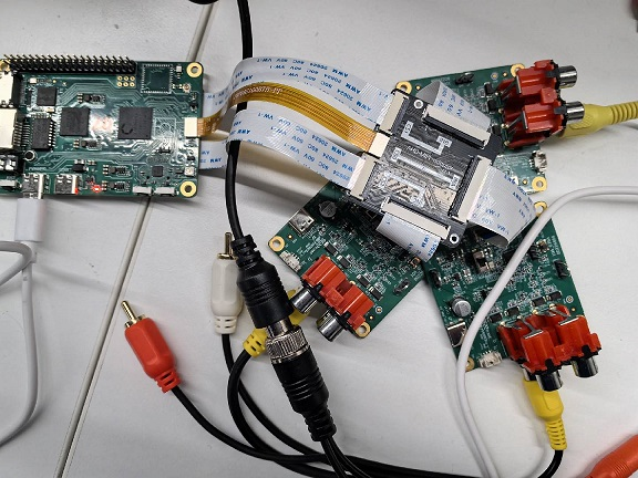

YUV Sensor Demo#
Demo Introduction#
Three-way YUV sensor input, outputting YUV444 packed format to DDR through VICAP’s MCM hardware, and converting to NV12 format using the CSC function of nonai_2d hardware.
VICAP binds to nonai_2d, nonai_2d outputs to both VENC and VO, performing RTSP streaming and screen display.
Feature Description#
Dependency Resources#
Depends on special adapter board hardware, as shown below:
Image Description
Usage Instructions#
After entering the large core RT-Smart system, execute:
After entering the small core Linux system, execute:
/mnt/yuv_sensor_demo -n 3
