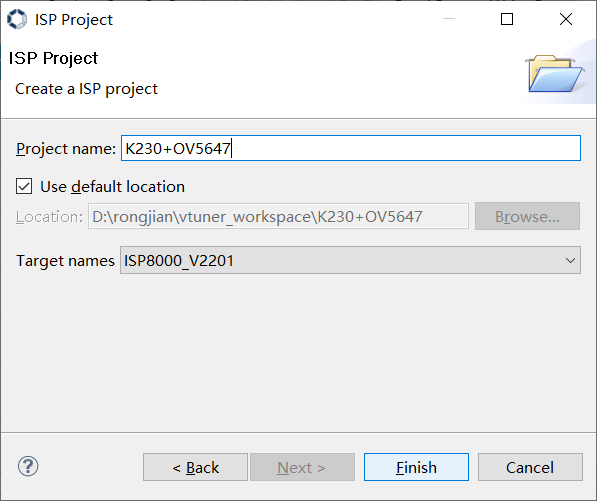

Click the “ISP” directory to display the “ISP Project Wizard”. Click on “ISP Project Wizard” and then click the “Next” button to pop up the project creation window as shown in Figure 3-5.
Figure 3-5
Enter the project name, specify the project address, and click the “Finish” button to complete the project creation. The project will be displayed in area ③ of Figure 3-1. Click the project to start ISP debugging.

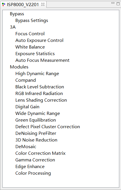

3.3 Online Debugging Interface and Function Description#
This section briefly introduces the main functions of the debugging modules on the tuning tool interface. The specific debugging strategies and steps are described in detail in the image tuning document.
The ISP function modules are shown in Figure 3-6.
Figure 3-6

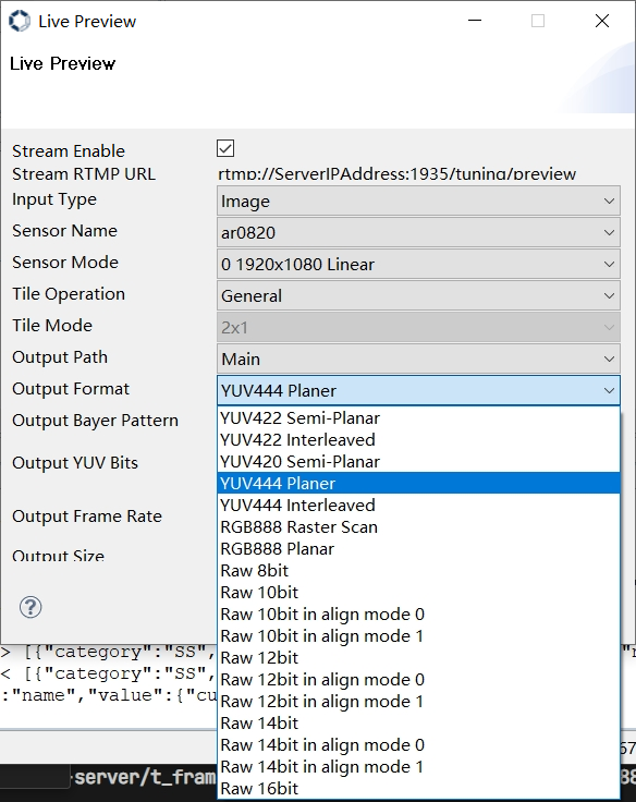

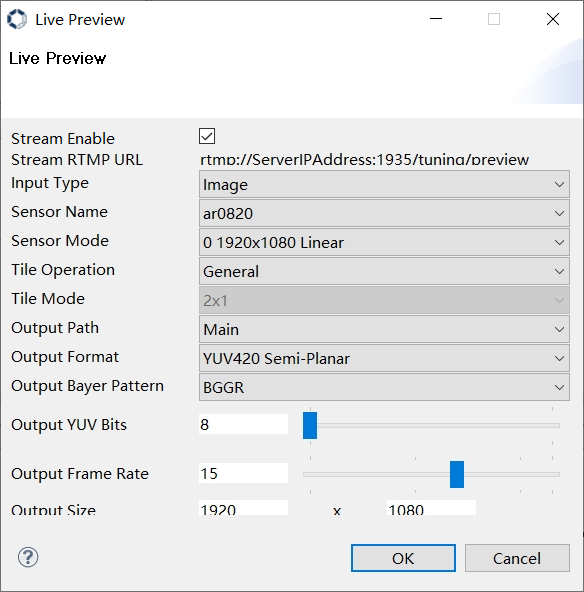

3.4 Capture Image#
3.4.1 Set Image Format and Size#
Click the preview button in the toolbar
, and the window shown in Figure 3-7 will pop up.
Figure 3-7
Check “Stream Enable”. In the “Output Format” section, select the image format you need to capture:
For capturing YUV images, currently only 8-bit yuvNV12 format data is supported, so select “YUV420 Semi_Planar”.
For capturing raw data images, select the appropriate bit width option according to the raw data bit width accessed by the ISP.
As shown in Figure 3-8, correctly set the image size in the “Output Size” section.
Figure 3-8
Click the “OK” button to complete the settings.

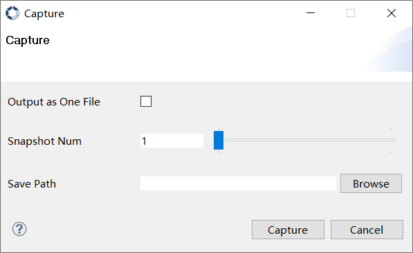

3.4.2 Capture Image#
Click the capture button in the toolbar
, and the window shown in Figure 3-9 will pop up.
Figure 3-9
In the “Save Path” section, select the location to save the image file.
To capture a single frame image, simply click the “Capture” button.
To capture multiple frames, set the number of frames to be captured in the “Snapshot Num” option and configure the “Output as One File” option (checked or unchecked) based on the desired number of output files. After completing the above configuration, click the “Capture” button to start capturing.

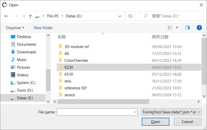

3.5.1 Import Parameters#
The tool supports importing parameter files in standard XML and JSON formats by default, divided into calibration parameters and tuning parameters, and supports local import on the PC.
Click the import button in the toolbar
, and the window shown in Figure 3-10 will pop up.
Figure 3-10
In the window shown in Figure 3-10, select the XML or JSON parameter file you need to import, and click the “Open” button to start importing.

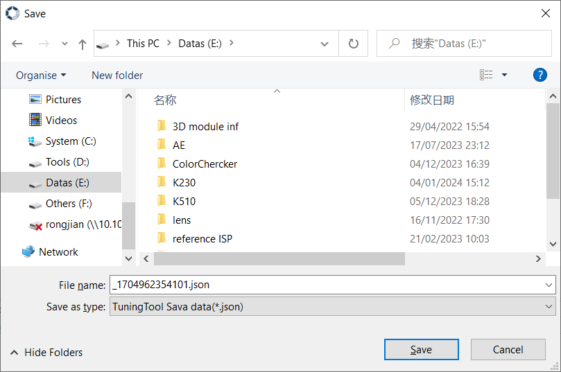

3.5.2 Export Parameters#
The tool’s default export method will summarize the online debugging parameters into a JSON file for storage.
Click the export button in the toolbar
, and the window shown in Figure 3-11 will pop up.
Figure 3-11
In the window shown in Figure 3-11, select the JSON parameter file you need to export, and click the “Save” button to start exporting.
