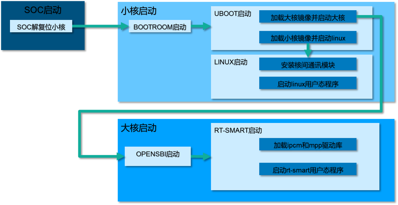

K230 Boot Sequence#
The overall boot process of K230 is shown in the following diagram:

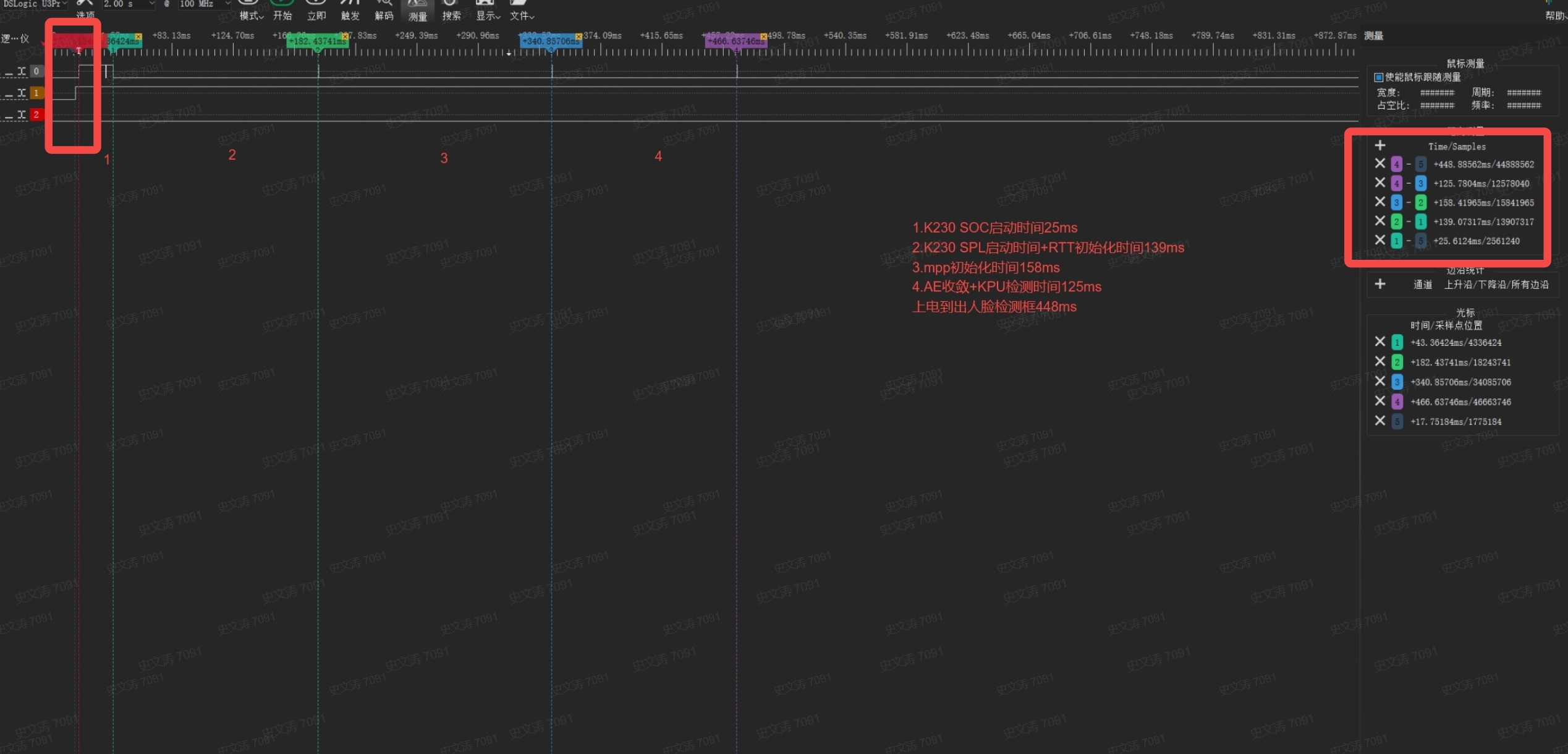

Hardware Measurement#
Add GPIO edge changes at the points that need to be measured. More accurate time can be obtained through a logic analyzer or oscilloscope.

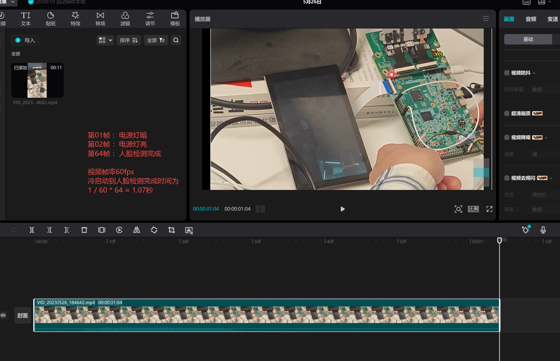

External Observation#
Record the entire system boot process via video. The onboard power light turning on represents the system powering up, and the VO displaying the VI image indicates that the video pipeline is established and can be displayed. A frame appearing around a face indicates that face recognition is completed.

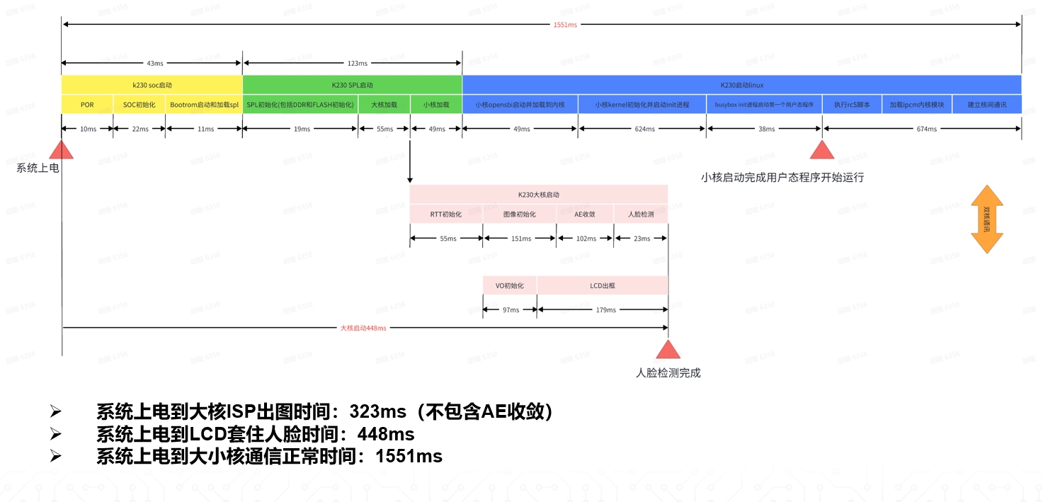

Optimization Effects#
The boot time statistics of the door lock POC. This statistical data was measured on June 9th, and there may be discrepancies with the current latest SDK version data.
