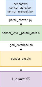

2.1 Flowchart#
The production flowchart is as follows:
isp param
Figure 2-1 Parameter Partition Production Flowchart

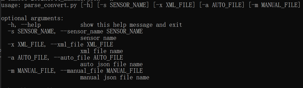

Execute the conversion header file tool parse_convert.py, parse and convert the three copied configuration files into a parameter header file (it is recommended to use python3.x for the conversion tool)
parse_convert

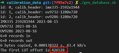

calc_isp_param_data_size
Figure 2-2 Parameter Partition Automatically Calculates Dewarp Offset

// Configuration using dewarp
/* dewarp data */
    /* has_lut */
    1,
    /* lut_offset */
    CONFIG_MEM_SENSOR_CFG_BASE + 426528, // 426528 is calculated by the script
