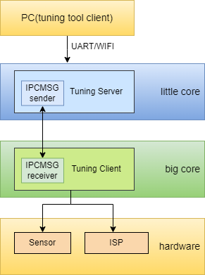

1.Module software architecture#
arch
Figure 1-1

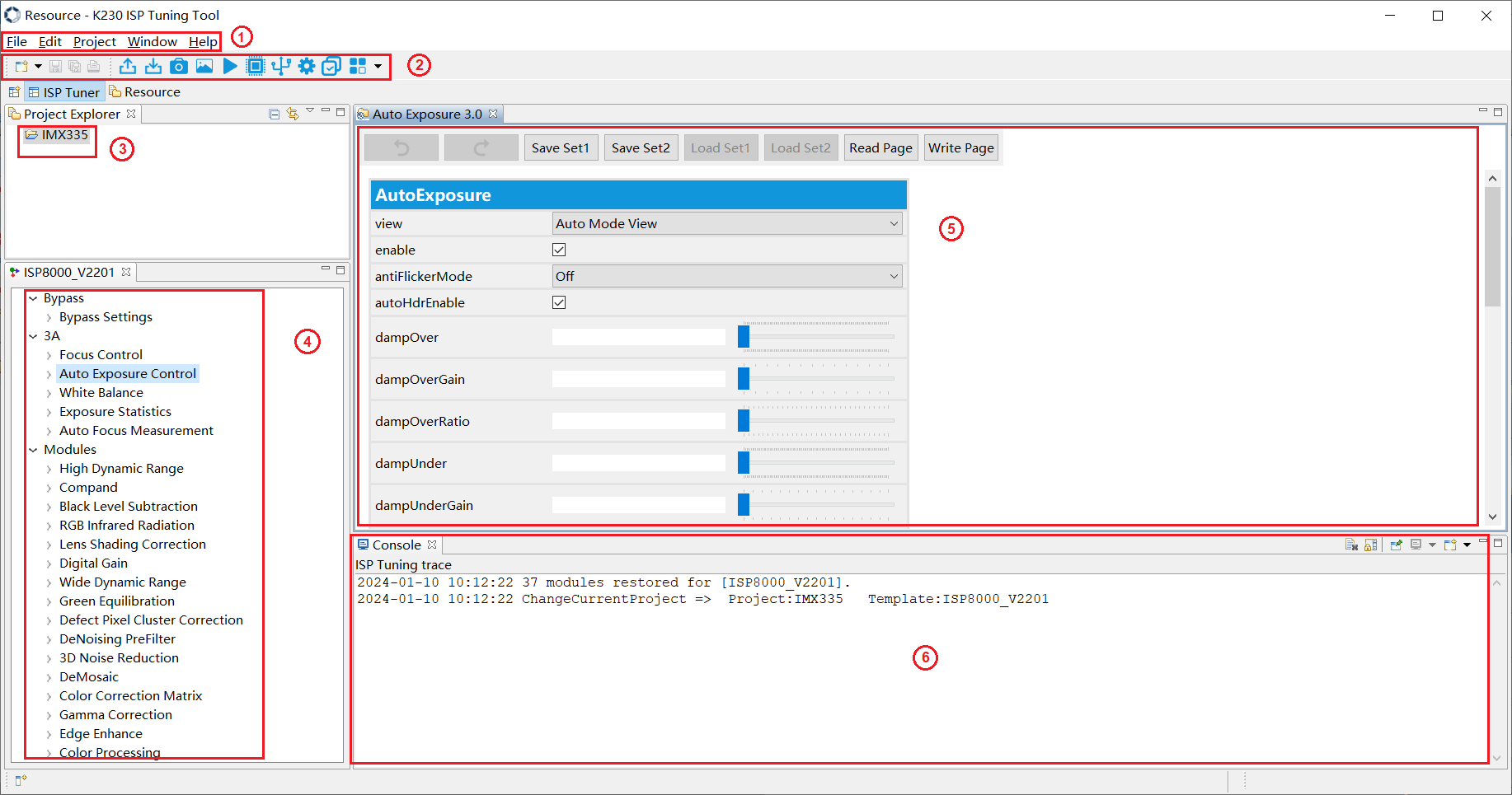

As shown in Figure 3-1,the basic operation UI of tuning tool is fully expanded in six areas:
(1) Menu operation area: functions such as file operation and window management
(2) Toolbar area: support operations for key functions

(3) Project explorer area: selecting and managing different projects
(4) Functional area: used to switch the UI of each module of the ISP
(5) Tuning area: the parameters used to debug a module
(6) Echo area: used to print the logs sent and received by some parameters

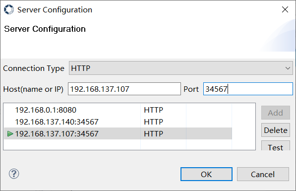

The SDK supports HTTP connection by default, click the connection button Graphical user interface,text,application description is automatically generated in the toolbar, and will pop up the server configuration window, as shown in Figure 3-2.
Graphical User Interface,Text,Application,Email Description is automatically generated
Figure 3-2
Select HTTP mode, ensure that the PC and the board end of the network connected to the network is in the same network segment.Enter the IP address in the “Host” input box, and enter the fixed port 34567 in the “Port” input box. After configuration is completed, click the “OK” button. If the board end tuning server has been started, the connection will be automatically completed. Arbitrarily switch the module in the ④ area in Figure 3-1, you will see the function print on the tuning-server side.

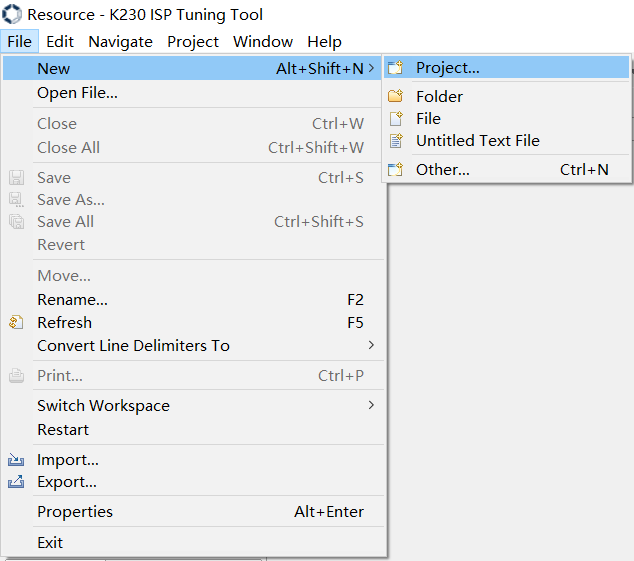

Click on File ->New ->Project… in sequence, as shown in Figure 3-3, will pop up the wizard window, as shown in Figure 3-4.

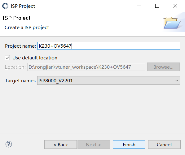

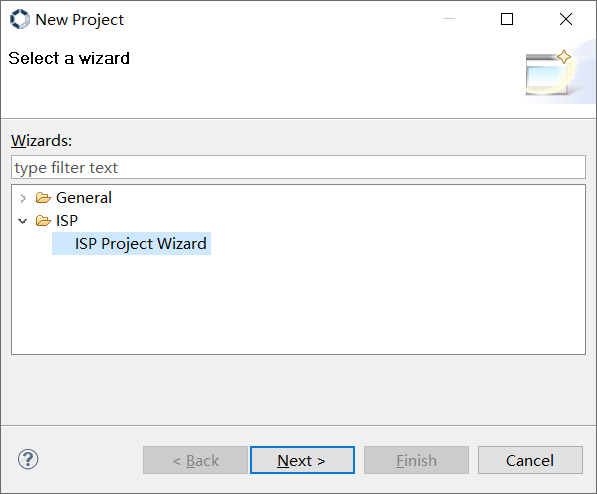

Click on the “ISP” directory to display the “ISP Project Wizard”. After clicking on the “ISP Project Wizard”, click on the “Next” button, and a project creation window will pop up, as shown in Figure 3-5.
Figure 3-5
Enter the project name, specify the project location, and click the “Finish” button to complete the project creation. The project will be displayed in area ③ of Figure 3-1. Click on this project to start ISP tuning.

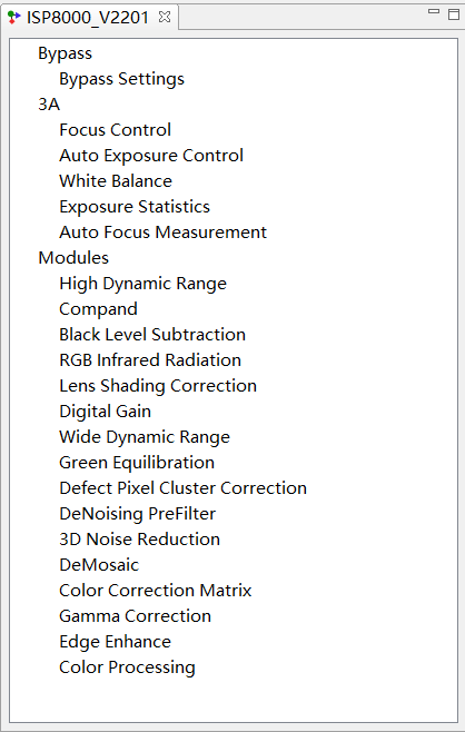

The ISP functional modules are shown in Figure 3-6.
Figure 3-6

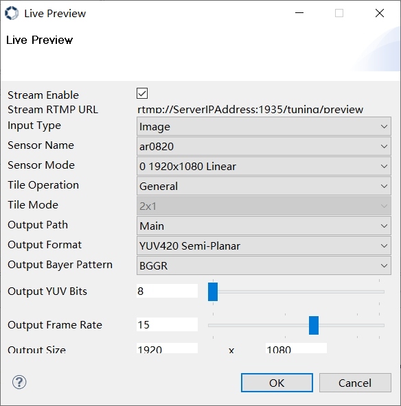

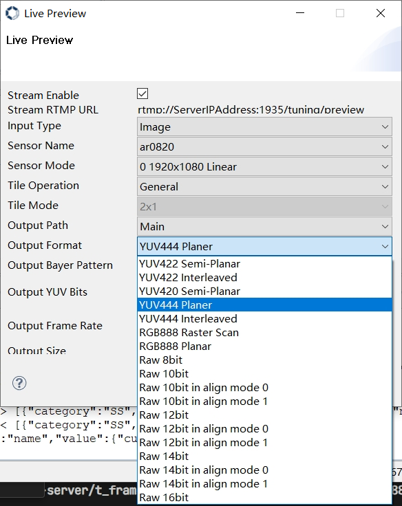

Click the preview button Graphical user interface,text,application description is automatically generated in the toolbar, and will pop up the live preview window, as shown in Figure 3-7.
Figure 3-7
Check “Stream Enable”, select the image format to be captured in the “Output Format” column:
If you want to capture YUV images, please select “YUV420 Semi_ Planar”, currently only 8-bit yuvNV12 format data is supported.
If you want to capture raw data images, please select the corresponding bit width option based on the raw data bit width accessed by your ISP.
As Figure 3-8, please set the image size correctly in the “Output Size” input boxes.
Figure 3-8
Click the “OK” button to complete the setup.

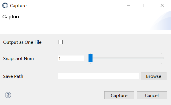

Click the capture button Graphical user interface,text,application description is automatically generated in the toolbar, and will pop up the capture window, as shown in Figure 3-9.
Figure 3-9
Select the location where the image file will be saved in the “Save Path” bar.
If shooting a single frame image, simply click the “Capture” button;
If shooting multiple frames of images, please set the desired number of frames to be captured in the “Snapshot Num” option, and set the “Output as One File” option (checked or unchecked) based on the desired number of files to be output. After completing the above configuration, click the “Capture” button to start shooting.

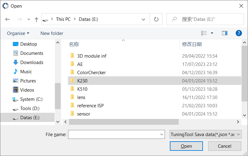

The parameter file that the tool supports import by default is standard xml and json format,which is divided into two parts:calibration parameters and tuning parameters,and supports PC local import.
Click the import button Graphical user interface,text,application description is automatically generated in the toolbar, and will pop up the open window, as shown in Figure 3-10.
Graphical user interface,Application description is automatically generated
Figure 3-10
Select the xml or json parameter file that needs to be imported in the window shown in Figure 3-10, and click the “Open” button to start importing.

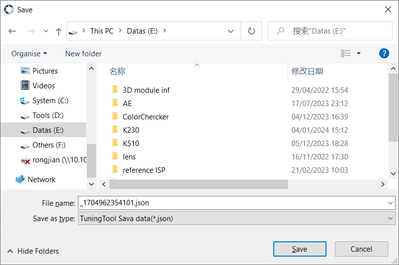

Click the export button Graphical user interface,text,application description is automatically generated in the toolbar, and will pop up the save window, as shown in Figure 3-11.

Select the json parameter file to be exported in the window shown in Figure 3-11, and click the “Save” button to start exporting.
