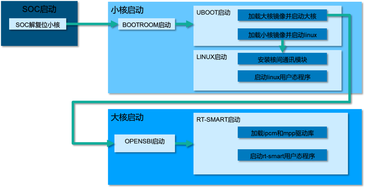

K230 Boot Sequence#
The overall boot process of K230 is shown in the following diagram:
K230 Overall Boot Process Diagram

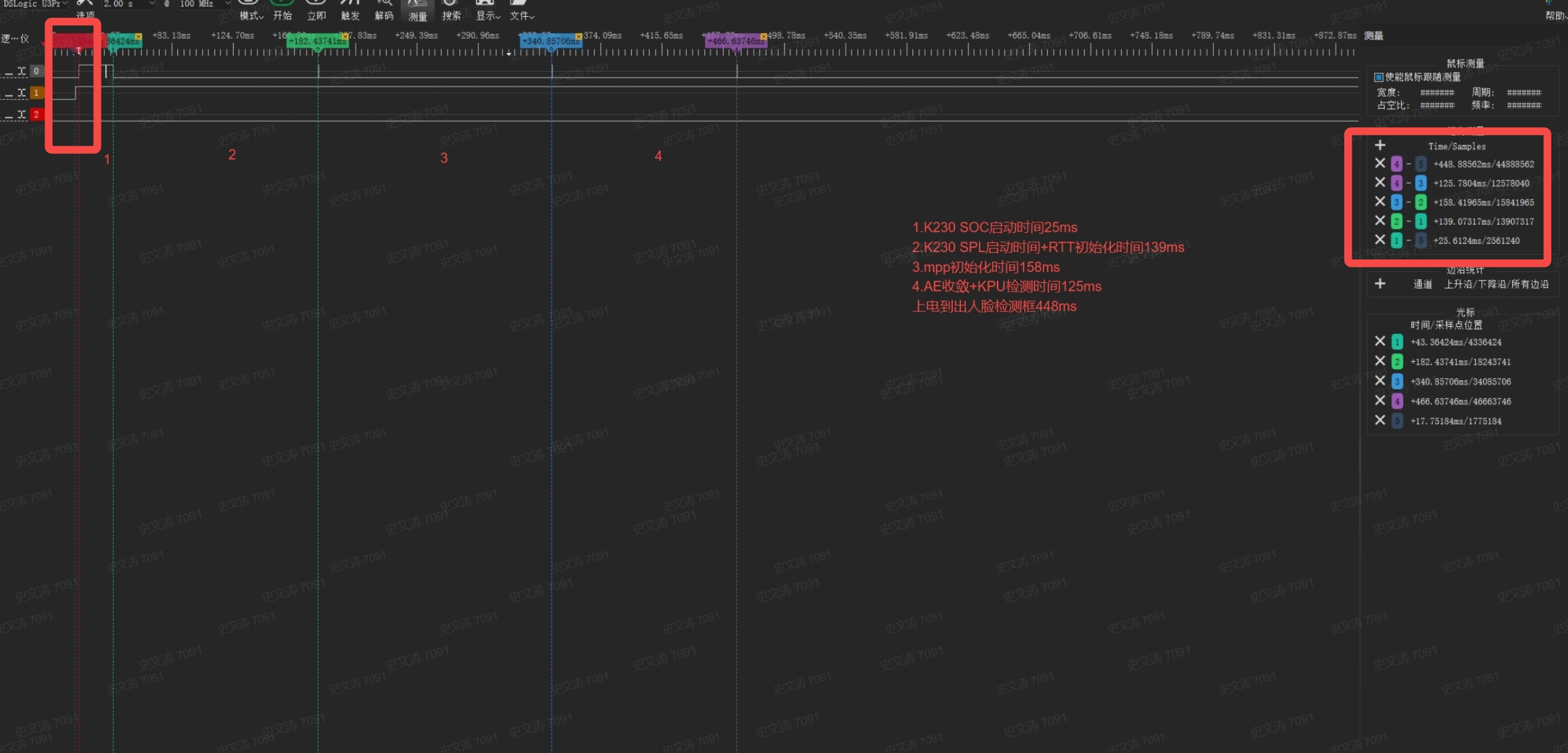

Hardware Measurement#
Add GPIO edge changes at the points that need to be measured. More accurate time can be obtained through a logic analyzer or oscilloscope. You can detect the power-on signal of the development board through pin 14 of J1 on the K230_EVB_LPDDR3_UNSIP board (you need to short-circuit pins 15 and 16 with a jumper cap). Logic Analyzer Statistics Boot Time
