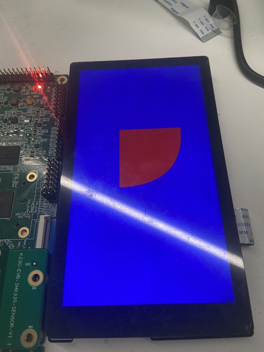

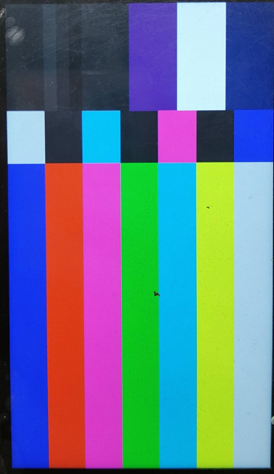

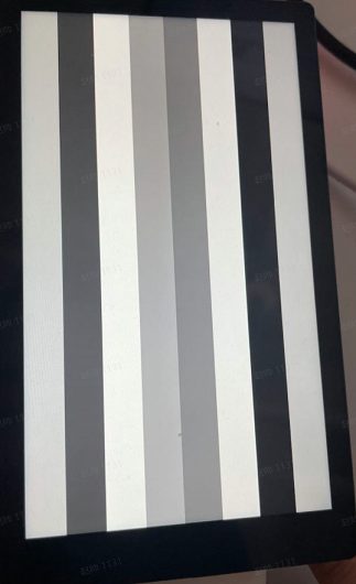

DSI self-test mode demo run command:
./sample_vo.elf 2
An image of the Color Bar is displayed on the screen, as follows:
The Background Pattern description is automatically generated

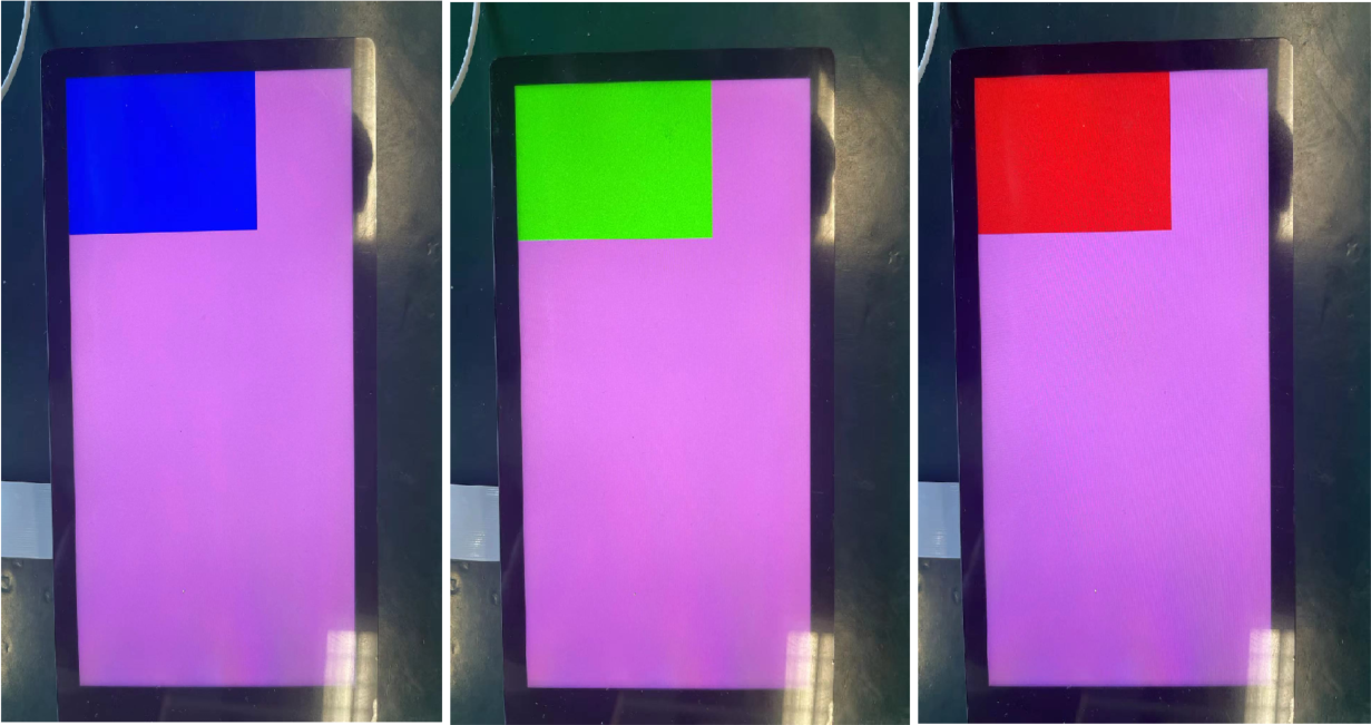

  1. VO and VVI bind demo run command:
    ./sample_vo.elf 9
    when press Enter key once,VVI start sending argb data,press Enter key again, the program exits.
    The display effect is alternating red, green and blue primary colors, and the effect is as follows:
    Image description

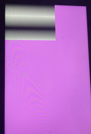

  2. VO layer inserts frames demo run command:
    ./sample_vo.elf 7
    After executing the command, press Enter key to insert a picture from the user layer, and press Enter again to exit
    The display effect is as follows:

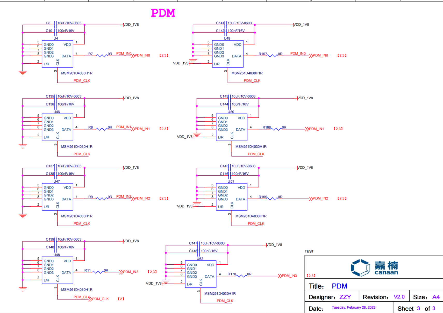

  1. Audio tests rely on audio daughter boards.
The audio daughter board schematic is as follows:
Illustrative, Schematic description is automatically generated

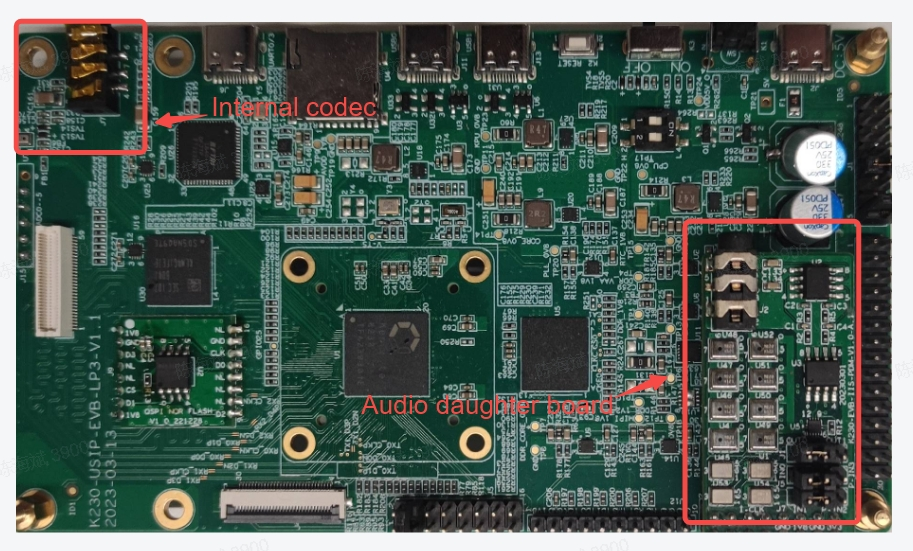

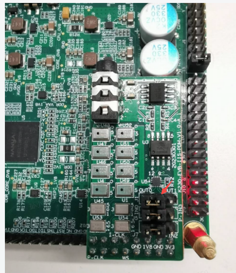

When testing I2S input and output, the audio daughter board can be connected via jumper caps as follows:
Jumper caps for i2s
PDM audio acquisition, when acquiring group 0 PDM channel or group 1 PDM channel data, the use pin does not conflict with the I2S pin.
When using Group 2 and Group 3 PDM channels, it is necessary to switch to PDM channel mode using jumper caps, as follows:
Jumper caps for pdm

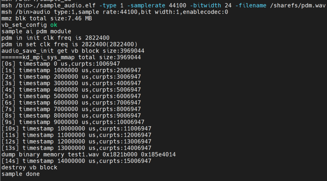

PDM audio input test#
  • Input ./sample_audio.elf -type 1to acquire PCM audio data in 15s
  • -samplerateoption to choose to capture audio at different sample rates
  • -bitwidth to set different sampling accuracy
  • -enablecodecSet whether to use the built-in codec. After collecting 15s data, the demo automatically exits and saves the data to a file.
Demo implementation idea: This test collects data by calling the API function: AND in a loopkd_mpi_ai_get_frame``kd_mpi_ai_release_frame. Note that the AI dev number corresponding to PDM is 1
PDM and log

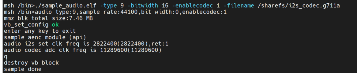

input./sample_audio.elf -type 3 -bitwidth 32, real-time test of audio input and output functions through API interface.
Test the overall functionality of audio input and output by calling the API interface:kd_mpi_ai_get_frame Obtain audio data and call kd_mpi_ao_send_frameoutput audio data.The user can press any key to exit the feature test.During the test, the timestamp information collected by AI is output in real time.
The Text description is automatically generated
Image description

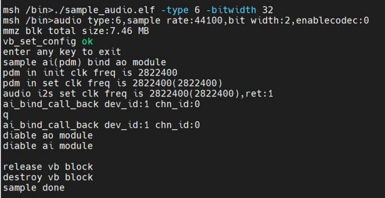

PDM audio input, I2S output system binding test#
Input./sample_audio.elf -type 6 -bitwidth 32, real-time test of audio input and output functions through AI and AO module binding.
By calling the system binding API interface: kd_mpi_sys_bindbind the AI and AO modules to test the overall function of audio input and output.The user can press any key to exit the feature test.

Get AI data and encode it and save it to a file. The codec only supports G711A/U, 16bit.
System binding method:./sample_audio.elf -type 7 -bitwidth 16 -enablecodec 1 -filename /sharefs/i2s_codec.g711a
Audio Enc Bind Log
API interface mode:./sample_audio.elf -type 9 -bitwidth 16 -enablecodec 1 -filename /sharefs/i2s_codec.g711a
Audio Enc Log

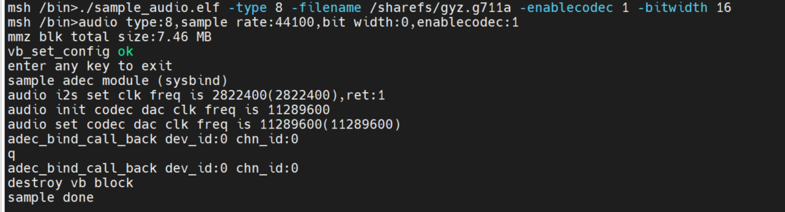

Decoding test#
Read file data and decode playback. The codec only supports G711A/U, 16bit.
System binding method:./sample_audio.elf -type 8 -filename /sharefs/gyz.g711a -enablecodec 1 -bitwidth 16
audio dec bind
API interface mode:./sample_audio.elf -type 10 -filename /sharefs/gyz.g711a -enablecodec 1 -bitwidth 16
audio dec

  • -samplerateoption to configure audio input and output with different sample rates (8K-192K), default is 44.1K.
  • -enablecodecUse the built-in codec or off-chip audio daughter board, and use the built-in codec by default.

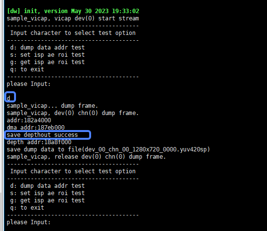

Vicap_demo#
Introduction to vicap_demo#

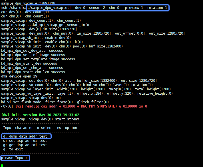

VICAP Demo implements the camera data acquisition preview function by calling the MPI interface.
Feature description#
The current version supports image acquisition preview of OV9732, OV9286, and imx335 camera modules, and supports up to three data streams and up to three camera data inputs.
Dependent Resources#
Camera module
Instructions for Use#
Compilation#
For a detailed description of the software compilation environment, refer to the SDKREADME.md.
  1. Executed in the k230_sdk directory, the make mpp-clean && rt-smart && make build-imagemodification of the big core is compiled into the SD card image, and the imagek230_sdk/output/k230_evb_defconfig/images/ file will be generated under the directorysysimage-sdcard.img.
Execution#
  1. Copy the src/big/mpp/userapps/sample/elf/sample_vicap.elffile to the directory specified locally
  2. Mount this directory to the little core Linux via nfs/sharefs
  3. On the large kernel end, enter viacd /sharefs the command/sharefs
  4. Execute commands in this directory./sample_vicap to obtain command help information
When you enter the : sample_vicapcommand, print the following prompt:
Options:
The parameters are described as follows:
Parameter name
Optional parameter value
Parameter description
-Dev
0: vicap device 0 1: vicap device 1 2: vicap device 2.
Specify the currently used vicap device, and the system supports up to three vicap devices. By specifying the device number, the binding relationship between the sensor and different vicap devices is realized. For example: -dev 1 -sensor 0 binds the ov9732 1280x720 RGB image output to vicap device 1.
-mode
0: Online mode; 1: Offline mode
Specify the vicap device working mode, current before online mode and offline mode. For multiple sensor inputs, it must be specified as offline mode.
-sensor
0: ov9732@1280x720, 1: ov9286_ir@1280x720, 2: ov9286_speckle@1280x720, 3: imx335_2lan@1920x1080, 4:imx335_2lan@2592x1944, 5: imx335_4lan@2592x1944
Specify the sensor type currently used, the current system supports three types of image output: ov9732 1280x720 RGB image output, ov9286 1280x720 infrared image output, ov9286 1280x720 speckle image output. The IMX335 outputs an RGB image
-Chn
0: vicap device output channel 0 1: vicap device output channel 1 2: vicap device output channel 2.
Specify the output channel of the currently used vicap device, one vicap device supports up to three outputs, and only channel 0 supports RAW image format output
-ow
Specifies the output image width, which defaults to the input image width. The width needs to be 16 bytes aligned. If the default width exceeds the maximum width of the display output, the display output width is used as the final output width of the image If the output width is smaller than the input image width and the ox or oy parameters are not specified, the default is the scaled output
-oh
Specifies the output image height, which defaults to the input image height. If the default height exceeds the maximum height of the display output, the display output height is used as the final output height of the image If the output height is less than the input image height and the ox or oy parameter is not specified, the default is the scaled output
-ox
Specifies the horizontal start position of the image output, this parameter greater than 0 will perform the output cropping operation
-Limited liability company
Specifies the vertical start position of the image output, this parameter greater than 0 will perform the output cropping operation
-crop
0: Disable the cropping function 1: Enable the cropping function
When the output image size is smaller than the input image size, the output is not scaled by default, or clipped if the flag is specified
-ofmt
0:YUV format output 1:RGB format output 2:RAW format output
Specify the output image format, the default is YUV output.
-preview
0: Disable preview display 1: Enable preview display
Specifies the output image preview display function. The default is enabled. Currently, up to 2 output images can be previewed at the same time.
-rotation
0: Rotate 0 degrees 1: Rotate 90 degrees 2: Rotate 180 degrees 3: Rotate 270 degrees 4: Rotation is not supported
Specifies the rotation angle of the preview display window. By default, only the first output image window supports the rotation function.
Example 1:
Note: Bind the ov9732@1280x720 RGB to vicap device 0 and enable vicap device output channel 0 and channel 1, where channel 0 output size defaults to the input image size (1280x720) and channel 1 output image size is 640x480
Example 2:
Note: Three inputs and outputs. Bind the ov9732@1280x720 RGB to vicap device 0 and set channel 0 to output an image with a size of 1080x720; bind ov9286@1280x720 infrared to vicap device 1 and set channel 0 to output an image with a size of 1080x720; bind ov9286@1280x720 speckle to vicap device 2 and set channel 0 to output an image with a size of 1080x720 (no preview);

vglite_drm#
Run the vglite_drmcommand, which displays the pattern drawn by the GPU on the LCD screen, and pressEnter the key again to display the next pattern, as shown in the figure
The first pattern
Second pattern

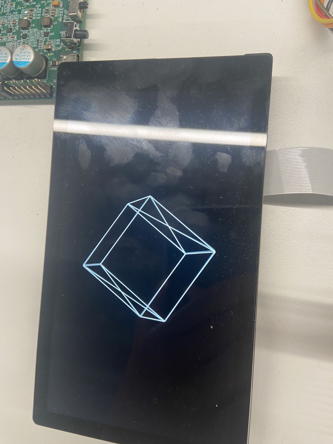

vglite_cube#
Run the vglite_cubecommand and a rotating cube drawn by the GPU will be displayed on the LCD screen, as shown in the following figure
Cube
This demo runtime kernel will have a large number of print messages, if you do not want these messages to be displayed, you can reduce the kernel print level

modetest -M canaan-drm -D 0 -a -s 38@36:1080x1920-30  -P 31@36:1080x1920@NV12 -v -F smpte
After executing the above command, a color bar will be displayed on the LCD screen, as follows:

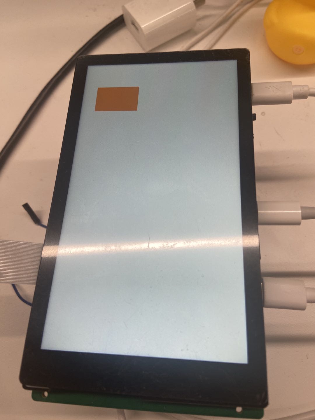

LVGL demo#
Introduction to using demo#
The demo runs on a K230 small-core Linux system and displays a configuration interface on the screen that supports touch operation.
LCD screen
Features description#
  1. Support button, slider function
  2. Support touch function
Compilation#
Software compilation refers to the README.md in the release SDK package
Execution#
lvgl_demo_widgets
After executing the above command, the configuration interface will be displayed on the LCD screen, and the relevant configuration can be made through the touch screen, as follows:
Image description

  1. To mount nfs, use the following command:
    ifconfig eth0 up
    udhcpc
    # Replace the following IP address and path with your own server’s IP address and path.
    mount -t nfs 10.10.1.94:/home/user/nfs  /sharefs -o nolock
    After successful mounting/sharefs, the directories can be seen in both large and little cores, and the compiled demo sample_dpu_vicap.elfis copied to the server’s nfs directory (here it is/home/user/nfs), and the corresponding elf file can also be seen under/sharefs the big core rtt
  2. Use the command ./sample_dpu_vicap.elf -dev 0 -sensor 2 -chn 0  -preview 1 -rotation 1to start demo, and the output printout information is as follows:
    run
  3. Inputd, output print information as follows:
    save
  4. Enterq, exit the program.
  5. At this time, /sharefsthere is a file in the directory, depth_out.binwhich is the depth map file output by the DPU, which can be opened and viewed with the corresponding software.

  5. The effect is as follows:
    ![depth../../../../zh/01_software/board/examples/images/dpu_demo_bind_depth_02150402.png)
