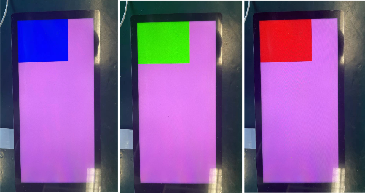

To run the VO and VVI binding demo:
./sample_vo.elf 9Press Enter once to start sending ARGB data from VVI, press Enter again to exit the program. The display effect alternates between red, green, and blue primary colors, as shown below:

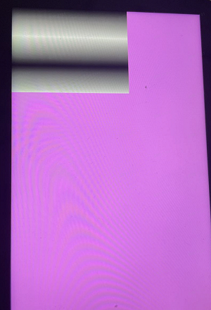

To run the VO layer frame insertion demo:
./sample_vo.elf 7After executing the command, press Enter once to insert an image from the user layer, press Enter again to exit the program. The display effect is as follows:

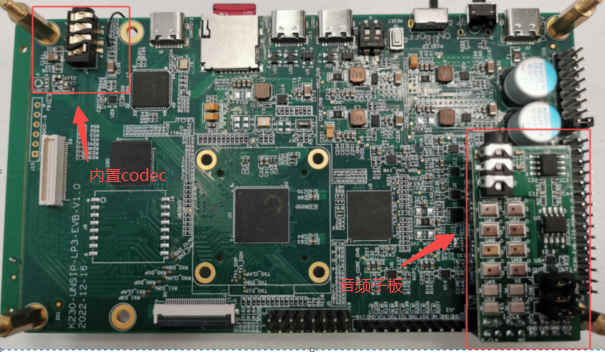

You can use the built-in codec or external devices (audio sub-board) to test audio-related functions. Using the built-in codec allows testing one set of I2S audio input and output and audio codec-related functions. Using the audio sub-board allows testing 2 sets of i2s audio input and output and 4 sets of pdm audio input functions.

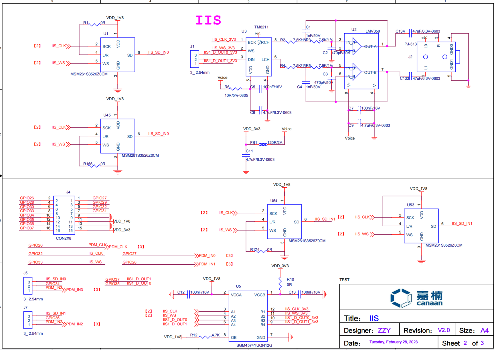

Audio testing depends on the audio sub-board.

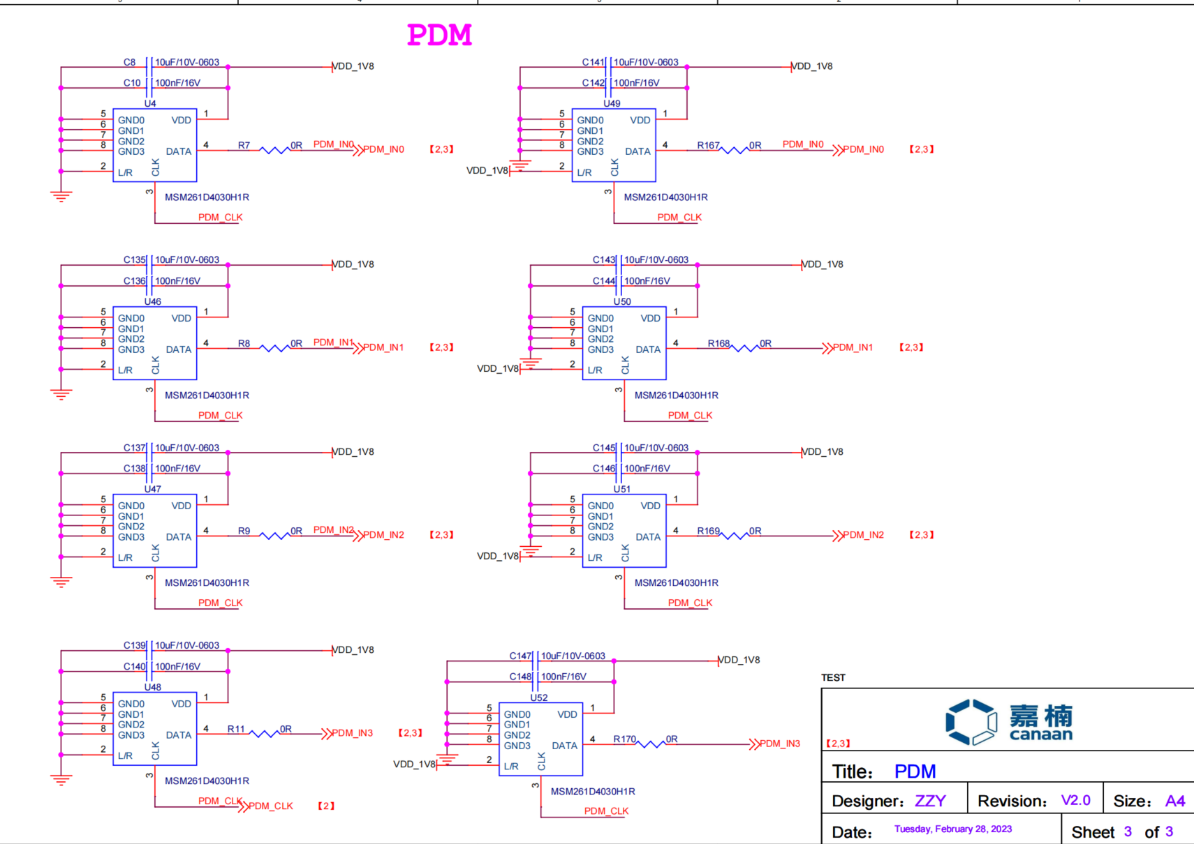

The audio sub-board schematic is as follows:

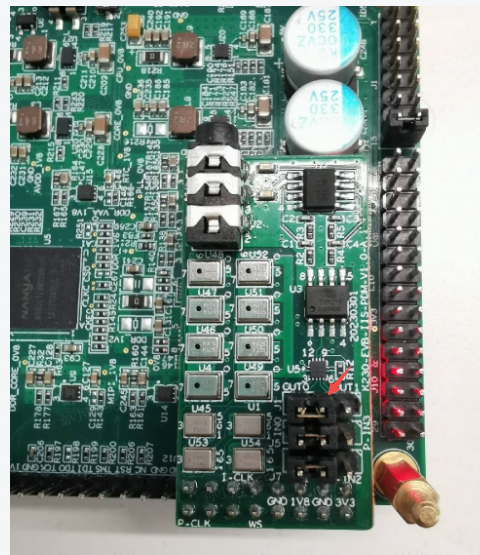

When testing i2s input and output, the audio sub-board can be connected as follows using jumper caps:
For pdm audio collection, when collecting data from the 0th or 1st pdm channel, it does not conflict with i2s pins.
When using the 2nd and 3rd pdm channels, jumper caps are needed to switch to pdm channel mode, as follows:

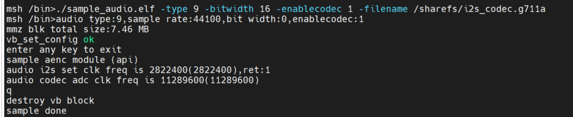

2.5.4.2.1 I2S Audio Input Test#
Input
./sample_audio.elf -type 0to collect 15s of pcm audio data.Use the
-samplerateoption to select the sampling rate for audio collection.Use the
-bitwidthoption to set the sampling precision.Use the
-enablecodecoption to set whether to use the built-in codec.Use the
-filenameoption to save data to a file. After collecting 15s of data, the demo automatically exits.

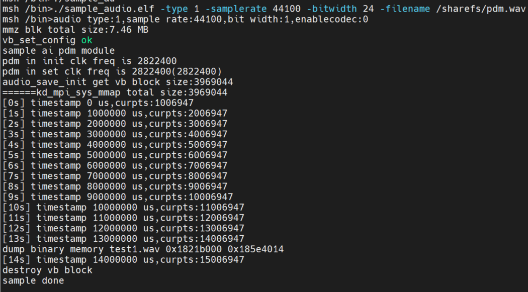

2.5.4.2.2 PDM Audio Input Test#
Input
./sample_audio.elf -type 1to collect 15s of pcm audio data.Use the
-enablecodecoption to set whether to use the built-in codec. After collecting 15s of data, the demo automatically exits and saves the data to a file.
The demo implementation idea: This test collects data by looping the API functions: kd_mpi_ai_get_frame and kd_mpi_ai_release_frame. Note that the ai dev number corresponding to pdm is 1.

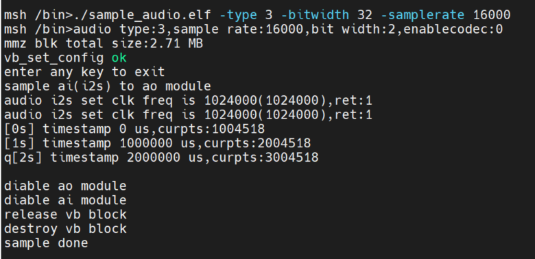

2.5.4.2.4 I2S Audio Input and Output API Interface Test#
Input ./sample_audio.elf -type 3 -bitwidth 32 to test audio input and output functionalities in real-time through the API interface.
The overall functionality of audio input and output is tested by calling the API interface: kd_mpi_ai_get_frame to get audio data and kd_mpi_ao_send_frame to output audio data. Users can press any key to exit the function test. During the test, the timestamp information collected by ai is output in real-time.

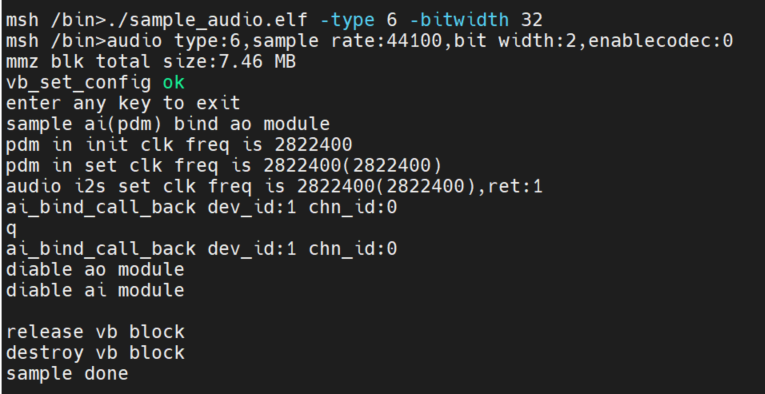

2.5.4.2.7 PDM Audio Input, I2S Output System Binding Test#
Input ./sample_audio.elf -type 6 -bitwidth 32 to test audio input and output functionalities in real-time by binding the ai and ao modules.
The overall functionality of audio input and output is tested by calling the system binding API interface: kd_mpi_sys_bind to bind the ai and ao modules. Users can press any key to exit the function test.
2.5.4.2.8 Encoding Test#
Collect ai data and encode it to save to a file. Encoding and decoding only support g711a/u, 16bit.
System binding method: ./sample_audio.elf -type 7 -bitwidth 16 -enablecodec 1 -filename /sharefs/i2s_codec.g711a
API interface method: ./sample_audio.elf -type 9 -bitwidth 16 -enablecodec 1 -filename /sharefs/i2s_codec.g711a

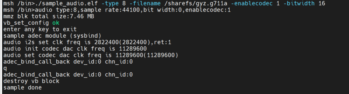

2.5.4.2.9 Decoding Test#
Read file data and decode it for playback. Encoding and decoding only support g711a/u, 16bit.
System binding method: ./sample_audio.elf -type 8 -filename /sharefs/gyz.g711a -enablecodec 1 -bitwidth 16
API interface method: ./sample_audio.elf -type 10 -filename /sharefs/gyz.g711a -enablecodec 1 -bitwidth 16
2.5.4.2.10 Full Audio Process Test#
Recording module ai->aenc->file and playback module file->adec->ao two paths run simultaneously, simulating a voice intercom scenario. Use the built-in codec with 16bit precision for simulation. Use
-filenameto choose the file to be played, in g711a format, and-samplerateto choose the sampling precision. The recording file name is the playback file name followed by_rec: for example, if-filenameis/sharefs/test.g711a, the recording file name will be/sharefs/test.g711a_rec.
ai->aenc, adec->ao two paths binding loopback test. Use the built-in codec with 16bit precision for simulation.
Simultaneously test the timestamp of the stream after g711 encoding.
Input cat /proc/umap/sysbind to view the system binding between modules.

-enablecodecoption to use the built-in codec or external audio sub-board, with the built-in codec used by default.Use the

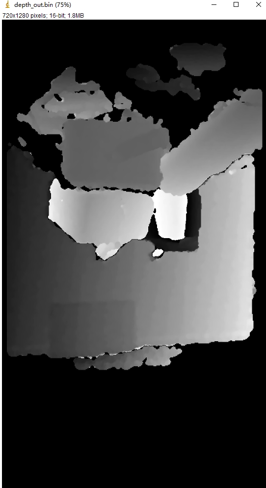

2.8 DPU_demo#
2.8.1 Introduction to dpu_demo#
2.8.1.1 Non-binding Mode#
Parses parameters from the configuration file and configures the DPU’s device and channel attributes, reads and configures reference and template images from the specified path, loops input of infrared and speckle images, obtains results and checks if the calculations are correct.
2.8.1.2 Binding Mode#
Parses parameters from the configuration file and configures the DPU’s device and channel attributes, reads and configures reference and template images from the specified path, binds the pipeline using VVI as the simulated front-end, inputs infrared and speckle images, DPU calculates the results, user space obtains the results and saves the depth map as a file (the depth map can be opened with appropriate software), press q to exit the program.
2.8.2 Feature Description#
Includes configuration file parsing, device and channel attribute configuration, device and channel start and stop, user space input data, output results, release results, and pipeline binding input and output.
2.8.3 Dependency Resources#
None
2.8.4 Usage Instructions#
2.8.4.1 Compilation#
Refer to the README.md in the SDK for the software compilation environment. Since this module requires dependent files, the following steps need to be performed during compilation:
2.8.4.2 Execution#
The configuration files and input/output golden data required for the demo are stored in the
k230_sdk/test_resource/dpudirectory. To facilitate use, you can copy the entiredpufolder to the/sharefs/directory (refer to the corresponding documentation for the use ofsharefs). After copying, the/sharefs/dpu/directory will exist in the large core.Copy
k230_sdk/src/big/mpp/userapps/sample/elf/sample_dpu.elfto the/sharefs/directory.Non-binding mode demo run
/sharefs/sample_dpu.elf /sharefs/dpu/Test information will be displayed on the screen, and the run will end after 10 frames. In the above command, the parameter
/sharefs/dpu/can be set according to the actual path where the user’s configuration files are stored.Binding mode demo run
/sharefs/sample_dpu.elf /sharefs/dpu/ BOUNDTest information will be displayed on the screen, input q to end the run. In the above command, the parameter

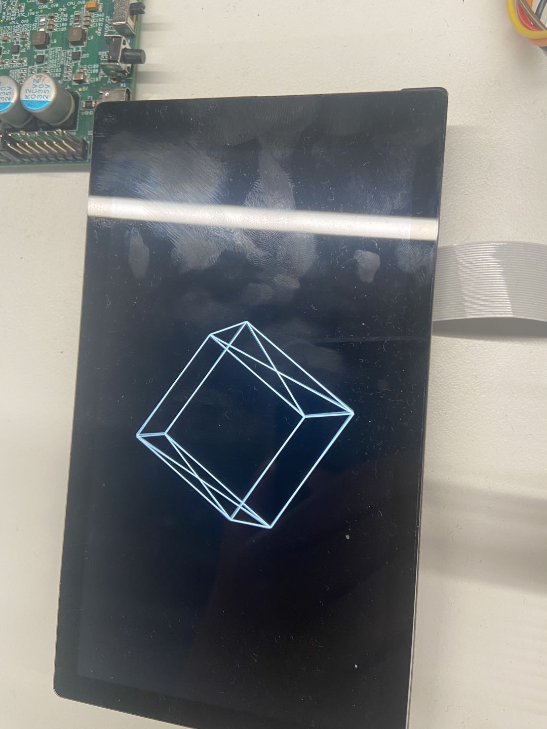

2.11.4.5 vglite_cube#
Run the vglite_cube command. The GPU will display a rotating cube on the LCD screen, as shown below:
During the demo run, the kernel will print a lot of messages. If you do not want to display these messages, you can reduce the kernel print level:

2.12 DRM Display Demo#
2.12.1 Introduction to the Demo#
This demo runs on the Linux system of the K230 small core and displays images on the screen.
2.12.2 Feature Description#
DRM supports operations on 5 layers, including 1 video layer and 4 OSD layers.
The video layer supports NV12, NV21, NV16, NV61 color spaces.
The OSD layer supports ARGB8888, ARGB4444, RGB888, RGB565 color spaces.
2.12.3 Dependency Resources#
LCD screen.

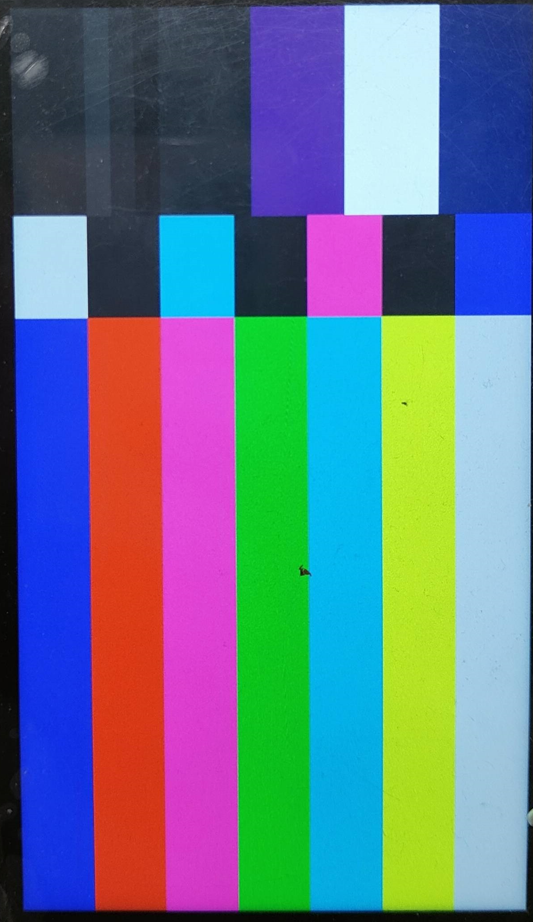

2.12.4 Usage Instructions#
2.12.4.1 Compilation#
2.12.4.2 Execution#
After executing the above command, a color bar will be displayed on the LCD screen, as shown below:

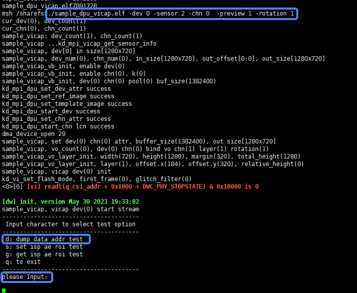

Mount NFS using the following commands:
ifconfig eth0 up udhcpc # Replace the IP address and path below with your server's IP and path mount -t nfs 10.10.1.94:/home/user/nfs /sharefs -o nolock
After mounting successfully, the
/sharefsdirectory can be seen on both the large and small cores. Copy the compiled demosample_dpu_vicap.elfto the server’s NFS directory (here it is/home/user/nfs). At this point, the corresponding elf file can also be seen in the large core RTT’s/sharefs.Use the command

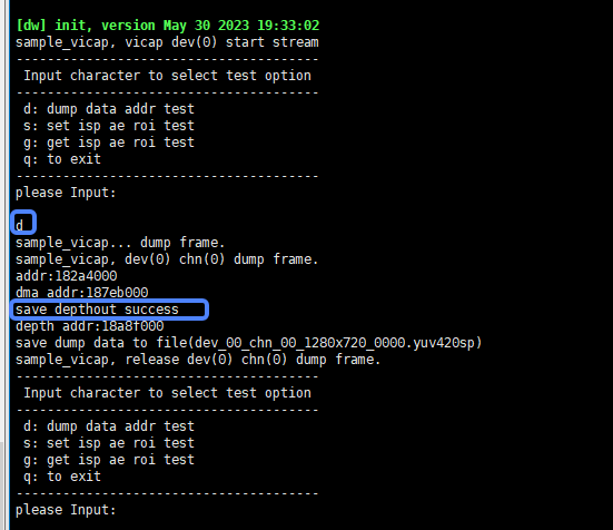

./sample_dpu_vicap.elf -dev 0 -sensor 2 -chn 0 -preview 1 -rotation 1to start the demo. The output print information is as follows:
Input
d, the output print information is as follows:
Input
qto exit the program.At this point, the
depth_out.binfile is in the/sharefsdirectory. This file is the depth image file output by DPU, which can be opened and viewed using appropriate software.

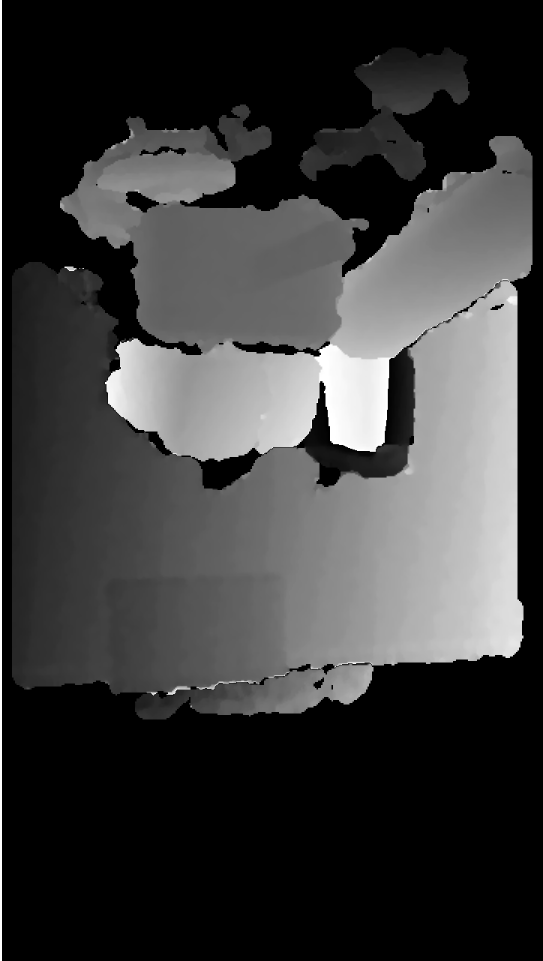

2.16.4.3 Results#

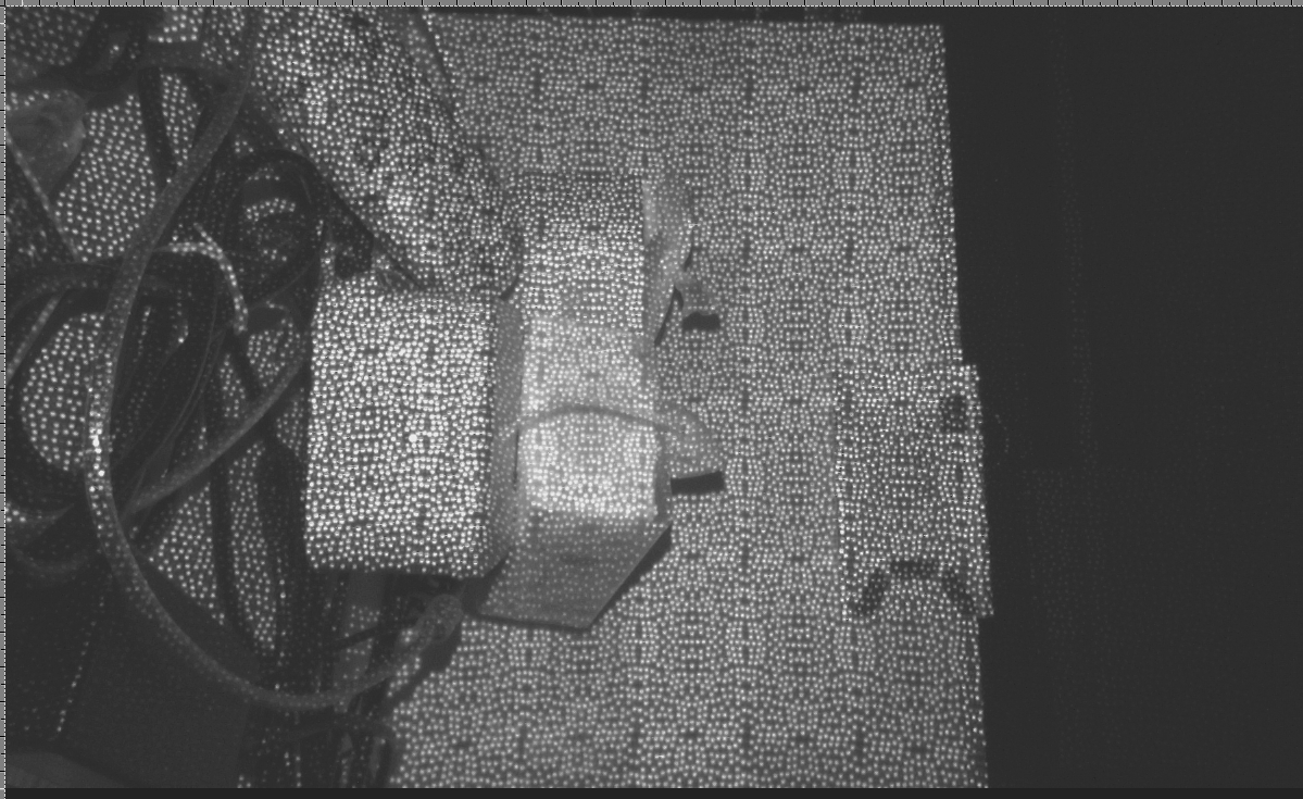

The actual scene is as follows:
The speckle image captured by the sensor is as follows:
The speckle image rotated 90 degrees clockwise by DMA is as follows:
The depth image result output by DPU is as follows:
